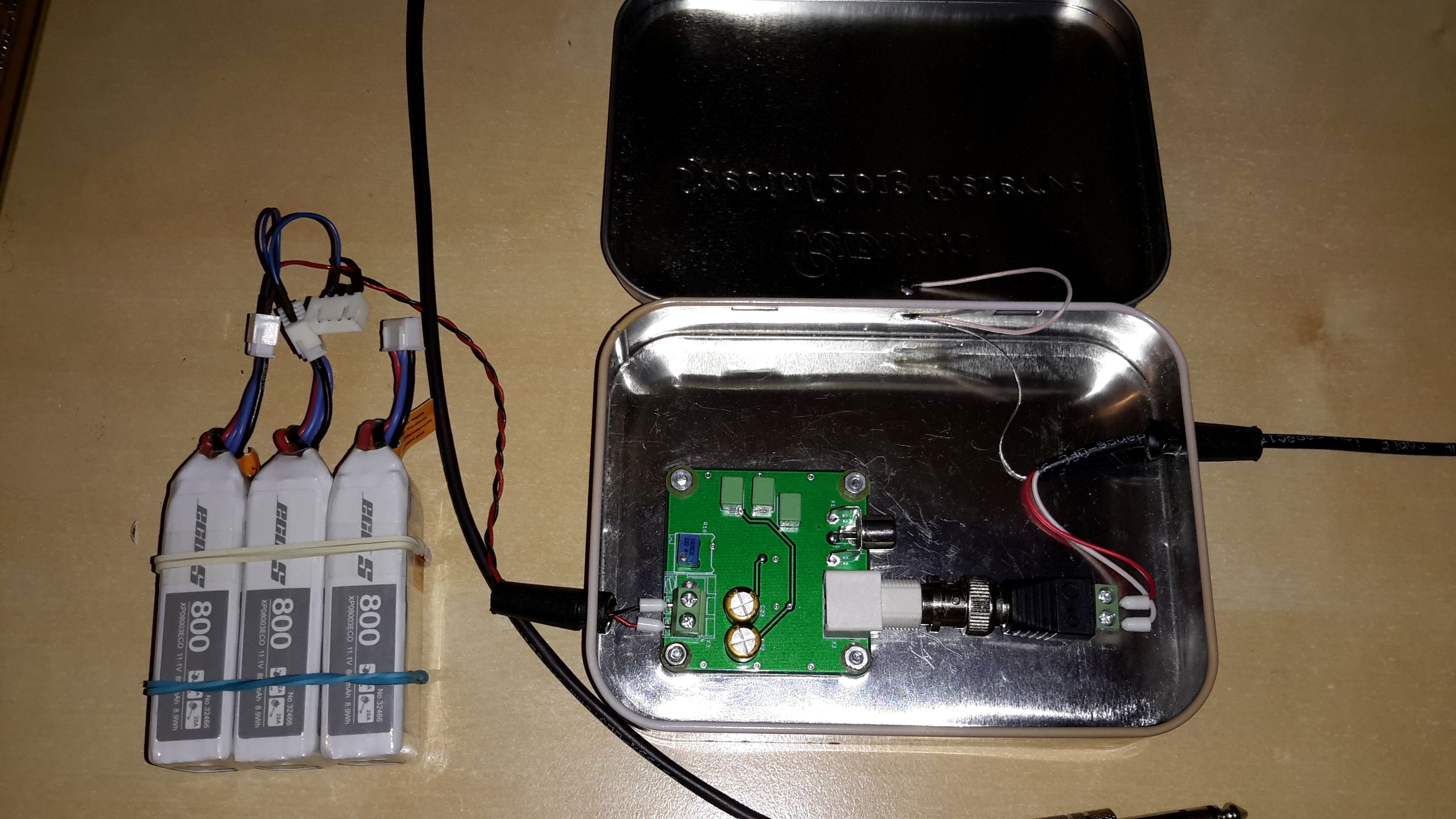

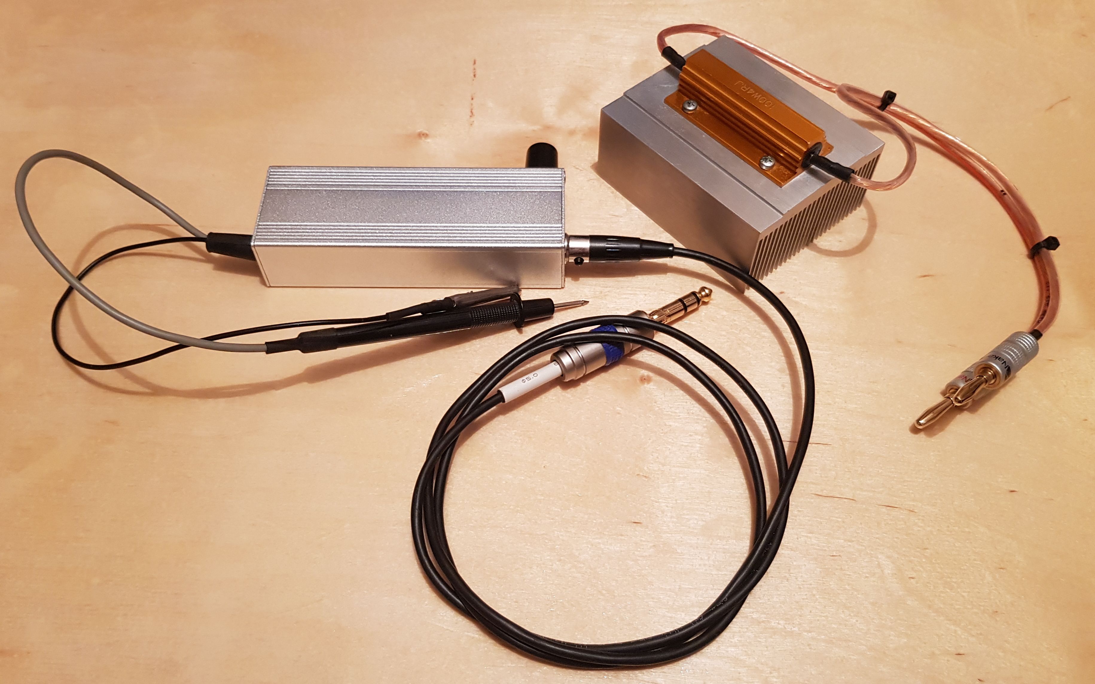

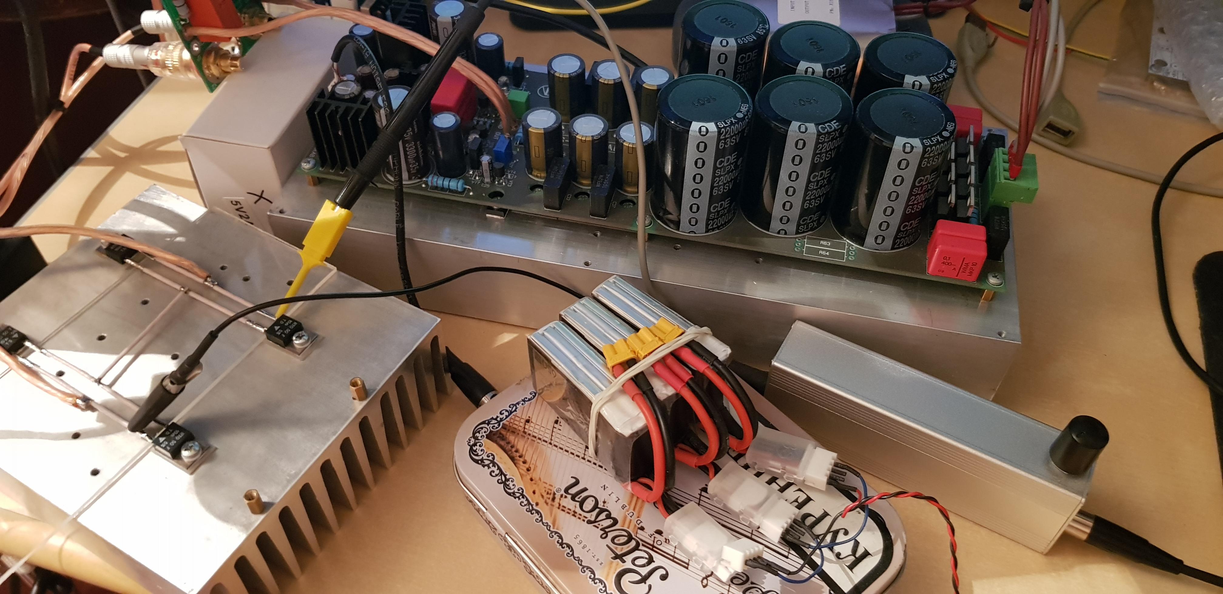

Hi! My setup for measuring Power Amplifier THD 1. Load (4 Vishay Metal Film resistors) 2. Generator with battery 3. Relay attenuator with 1dB step 4. SC Asus Xonar Essense STX II

Side note, those 10ohm metal film resistor in TO220 (Vishay or whatever) are making quite a poor load... Metal film resistors, even the "power" ones, have very limited current and dI/dt capabilities. That is, they won't survive any high current pulse and can easily be destroyed by a transient at full power. They make pretty efficient fuses, which could be sometimes viewed, in certain applications, as a feature, but not as high power loads in audio. Really, for audio, there's no good substitute for wire wound resistors, ideally anti-inductive.
Correct- the film and related won't survive. I have the smoking ruins to prove it.
The Caddock and Vishay resistors just turn into fuses. The cheap ($2) china wirewound resistors 50W/100W 0.01-50 Ohm Shell Power Aluminum Housed Case Wirewound Resistor New | eBay measure very resistive to 100KHz, better than 2' of zip cord. And you have a heat sink already. Keep the wiring close as pairs as much as possible. The large "windows" will be the dominant inductance in your jig.

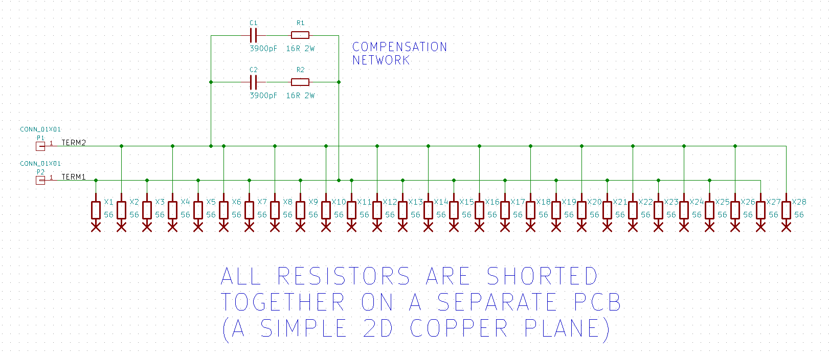

You can remove a lot of inductance using a simple compensator
Building my own noninductive 8R 150W load using wire wound resistors

This is the first time I have applied such a load. I won't explain why, but it won't do at all

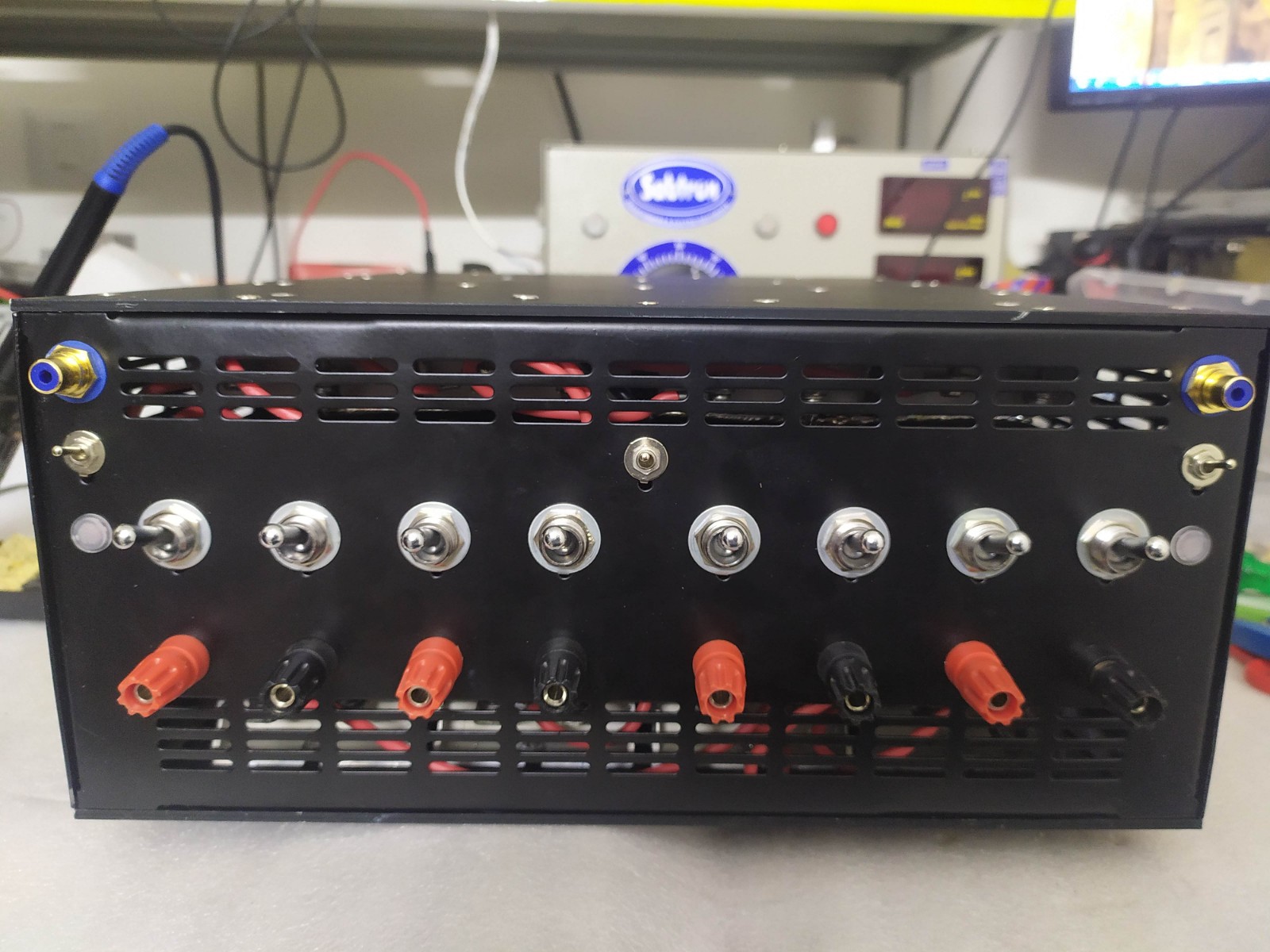

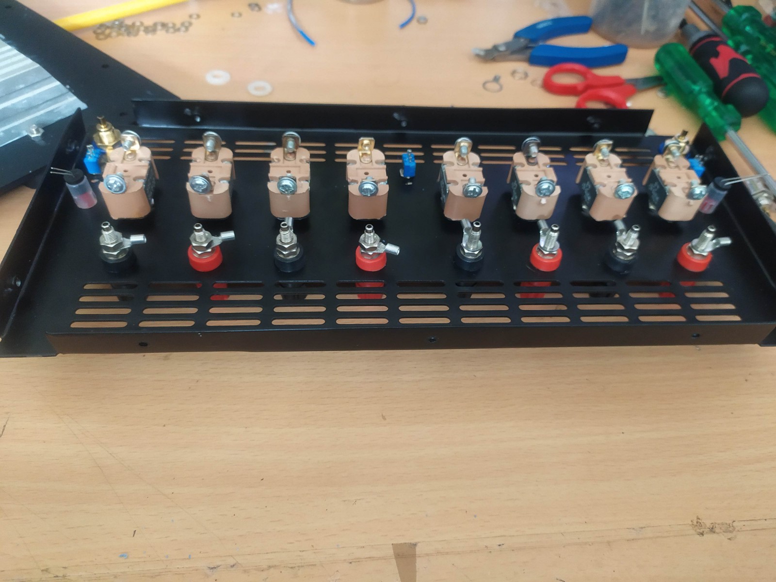

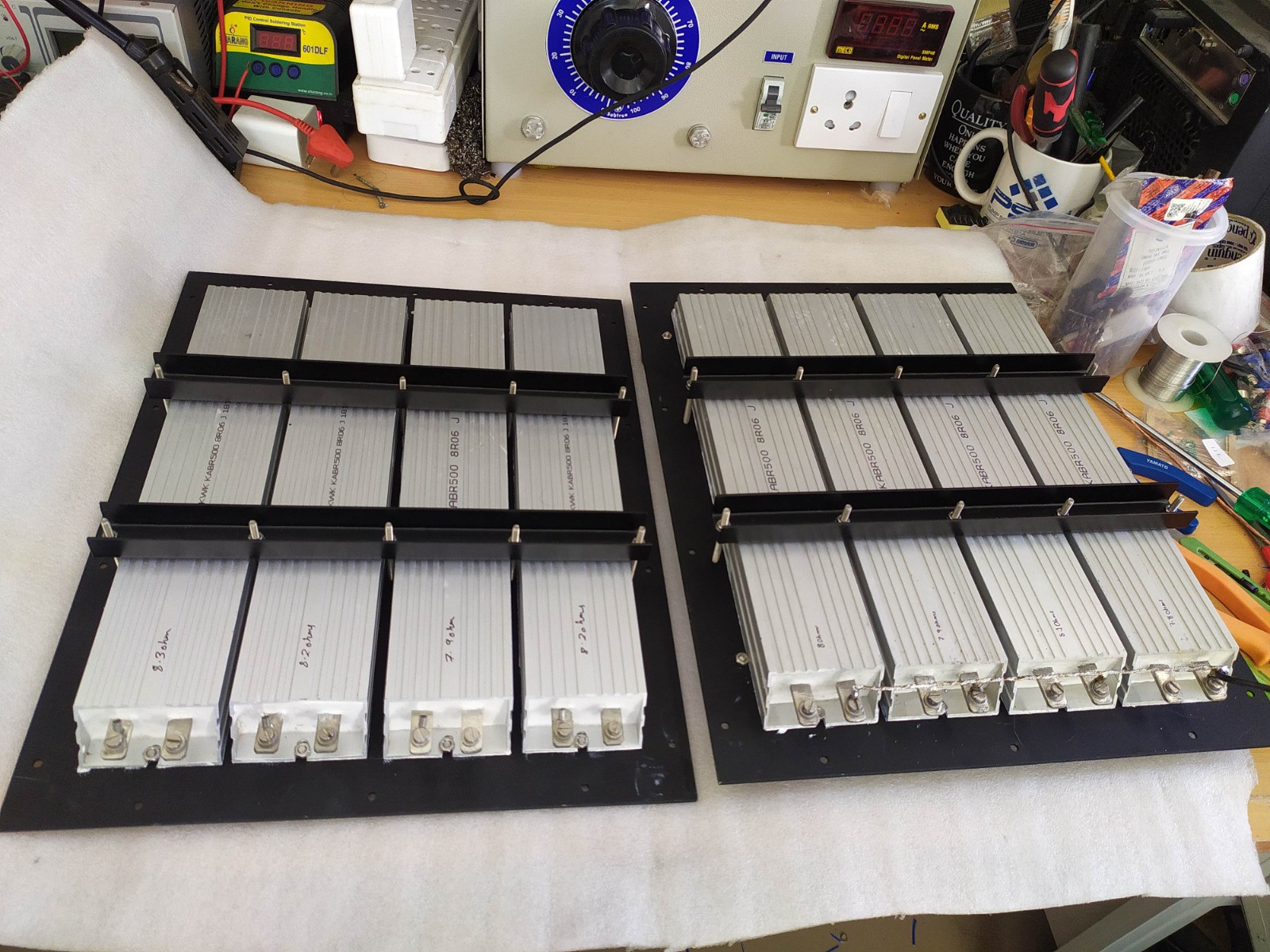

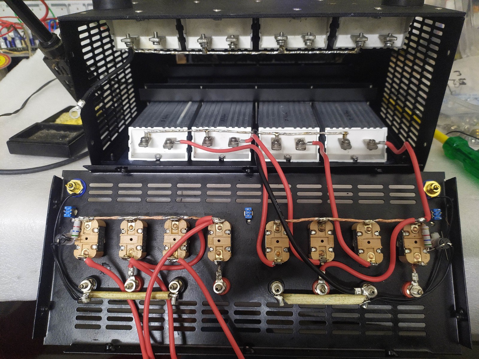

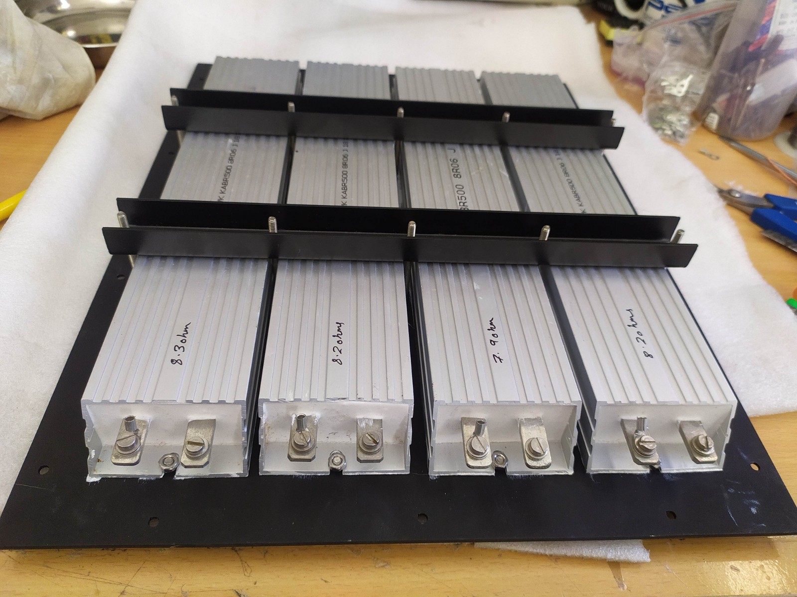

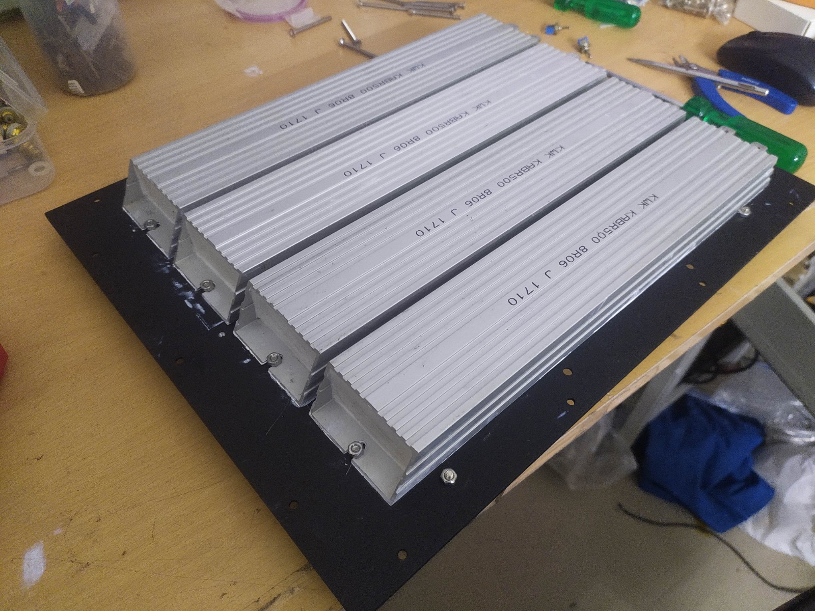

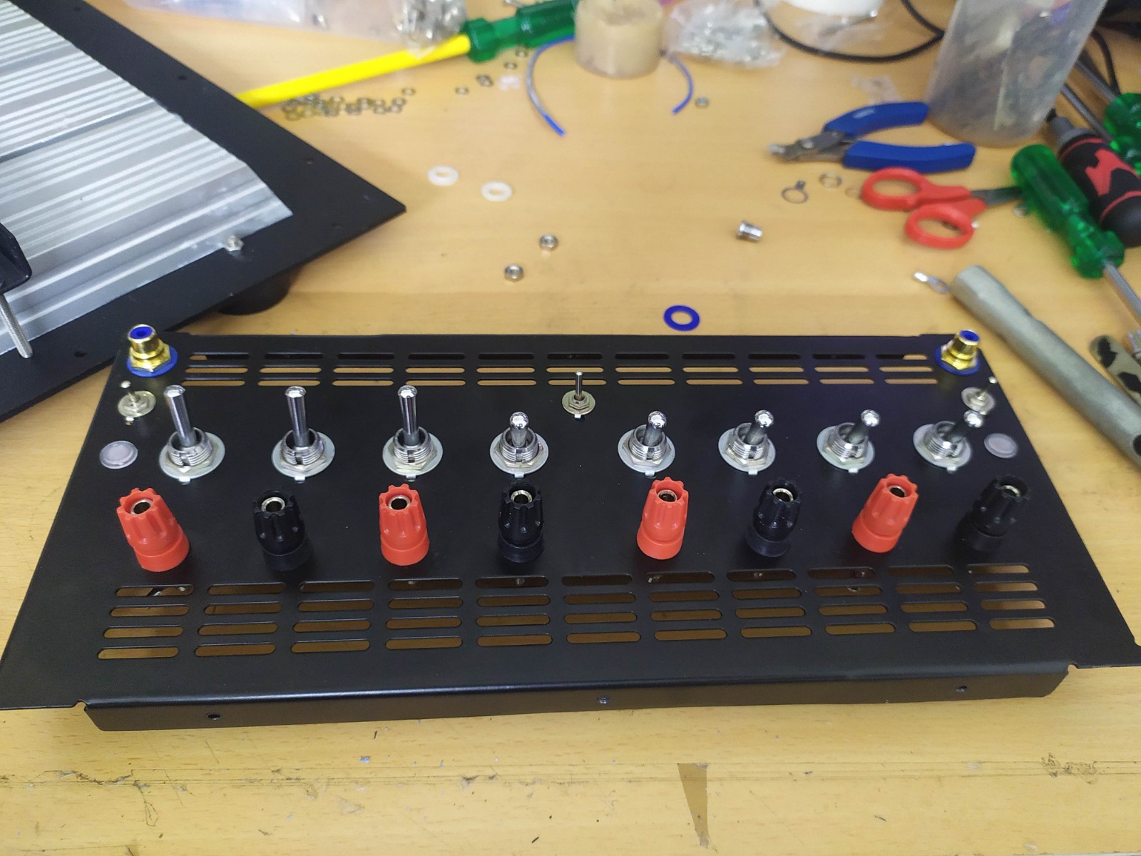

Hi have made a dual channel dummy load for my amp testing , its made from 500W wire wound resistors in an aluminum shell which is in turn connected to 400X300mmX3 mm aluminium sheet. It can be switched for 8ohms , 4ohms , 2.66ohms and 2ohms. I have also kept 10X & 100X attenuation out put to be used with sound cards.
I have tested upto 400W amps for continuously 4 hrs they do get hot but after turning on the 2X120mm - 200CFM fans the heat is manageable.
for 10x & 100X attenuation i Have bought vishay 100K,10K & 1K 1% low TCR resistors
Regards
Regards
