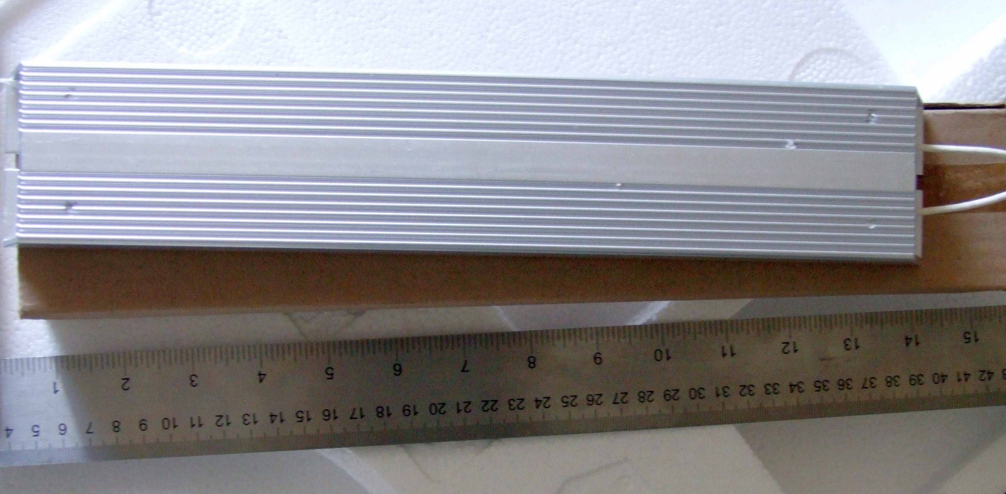

glad to come back after a long interruption. I start with a smooth project. I have 4x 8ohm non inductive resistances. It gives me idea of an audio dummy load with wattmeter, something like sencore PA81.
For dummy load part, I think of
  • 4 to 8 ohm switch with extra contacts for correct display value
  • thermal switch for fan
  • DC protection warning
  • BNC output
for wattmeter I think of something around AD637.
advices are welcome and if something exist, I don't want to reinvent wheel

yes, it's audio watt meter inspired from sencore PA81 audio analyzer.
Switching power resistors is the first problem to resolve: Mecanical, relay,... ?
with 4 x 8R resistors I would like to get
-stereo 8 ohm 500W
-stereo 4 ohm 1000W
-mono 8 ohm 2000W
