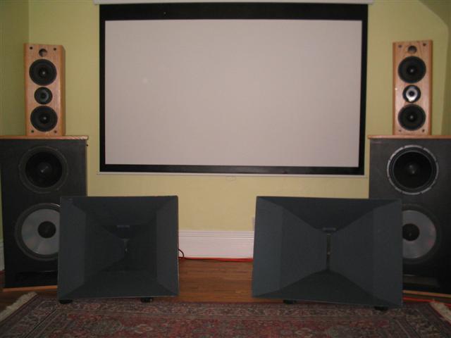

Here's a pic of how it's setup. Yes the horns don't match... one is a MR64 and the other is a MR94. I think the WAF will dictate selling off the MR horns and getting something a little more domesticated.
The SUB's are VMPS larger subs and are doing duties below 460hz.
