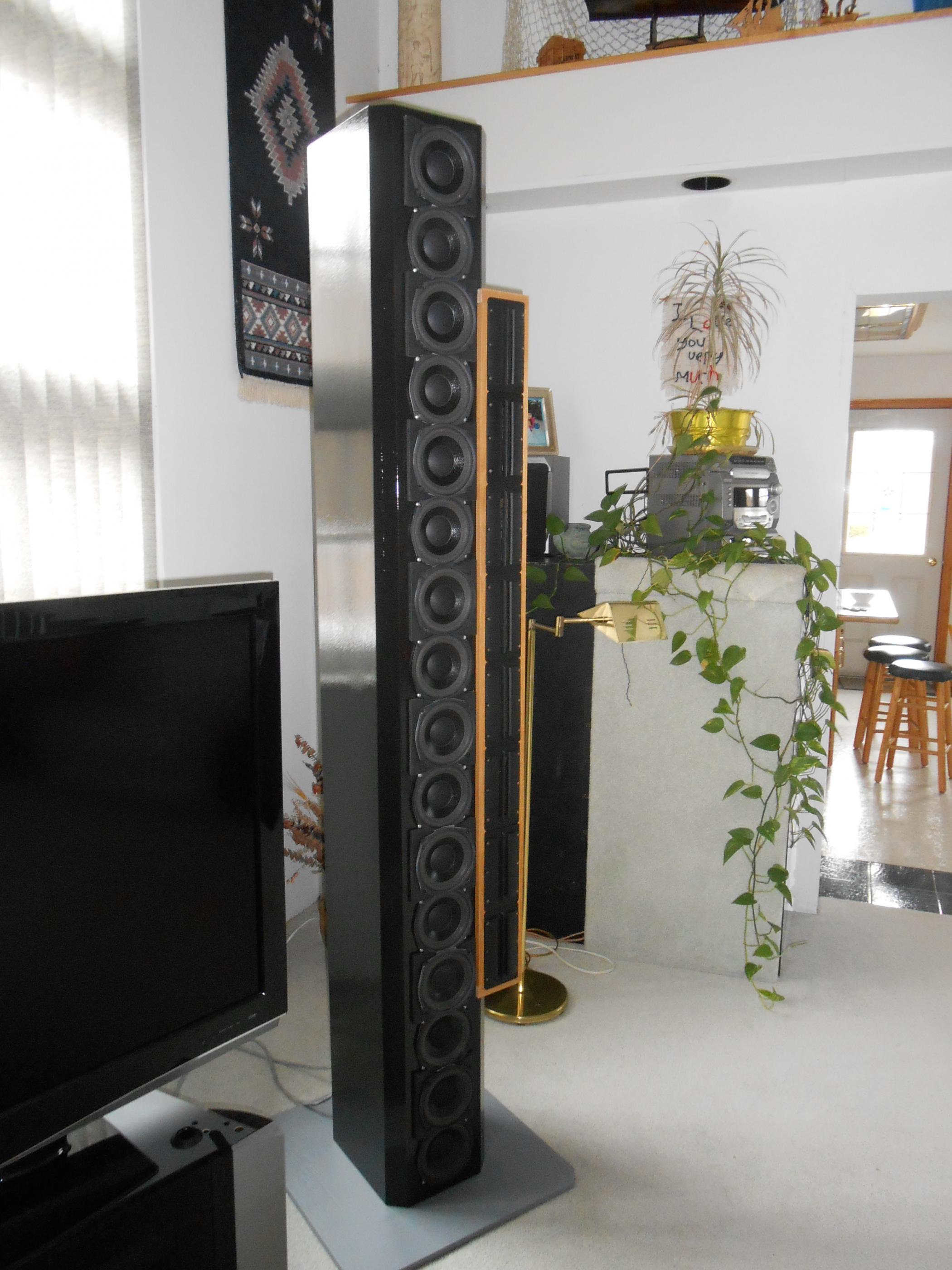

I have not considered listening to the laptop line out because the REW sound card cal test showed a severe roll off below 60 Hz. My system is 3 way electronically crossed over, so a headphone jack is not readily available.
I have however gone to some effort to build an accurate line array system. The mid-range line array is 84" tall with 16 5-1/4" drivers.

Those are some fancy speakers. The reason I suggested using headphones or computer line out is to find out whether it is still tinny, which would suggest a problem with the file, or is OK, which would mean the DAC is the problem.
The headphone jack I meant would be on the DAC.
