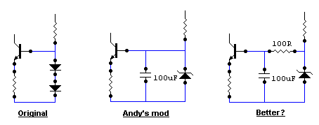

Hi Tim
Re the voltage references - I think the difference is trivial. Since Andy's roughly doubling the original voltage and the parts he specifies are only accurate to +-1.5% anyway, I don't think +2% will make any difference.

I presume the opamps are running off +-15V supplies so a rating of anything over about 30V should be fine for the polystyrene caps.
The 2.2uF polypropylene caps shouldn't have much (if any) voltage across them so probably any rating will do. If you find higher value caps at a sensible price, that wouldn't hurt. OTOH, smaller isn't a disaster either. They help define the low-frequency roll-off (bigger is better). Note that Andy deliberately reduced the value (but increased the quality) to sacrifice a bit of low-end bass extension in exchange for (hopefully) better sound quality.
The 100uF electrolytics are another kettle of fish. Frankly, I don't know why Andy bothered since the impedance of the voltage regulators is likely below the impedance of the caps throughout the audio band so the caps won't do anything useful anyway.
However... let's go with the flow:
They'll have about 2.5 volts across them (if used) so the voltage rating doesn't really matter. However, if they're to do anything useful, they need to be low-ESR (equivalent series resistance) types. The exact value actually isn't important - High capacitance is good and low ESR is good. If you're comparing datasheets for caps, look for ones with low-esr or low impedance (at whatever frequency is specified). A few rules of thumb:

Regarding the 100uF capacitors:
They're supposed to be reducing what little noise there is from the voltage reference. Using a capacitor and a resistor (as in the third pic below) would make a nice filter and reduce the noise substantially.
Just the cap on it's own isn't going to have much effect because then the filter is made of only the cap and the "built-in" resistance of the voltage reference, which is something less than one ohm.
For filters like that, bigger is better for the cap and the resistor. e.g. Increasing that 100R resistor to 1K would likely be a big improvement. You can't go too high though or it'll start affecting the regulation.
One problem with adding parts is it gets messy when they don't fit on the PCB.
