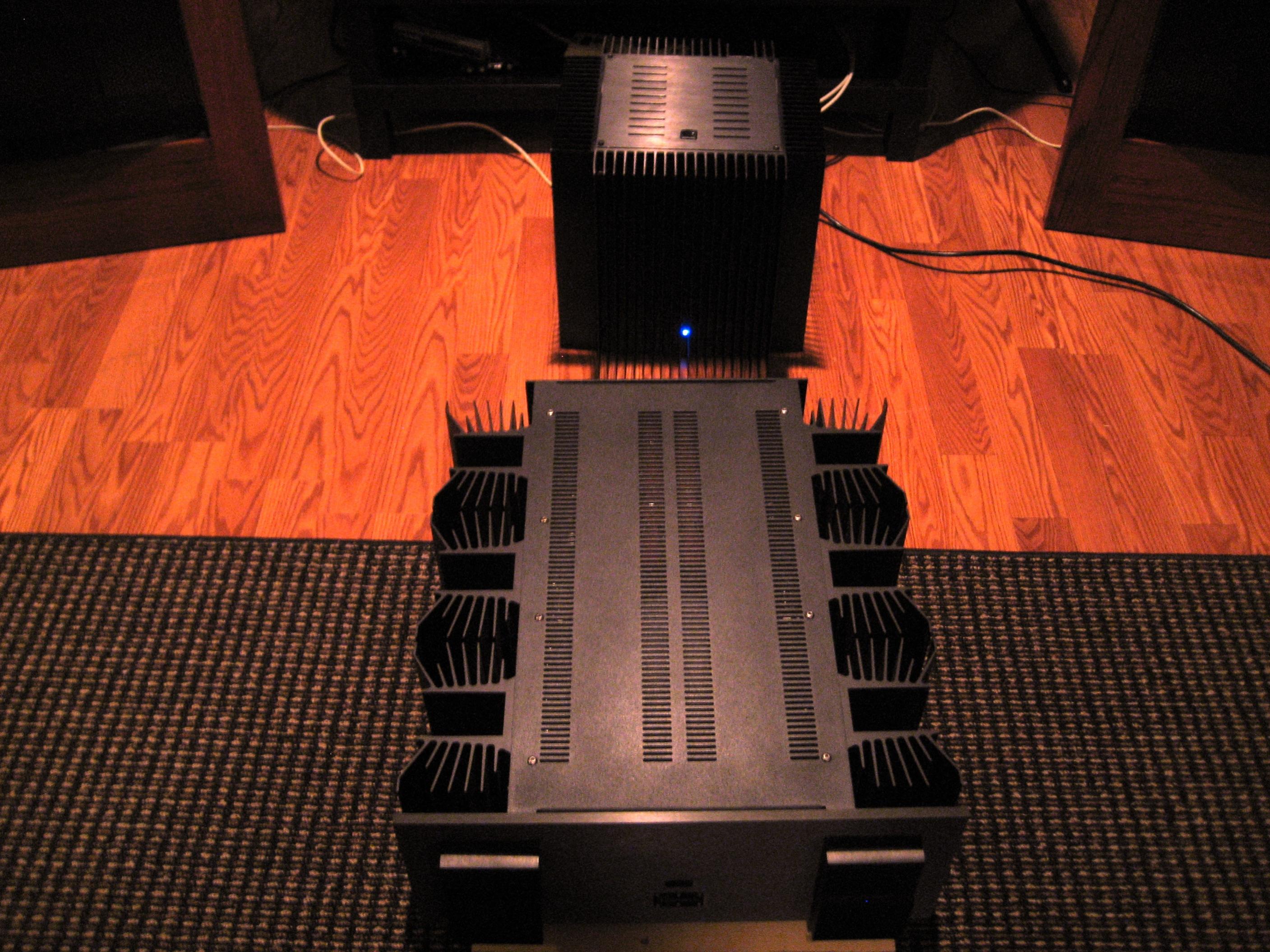

OK, I checked again and the KSA-50 Clone I built is actually drawing 5.25A (inline meter indicating 500 watts / 630VA) not 7 A...still seems odd that the KSA-250 only drawing 7A???
A pic of the two....I have to say the Clone sounds a bit clearer / focused than the KSA-250....

The 8 amps from the wall is NOT the same as the actual bias on the amps... it's related and maybe even close, but that is not certain depending on details of the power supply and how much current it takes to keep the cap bank charged.
8 amps for the KSA-250 seems about right. But you can likely find the spec online, or in an early review (Stereophile?).
