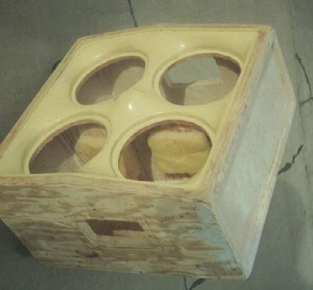

edge round-overs
When doing round-overs on the cabinet edges, keep in mind that what is round is very dependent on the frequency in question. A 1/2" roundover does little more than add cosmetics and help avoid cuts and bruises from the sharp corners. To get really effective down into the upper midrange they need to be fairly large, 2, 3, even 4" radius. Baffle surface treatments and careful positioning of the drivers can make a big difference wrt edge diffraction issues.
dave
dave

Hi electricashman,
Nice looking box. Reminds me of the Bose PA speakers that were everywhere about 10 years ago. You should get good dispersion from this but it's not what I had in mind. I was thinking of removing the sharp edges from the corners of the box.
Yep. I'm with planet10 on this one. The larger the radius of curvature you can build into the corner the better, without going over to a cylindrical enclosure. There's a thread in this forum, probably in the loudspeaker section, by somebody who did a thesis on diffraction effects. The work was basically a rehash of work published in the 1950s that has been subsequently published in a couple of texts. I don't have them to hand right now so I can't say which off the top of my head.
Basically, to minimise the diffraction effects, put a large chamfer on the conrners of a rectangular box that has sides (l x w x h) that are not integer multiples of each other and then place the driver asymmetrically in the front of the box.
