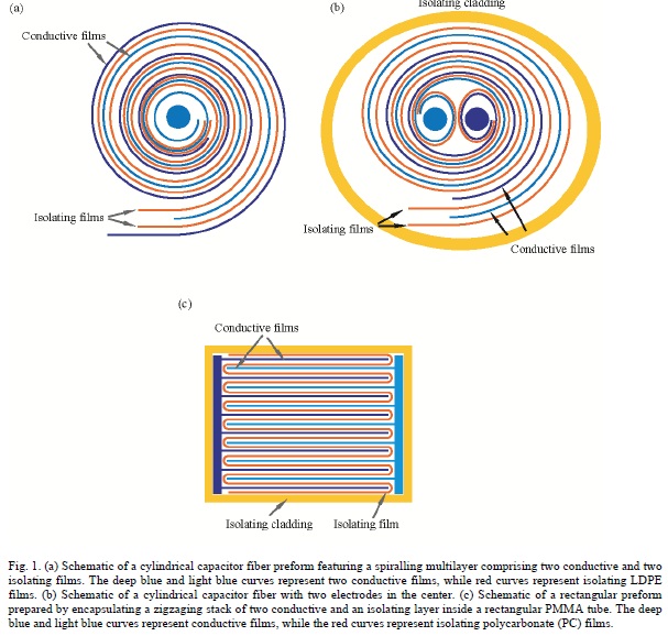

Neglecting edge effects, we can obtain a reasonable approximation to the value of capacitance C.
For two parallel plane plates of area A separated by a distance d, filled with a dielectric medium of dielectric constant ε, from Maxwell's equations
∇.D = 4πρ
D = ε E
Integrating in a volume V
∫∇.D dV = ∮D.ds = D A = ε E A = ∫4πρ dV = 4πQ
Then
E = (4πQ) / (ε A)
Also
E = - ∇φ = dφ/dx
Integrating
Δφ = ∫dφ = E ∫dx = E d
By definition
C = Q/Δφ
Then
C = (ε A) / (4πd)

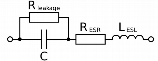

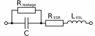

In a real capacitor, influence both, dielectric and geometry.
However, R leakage depends strongly on dielectric, and ESL on geometry.
That is why a vulgar multifoil chip capacitor, MKT or MKP, can minimize ESL and ESR.
