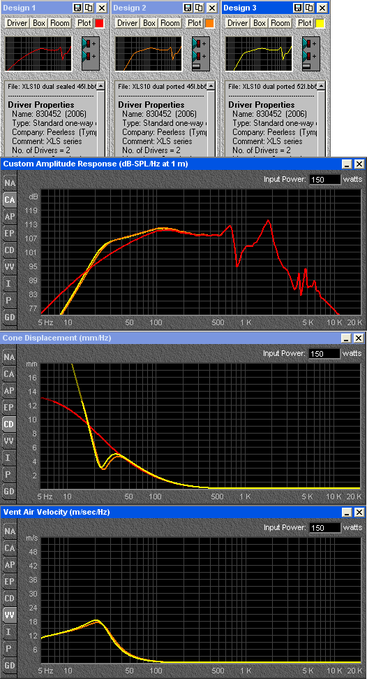

I have a set of four Peerless XLS10 4 Ohm (830452) drivers. I've been running a pair in a 40 litre (1.4 cu ft) sealed enclosure. The drivers are mounted on opposing faces of the box, wired in series to create an 8 Ohm load, and have been run off an Alesis RA500 amp (in bridged mode - claimed to deliver 500w into 8 Ohm). I'm quite happy with the amp dialled to around 50% volume (it measures level with an SPL meter with respect to my other speakers).
I'd like to make use of the other two drivers, and create a pair of subs for better room response.
I'm very tempted to look into ported enclosures, accepting that the XLS10 does appear to need large ports.
A quick design in BassBox Pro indicates 40 litres sealed, or 52 litres (1.8 cu ft) ported. Reducing the ported design to 45 litres (1.6 cu ft) doesn't appear to make a huge difference to the response, but still gives a reasonable SPL boost over the sealed enclosure (see attached image).
My initial plan was to run the RA500 amp in stereo mode (claimed 150w per channel into 8 Ohm in this configuration). I know this is less power than desirable, but as I run the amp pretty low now I'm hoping this will be sufficient.
Working on the assumption of 150w, the 45l ported enclosure hits the drivers' excursion limit at 14.8Hz. A sealed 45l enclosure looks safe (excursion limit hit at 7Hz, but only runs 0.5mm over at 5Hz).
Vent air velocity looks acceptable, at a max of 17.4m/s at 22Hz.
With this design, it looks like room constraints are going to force me into having both drivers on one face of a 50x50x35cm enclosure (20x20x14").

Hi Gordon, good to see you again.
What port frequency are you using? Those drivers need porting really to get the most from them (they were designed to be used with the passive radiator).
Mounting the drivers like you had is great, but you should be fine with them both on the same face.
I think you will be OK for amp power. If it turns out not then just get another RA500 and run one per side. (Don't think that amp is rated for 4 ohm in bridge?)

If you have two subs that are sealed and drive them at 150 watts each, it will give you 1dB more output than one sub at 500 watts. Just for entertainment, say your one sub at 500 watts produces 110dB. Two subs at 150 watts is 105dB but you gain +6dB by having two of them for 111 dB.
Is it worth it? Sure! You already have them and with four drivers instead of two, throw in power reduction to produce the same SPL, you'll have a cleaner sound with less distortion. That massive 1dB jump in output won't matter to your ears much but the amp will generate less heat for the same power output with the pair of subs.
In reality, your gain will be higher than 1dB, subs when driven to their limits have power compression so assume at least another dB there. Basically, you are up 2dB with two boxes running at 300 watts.
If it is maximum output you want, ported would work for another boost and since Xmax won't be exceeded down to sonic boom levels--it should give you around a +5dB boost in total output. Other factors such as how the room works with 2 subs VS 1 sub, how far you sit from the sub etc also can see a perceived increase in output.
You can build one with the ported dimensions and listen to it to hear if you like the results. If not, seal it up and add material to get it to match the interior volume of your other sub. Can't have too many cross braces, right?
I built my sub to be ported and tried sealed first--it rolled off too high so I threw a passive radiator on it, tuned in place to be smooth and pressed on. If you have the space, I would build it as a ported box since it is easy to put things inside to make the box air space smaller for sealed use. You can "tune" the sealed box with extra braces to take up space that way. It allows the option to switch to ported easily so go for it. Always nice to have an option.
Try the amp in phase and out of phase by reversing the leads--go with the configuration that offers the most output. Since I have a habit of stuffing my boxes, my sub has a layer of material on the side walls--does it matter? I had it laying around and it can't hurt. If you really stuff a box, it will change the tuning which can be done to taste.
Having more output, less distortion while using less power is always a good thing in my book.

What size port are you looking to get 17.4m/s through? 6" (15.23cm) i hope, 4" (10.16cm) has a 13m/s chuff limit.

I think a 100mm round port is too small, especially if quality is your goal. Rather than soil pipe which you might find difficult to accomodate that length in your cabinet, have a look at slot port. I'm sure with your setup this would not be a problem to make. The port can wind round a bit like a kind of mini transmission line.
If you have access to OpenOffice look on my website on the utilities page as I have a port calculation spreadsheet which will do slot ports. It would be up to you to work out the bends though. Try starting with a 30mm slot height.

OK... so a 102mm diameter port (791mm long) gives me 16.7m/s at 20Hz. A 115x115mm square vent (~=130mm diameter port) is 1300mm long. That would be OK I guess (assuming 50cmx50cm front: running up one side, across the top, and ~30cm down the other side). That takes us down to 10.3m/s at 20Hz, which might be OK. I can certainly round the edges of the vent ends over.
The only downside: Assuming I made the vent from 6mm MDF (quite probably too thin as it might flex inside the box) it would take nearly 21 litres!
