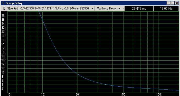

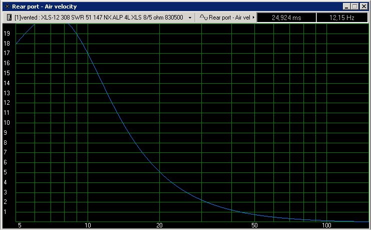

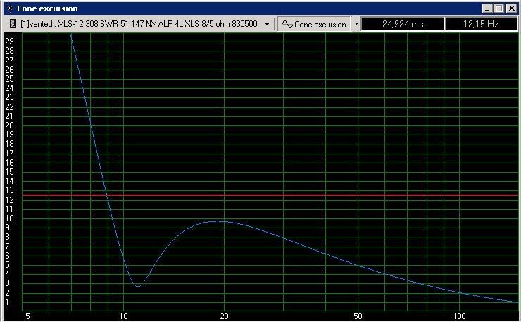

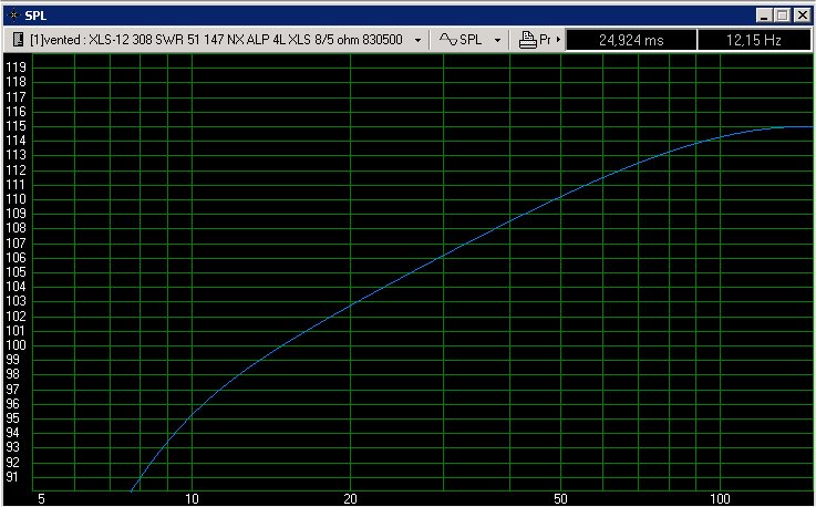

Design:
2x Peerless XLS 12
Box 110L netto, small amount of fill, tuning frequency 11Hz
1x tube 11,1cm inner size, 209,4cm length
1x 240W NAD214 amp
Pro's:
good output <20Hz
1st port resonance 82Hz
cone excursion limit only reached below 9Hz with 240W
low group delay 25ms at 12Hz
Air velocity in tube 17m/s at 240W at 10Hz
Reasonable box size.
I'll post the screens from winisd.
Any thoughts about this design? Did I miss something?
Sjoerd
SPL 240W

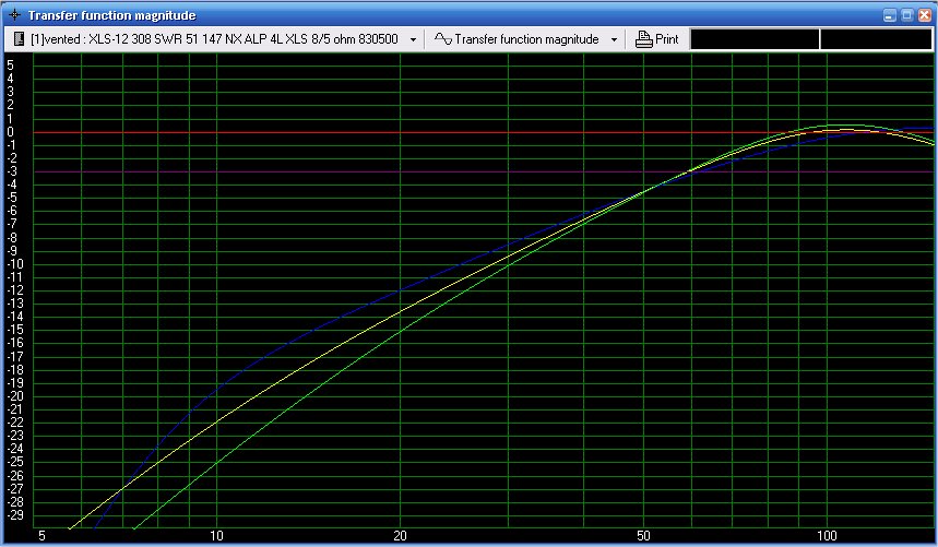

BassAwdyO said:
looks like a great box to me.... except your rolloff is a bit steep. A bigger box would help with that, but it also lowers the dampening on the cone which will increase excursion at lower power levels.
The rolloff is not so steep in my opinion (look at the scale; 5-150Hz)
For comparison take a look at the attachment
Green is the design by Linkwitz (www.Linkwitzlab.com)
Yellow is the sub I own at this moment
Blue is the new design
I'd say virtually what you have there is a sealed box with an extra few Db from 11-13hz or something. I like it. It should sound very musical indeed.
I like sealed subs. So my idea was to create a sealed sub, but with some extra output from a port for the part where the system would run out of steam.
By placing the port it prevents the cone from reaching it's max excursion at ~16Hz instead it's at 9Hz with 240W.
