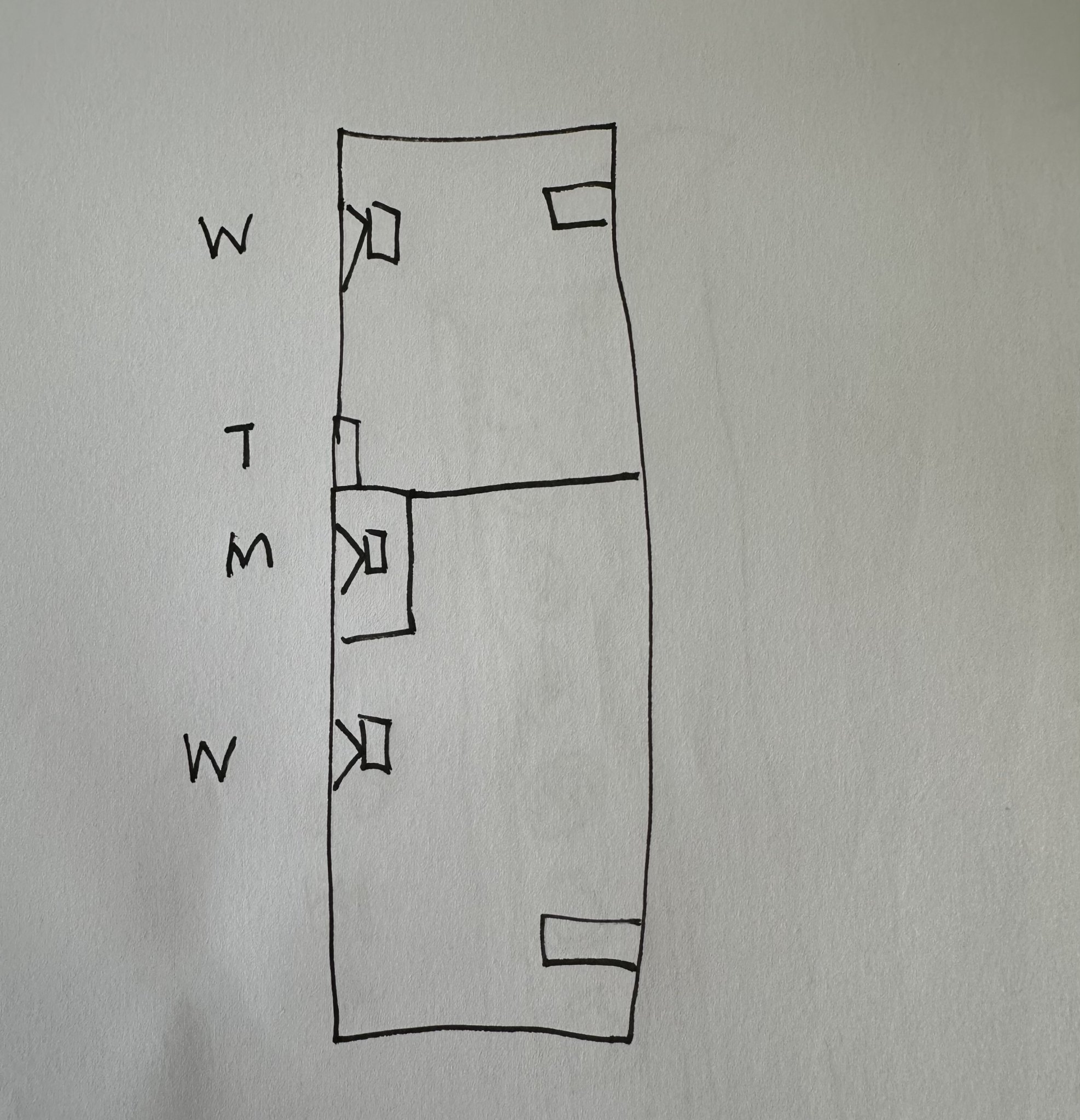

They may not combine with as much output as expected, due to differing phase.
The way to be sure would be to put both the responses in a simulator as separate woofers and play them in parallel.
Then you try designing a box for the pair that is the same for both, and see if it's necessary to use separate boxes or tunings.
I know it can work for sealed boxes with different Qtc [ I think it was with a 3.5 speaker a mate built] but never ever thought of trying with a ported box, too many variables for this little wood duck

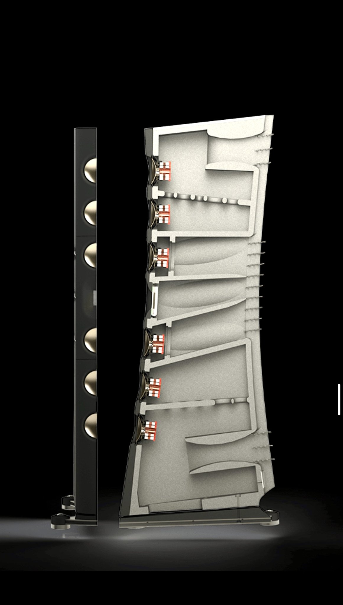

I ask the question because i can see that Børresen is doing something like this in their new 3 way speaker. I listened to it this weekend. 1,9M EUR for the system 🙄
Are they different tunings for sure?
If the boxes are different volumes maybe the tuning could be the same
The 2 upper, and 2 bottom 'woofers' shares the same volume for 2.I ask the question because i can see that Børresen is doing something like this in their new 3 way speaker. I listened to it this weekend. 1,9M EUR for the system 🙄
The 2 'mids' each have a identical ported enclosure both.
So a large 3/3.5 way. With 2 sets of ported woofers. Possible the lower one is slightly larger and lower tuned ?
Rolling it off before the upper pair or something similar.
Fully possible to do but not really much benefit to it, and plenty of headaches to solve.
The smaller volume upper chamber uses a shorter, wider port than the lower larger chamber, so definitely has a higher Fb (Frequency of Box tuning) if the cutaway diagram you posted is accurate.I ask the question because i can see that Børresen is doing something like this in their new 3 way speaker. I listened to it this weekend. 1,9M EUR for the system 🙄
If the Fb output of each is within 1/4 wavelength (90 degrees) they sum still constructively.
That said, the speakers appear to be multi-way, considering the higher Fb of the upper cabinet would benefit from a higher frequency high pass, for 1.9M EUR, I'd expect DSP would be compensating for any time/phase differences 😉

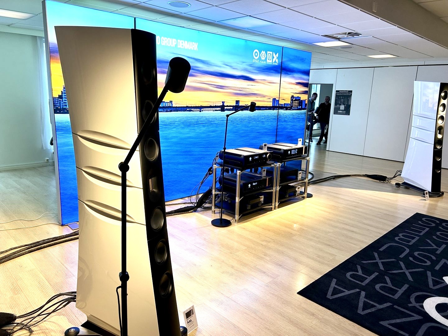

What did you think of the speaker's sound?
It sounded nice and with good fundament in the bass. The level from theese 4,5 inch drivers was stunning. They played loud as from a huge three way with 12-15 inch woofers??? The bass was a little «one note» compared to my more articulated and efforteless Acoustic Elegance TD18H+ subwoofers which i use from 20-140 Hz.
They had bypassed the crossover for the bass for this occation and used an active analogue crossover and off coarse then a dedicated amplifier for the bass. That explains the impressing body and punch maybee?

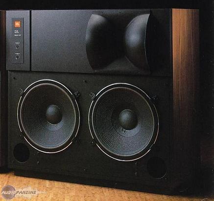

JBL did something like that in their K2 series. They called it "Imaginary Equivalent Tuning".
Maybe a search will reveal more details than the desccription here: https://www.audioheritage.org/html/profiles/jbl/k2.htm

The JBL 4435 has the two woofers tuned differently. Just how they approached this is way beyond me, I would think they would encounter phase cancellation issues...

Since DSP's are common today, if you control volume and program material, you can make four 4.5" woffer sound quite mighty and fool listeners. Just a matter of set-up.
Don't expect any high end company at an audition to ply fair and not use any trick in the book to make their products shine.
Børresen and Audio Group is a highly sophisticated snake oil destillery, mixing some nice products with rediculous overpriced esoteric stuff.
- Dual woofers with different volume and tuning
