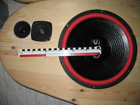

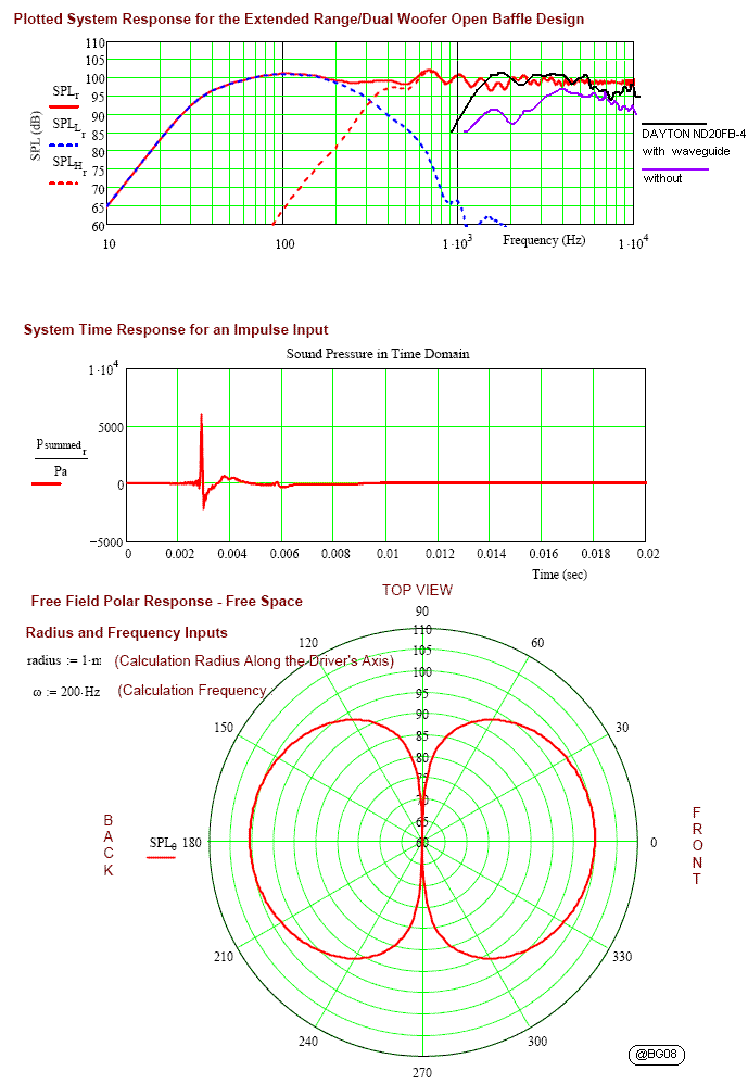

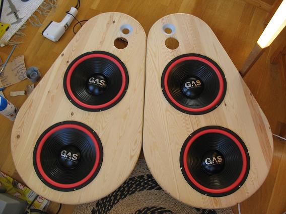

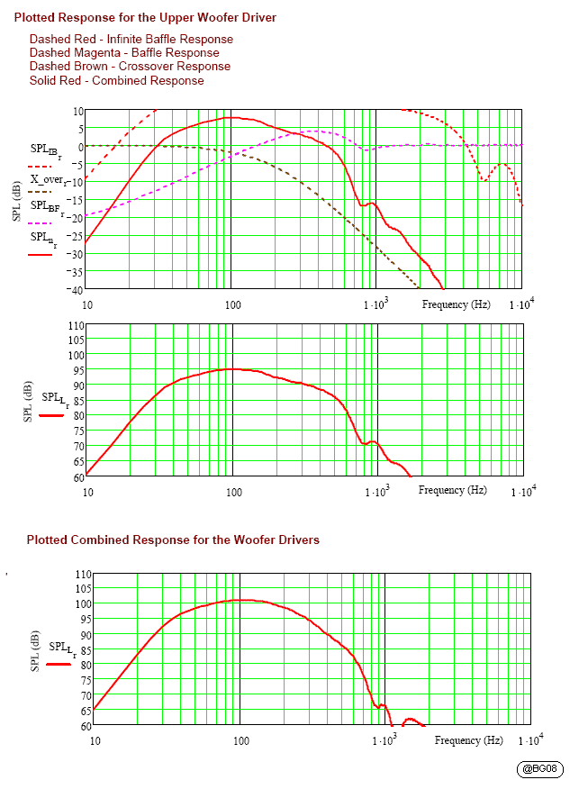

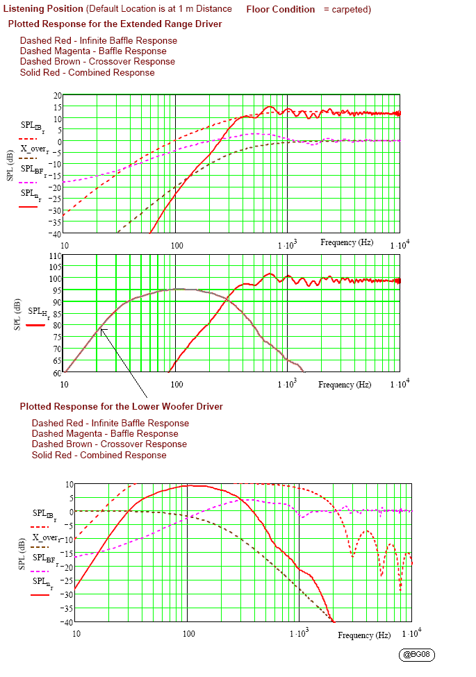

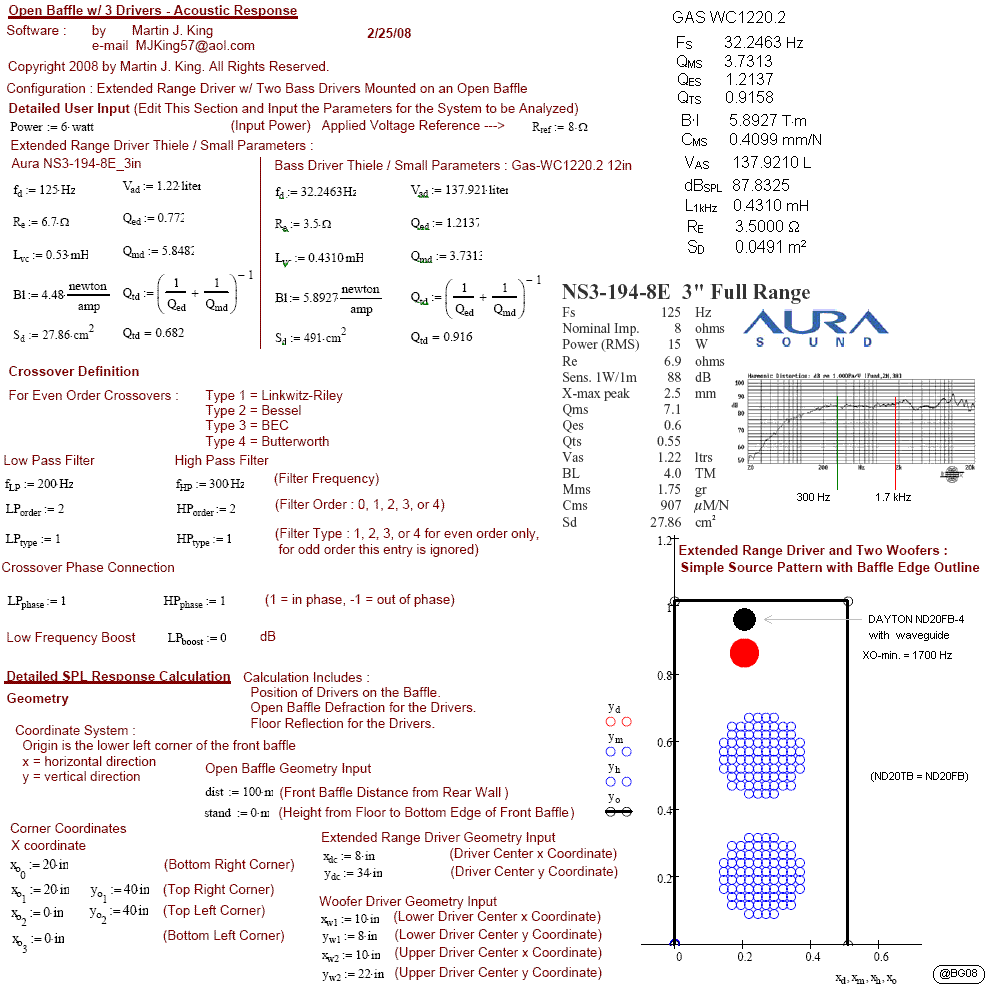

Hope I’m not disturbing this thread if showing pictures of a possible garbage design.
But FYI, my son and I have started a simple Christmas 3-way freestyle OB project using inexpensive leftover drivers that summed total to about 45 US $ less the two nessesary12 dB LR crossovers and the pieces of wood, of course.
The crossovers will be passive at about 300Hz and 1700 Hz. See the simulation and pictures 1(6) to 6(6).
b
1(6)

Welcome Bjorno
If that is your idea of rubbish I'll go and stick my head in a gas oven now!
Couple of questions if I may.
Are they car subs?
What did you use for the baffle??
Also what do they sound like???
Regards
Also Merry Christmas
Ted
😱 Don’t do that , I’ve just burn one of my fingers while making coffee on a ‘GAS’ driven :hot: cook stove.
Are they car subs?
Yes they are and purchased this late summer on sale, I knew they would work in an OB configuration.
Years ago I measured the T/S parameters, helping a friend solving trouble (SQ) in a car speaker setup where the GAS woofers sounded ‘midrange’, they where put in a 10 L box!
Swedish fur from 18 mm IKEA shelves named ‘IVAR’.
I’m still trimming the whole OB system. So far, my impression is the combination of the M and T drivers sounds promisingly good, and FR wise smooth, so do the W drivers too but the rear bracings/ wings is not yet finished, so you have to wait until after Christmas for more a reliable SQ statement from this OB experiment.

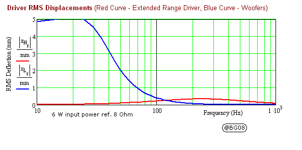

By the way, I forgot to post the excursion simulation, see picture 1(1).
