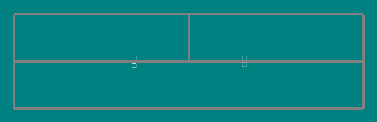

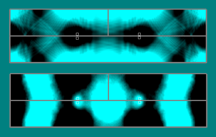

I realise I implied the answer to this but it may have been unclear. In this case you effectively cut the box in half and the modes will be like a half length box with the driver in one end (except with double the volume).if a single source is in the middle of the longitudinal axes, and is such balanced(?), is the above also true?
