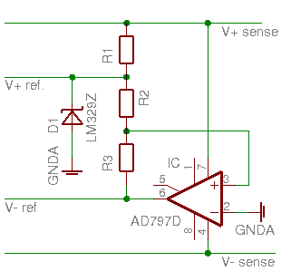

Some time ago I got interested in building a Gilmore headphone amp [1]. I'd like to power it from using a SuperRegulator. As I understand it, this amp requires well matched positive and negative supply voltages. Mr. Gilmore's powersupply uses an inverting power opamp to achieve this. All the SuperRegulator designs that I have seen only provide a single voltage, so getting a good match between the positive and negative side would require quite some resistor matching and tuning. Then one can only hope the whole thing doesn't drift too much due to temperature change and such.
I thought I'd slap together a positve and negative SuperReg, but replace the voltage reference with an opamp inverting the positive voltage reference. The advantage would be that no resistor tuning is required. Also, any drifts in the reference will be copied to both rails. It still requires resistor matching, but 0.1% resistors in the critical places should do.
What drawbacks are there to this approach? Is it worth persuing?

"What drawbacks are there to this approach? Is it worth persuing?"
Fears about the necessity the supply voltages being matched and tracking each other unfounded. The tracking on the current sources is much more important than the supply voltages. If one wants to do something to improve this supply I would put my efforts into bypassing the adjustment terminals for the regulators and filtering the reference noise with the right value caps.
Starting with a 48 V supply is unnecessary and will destroy the regulators if the input to ADJ becomes greater than 30 something volts (check data sheets for exact numbers). Worrying about drifts and matching of a few millivolts is a waste of time. A decent op amp cost as much as or more than another voltage reference like the LM329. I can't see any advantage to it other than the fact that perhaps he didn't think of how to get of a negative voltage from a REF 02 series voltage reference. Most people use shunt references like the LM329 which make it a no brainer for a negative reference.
Claims of open loop distortion products less than 80 dB and line rejection of 120 dB are kind of unlikely. The voltage changes of this amount on the output of the regulator from noise on the input of the regulator would be well below the noise floor and difficult to verify. I believe the Jung type regulator would be a real improvement over this supply. The positive supply tracking the negative extremely closely is a non-issue. Even the supply shown in the article could be greatly improved with a few capacitors and resistor.🙄
I'm not planning to upgrade the regulator proposed by Mr. Gilmore - I don't even want to use it. I want to replace it with a Jung type reg.
Drifts, okay, 10ppm/K is not enough to make me worry. Matching, however, is. In the LM329 datasheet, it says Vz is between 6.6 and 7.25V, 6.9V typically. Worst case scenario for a +-14V supply would be 1.32V difference. That's 4.7%. This, to me, seems like a lot.
Of course, in the Jung circuit, it could be solved by tuning the voltage dividing resistor pairs. Resistors are cheap, so buying a metric boatload is not a problem. Solving Vout = Vref * (1+r1/r2) and (r1*r2)/(r1+r2) = 500 for r1 and r2 gives r1 = 500 Vout/Vref and r2 = 500 Vout/(Vout-Vref). Aiming for Vout = 14V and Vref between 6.6 and 7.25V gives 965.5 < r1 < 1060.6 and 945.9 < r2 < 1037.0 Ohm, which is still quite a range. Maybe a ~950 Ohm resistor plus a precision trimmer?

"Of course, in the Jung circuit, it could be solved by tuning the voltage dividing resistor pairs."
I think if you buy a batch of LM329s you will find less than a couple of tenths of volts between devices. If really want to trim the supplies that close, put a much larger resistor than the value between the reference and it's filter cap, across the filter cap to ground to form a voltage divider for the small difference in reference voltages.

That being over with: your suggestion of a resistor across the reference's filter cap would allow me to tune a reference voltage down. It's a nice solution, but not very flexible.
I'm putting a small trimmer pot with the wiper on signal ground between the two resistors to the inverting inputs of my two opamps (R9 in the ALW schematic). That way I can adjust the gnd to be exactly in between the two rails. The drawback is that I no longer have a real star ground. :bfold:

It worked! Amazing. I was thrilled. Then, I accidentally short-circuited the positive side for a very short period of time. After some measuring, I concluded the AD825 had blown up. Today, I got the replacement, and it's working again! It gives a stable plus and minus 14.12 volts, though I still have to test it under load. That will have to wait for at least two weeks 🙁.
The picture shows the regulator. The opamps are invisible since they're on the bottom side of the PCB. In the center at the bottom you can see the two references and the trimmer pot. It's very easy to adjust the two sides to match.

As you can see in the picture in my previous post, I have a 100k pot in. It's hooked up with the wiper connected to ground between the two fixed resistors that control the voltages. This way, I have a fixed total voltage difference between the positive and negative side, but I can move the ground up and down a bit. Not too much obviously, but in practice there's more than enough room to play in. It's a 25-turn trimmer, so it's quite accurate. In my quick tests I was limited by my volt meter: +14.13V against -14.12V, ±0.01 or some such.
