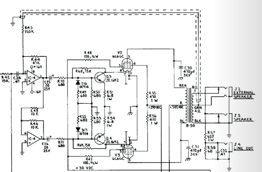

George, is this somewhat related to UBSET?
Jan
I did not know about the old Music Man amps until after I came up with UNSET and I still have never seen one in the flesh. I did repair a lot of guitar amps in the late 70's and through most of the 80's.
There are some differences between UNSET and Music Man. UNSET uses a P-ch mosfet as a follower under the cathode, so the cathode sees a near perfect copy of the applied drive voltage. Music Man uses an NPN BJT to in common emitter configuration to drive the cathode, so the cathode sees a drive current dependent on the Beta of the transistor and the current feeding its base. Music Man has the grid bypassed to ground for AC. The control gird of the tube in UNSET sees a scaled down copy of the plate voltage on its control grid. As Schade revealed a long time ago this provides a triode like response from the output pentode. This configuration eliminates the capacitor in the feedback path seen in the original Schade scheme. The ratio of the two resistors in the feedback path controls the DC bias point and the slope of the triode like curves generated by the mosfet / pentode pair.
In a SE power amp with a big sweep tube on 500+ volts clipping is seen in the 20 to 30 watts of audio power area depending on the size of the tube and how far you want to bend the specs. In this configuration THD is usually in the 0.3 to 0.5% range at 1 watt and under 1% at 10 watts. The THD is also dependant on the feedback ratio. These numbers were with a 10% feedback ratio with a 30 K grid to ground resistor and a 300 K grid to plate resistor. The screen grid gets between 150 and 175 volts bypassed to ground. Since the cathode is driven there is some drive applied between G2 and the cathode.

If often goes that way, doesn't it. You have an idea and then you find that others before you have thought about it too.
I used the principle in my direct drive high voltage amp for the QUAD ESLs getting distortion at 1kHz below -100dB. That's two zeros after the comma. I used a MOSFET for the cathode drive.
Interesting you want a triode like transfer, I was aiming for pentode-like operation with a triode to get very high output impedance and an active CCS load I learned from Nelson Pass.
I am now looking at keeping the feedback as tight as possible around the feedback loop to improve stability in the face of transformer phase shift.
Try to get to the situation that the only phase shift at HF is from the transformer and no further impact from other circuit elements.
That would help in increasing loop gain and lowering distortion. In this time and age there's no excuse for a tube amp with >1% distortion 😎

The difference between driving the tube's cathode with a transistor's Collector/Drain versus as a follower with the Emitter/Source is an important one. The C/D version gives you the gm of the SS device determining the current in the tube. While the E/S follower gives you the gm of the tube determining the current in the tube. (the lowest gm device rules ) The C/D version gives you the sound of SS ( especially for NPN bipolar Collector drive ), while the E/S version gives you the sound of a Tube. Although the difference between Mosfet gm and Tube gm is more of a semantic call, since both Mosfet and (power) Tube have near square law gm transfer curves.
High dollar tube Amps are typically using Old triodes or Xmitter triodes with fairly (but not 0.001 % ) low distortion. The UnSet scheme allows one to get the same high quality triode curves using a cheap TV Sweep tube or power pentode, but without all the HV expense and high Z OT issues. It also eliminates the issue with lower screen V (for making a psuedo triode) with TV Sweeps.
It's all a matter of taste I think.
