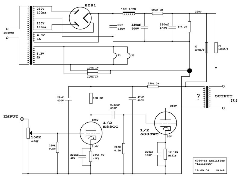

Thanks for the link - the schematic is a little blurry, however I've found clearer examples by using Liliput Valve Amplifier as the search term. It's a shame the quoted power output is so low at 2.5w, I was hoping to get around 5w per channel.
It's given me a great starting point - so thanks for the help 🙂

Nice little amp.
Somewhat worried schematic does not show any filament reference to ground: neither center tap nor resistive artificial one.
Not even (ugh!) grounding one end of winding.
Nor do they tell builder to ground pin 9.
I've found this version.... still no grounded pin 9 though.Nice little amp.
Maybe designer thinks "it´s widely known, no need to write it"
Me? ... I prefer to play it safe and not assume details are unimportant.

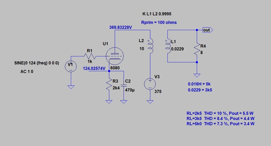

You can get 4.5...5 W from one half of 6AS7G, but this require optimum operating conditions, which are about as follows:It's a shame the quoted power output is so low at 2.5w, I was hoping to get around 5w per channel.
- Ua = 250 V (= some 370...380 V as +Ub)
- Ia = 50 mA
- Rload = 2k5 to 3k5 (see attached sim.)
- Ug(ac) = some 250 Vpp

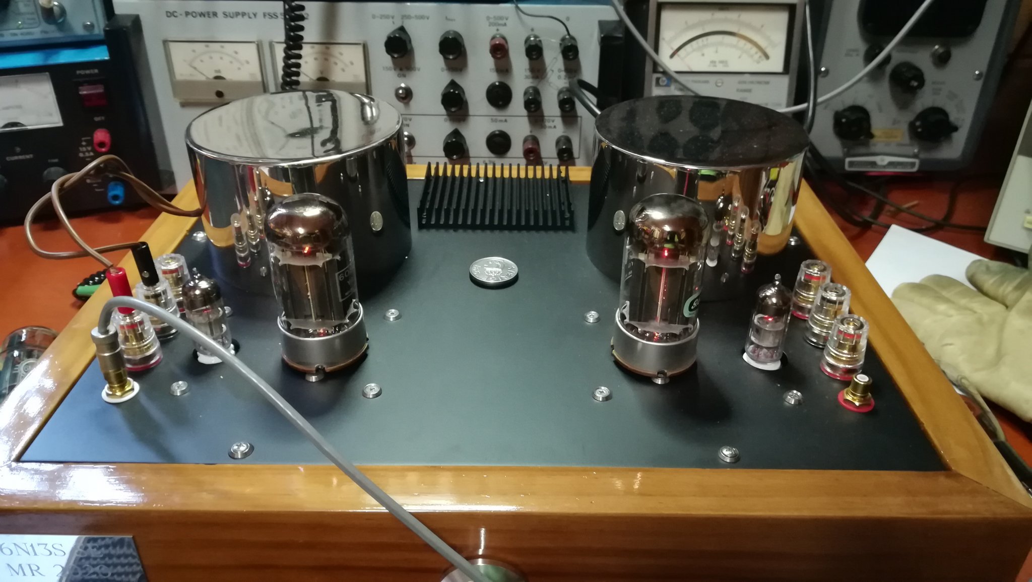

I have done 6AS7G SE amplifier, but used one tube (two halves) as the output stage. Power output was some 9 W. Attached my schematic too.
