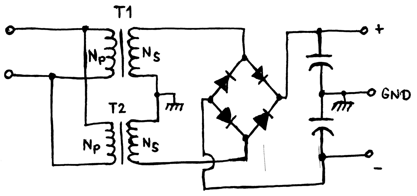

zman01 wanted a dual rail (+ & -) supply. In your answer number 2), You said use a single bridge to get that.
Could you please post a schematic of how to do that?
The only way I know of to get dual rail supply with only 1 bridge, is to use a resistive spitter, or some other combination of zener and resistors, active devices, etc.
That does not seem to be very efficient.
The series connection of the two secondaries forms a center tap, which is grounded in this circuit.

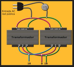

if you blast it constantly, both trannies are required. if you occasionally take it to full output ( or less ) a single transformer will do.you have to remember that music is dynamic and those transformers are capable of a constant 200 watts of output. class D is also 95% effiecient in getting supply power to the speakers.
if you need 40 Vac, you need to connect the secondaries in series leaving the center tap on both transformers unconnected. the new center tap will be the point where both trannies are connected. if you are out of phase 0 volts wil be seen , in phase 40 Vac will be across the leads
Stocktrader200 is right. Due to the crest factor of most music you can get far with a single 200VA transformer ("trannie", should we find ourselves in beautiful Canada). Just make sure you have sufficiently sized decoupling capacitors.
My circuit diagram addressed the question: can a single symmetrical-winding transformer be replaced by two transformers with half the power each? My impression is yes, using two transformers each having one similar secondary winding and connect them in series (with appropriate phasing evidently).
FauxFrench,
You have a good point, all that is needed is one bridge. I did not see that before you posted the schematic.
The only thing to remember is that both secondaries will be loaded on positive and negative alternations. That is a full load on each secondary. It will have to be calculated as to whether each secondary has enough power to power the + and - loads.
