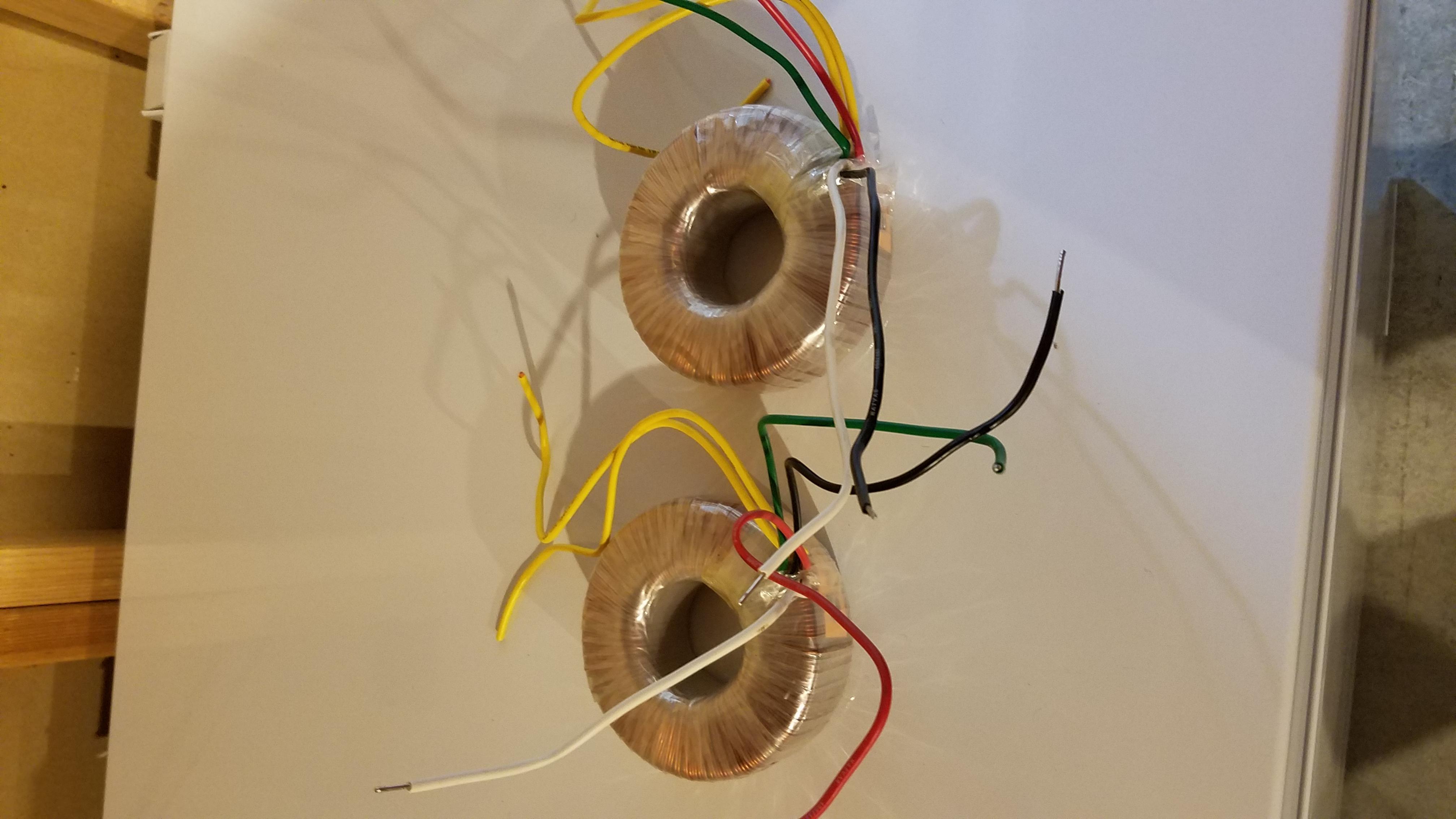

I have two identical torroid transformer laying around. Both have 117 Volt single primaries and two 20VAC 5 amp secondaries. I want to connect the two secondary windings in series on each transformer to get 40VAC 5 amps. Then connect the two transformer secondary windings out of phase to get 56-0-56. My question is: What is the total wattage for both transformers connected this way? I pretty sure I have 40VAC X 5amps = 200 watts for each transformer, but what happens to wattage when they are connected out of phase?
You rectify each 40VAC to get 56VDC (approx), phase doesn't come into it, unless I'm missing something?
Each single transformer rectified will produce 56VDC at 5 amps. If the two transformers are then connected out of phase with the connection being the center tap, i.e. 56-0-56, how many amps would both transformers connected this way provide, 5 or 10 amps?
Still 5 amps, the current doesn't change, the power is twice that of one transformer as the voltage has doubled. If you connect the two rectified supplies in series, phase of the transformers isn't an issue

Yes, you can series connect primaries. Each will see half the supply voltage.
Or you can connect the primaries in parallel (fuse each separately). Each sees the full supply voltage.
Similarly you can connect the secondaries in series or in parallel. I do not recommend the paralleled secondaries from different transformers. Bifillar wound secondaries on a transformer should have IDENTICAL turns and can be paralleled, safely.
The series connected secondaries from separate transformers or from one transformer can be connected in phase, or out of phase.
In phase series connection gives an output that is the sum of the two secondary voltages. Out of phase blows your fuse, or turns on the bulb and saves your fuses. That's why you should use the MBT. An incorrect wiring connection turns on the bulb instead of blowing up your transformer if the fuse you didn't fit has not blown.
each transformer has a current rating
Rated current = rated VA divided by rated output voltage.
Series connected secondaries are current limited to the LOWEST current of any winding.

Connecting in series means that voltage adds, current does not. So two 20V 5A windings in series gives you 40V 5A.
You won't get a continuous 5A DC by rectifying a transformer secondary which can supply 5A AC. You will get more like 2-3A DC.

using two transformers are not a big deal if identical,
connect the primary in parallel, the tentatively connect
the secondaries in series, then power up using the mains
bulb tester as a safety measure....
if you get 20-0-20 correctly then that is the connection you want,
if not, then just reverse one secondary side....this easy...
btw, if you can tell me the weight of your traffos, then that will even give a better picture...

3 lbs. 15 oz. each picture attached. They are identical Talema 4365-P1S2 toroids. i have 4 - 15,000 mfd caps to use for input filtering, I also have an 8 amp bridge, but may upgrade that to 25 amp. i'm using this to power a single channel class D Chinese amp for my LFE subwoofer. Supposed to be 350 watts but realistically hoping for 100-150 watts into 8 ohms.
TonyTecson has a good idea. Use the Bulb Tester.
In series it will always be 20 - 0 (Ct) - 20, unless something is wrong with the windings. But it may not be in phase.
Without a 2 channel scope you can not Directly visually screen check the phase.
But you can easily check the phase with a DMM. Just read from one 20 to the other 20. It should read 40.
If not, reverse the connections on just one secondary. Re-test, it should read 40.
