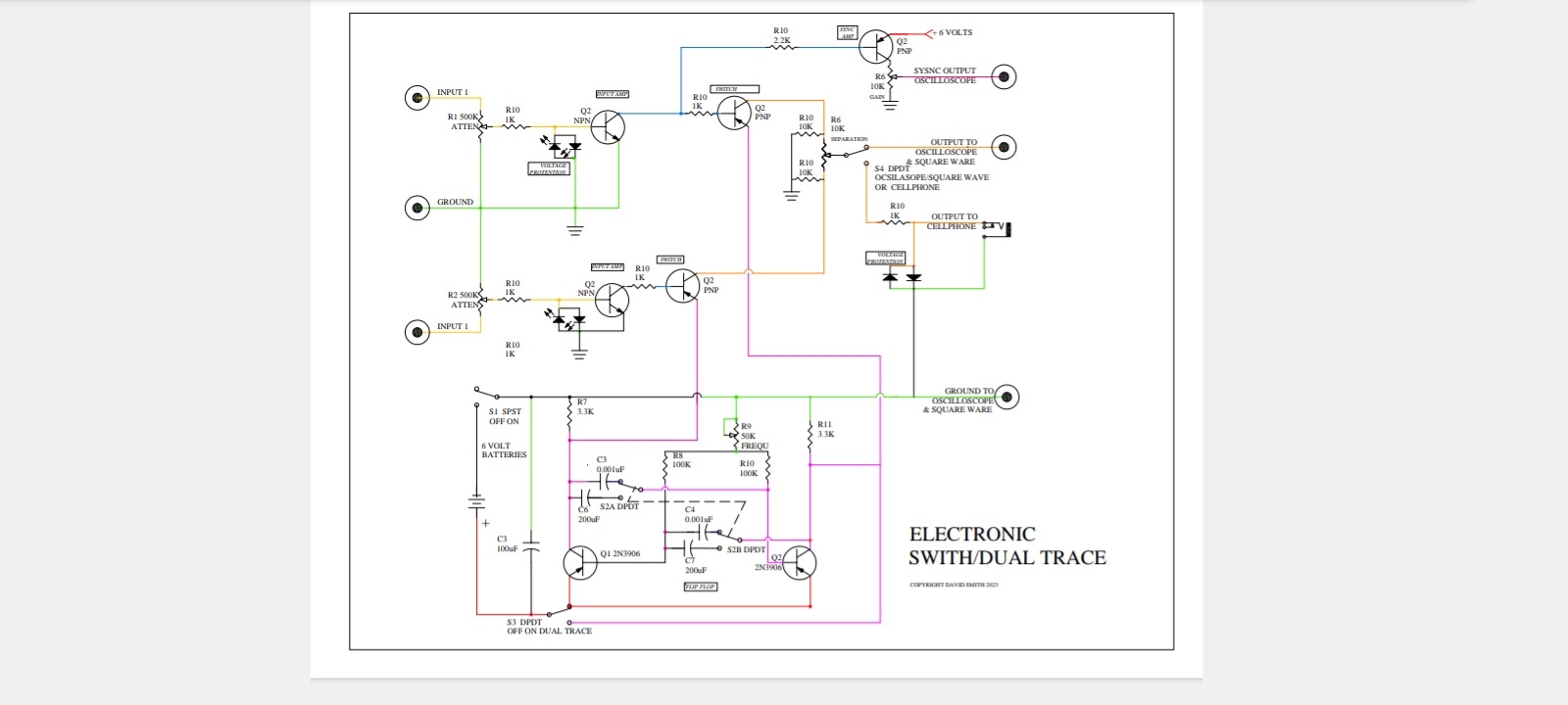

First impressions: unorthodox drawing style, Ic-q2 is summing of only base currents from q2 and... another q2? There are six q2's!. How to calibrate the attenuators and the separation pots? Purpose of S2? Frequency range with R9? Assume that all connectors shown are banana-style - BNC is preferred. Other issues pending.

On paper it should work great.
The best I can test is 5 MHZ but it could go as high as 250MHZ.

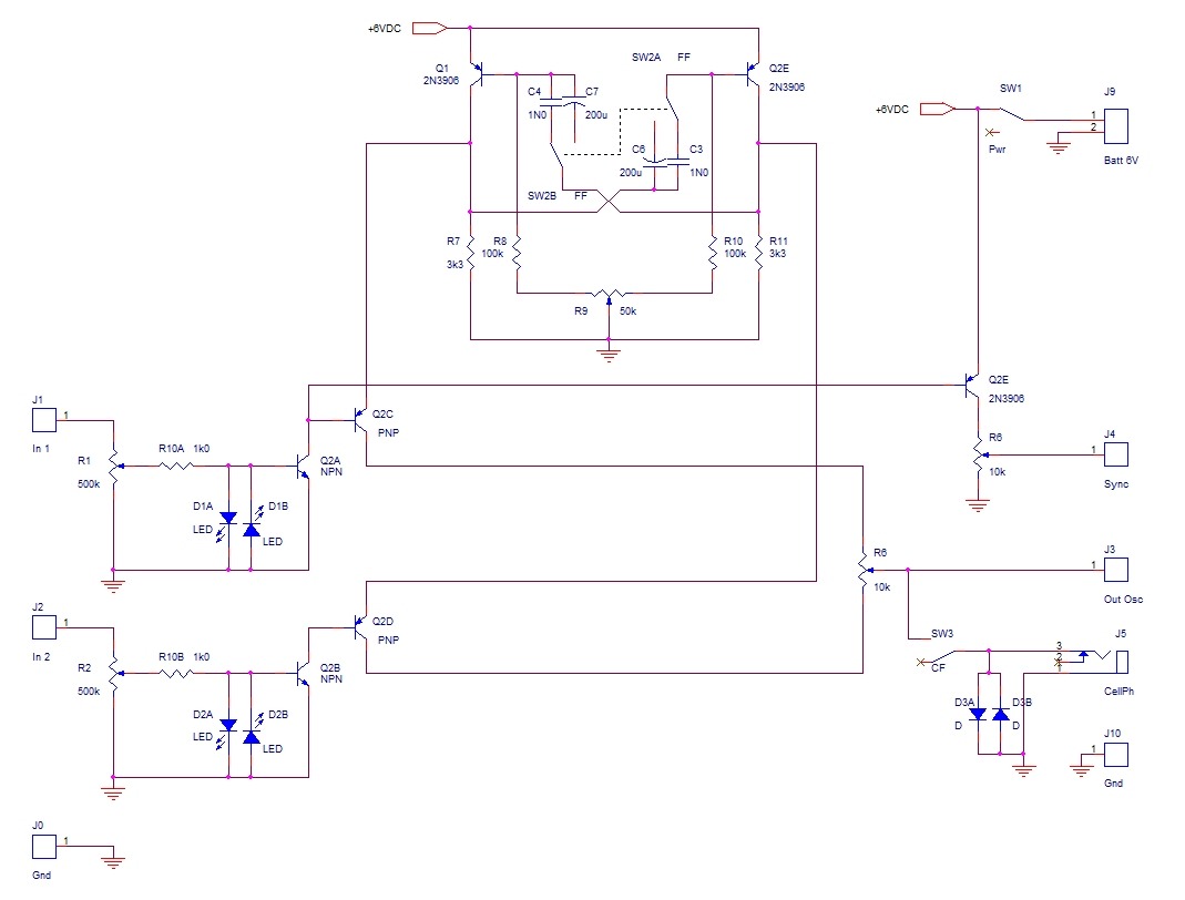

Your schematic is great.A more traditional view (no suggested modifications, back annotated with capitals).

If Q2A is ever turned on it will fry along with Q2E. That's probably not what you want...
Instead of the multiplexing, why not just use the L and R channels of the phone and the two channels of the scope?

40 kHz on a cellphone?? That would surprise me. POTS was limited to 4 kHz as I recall. Same for GSM as I recall. I would expect the microphone to be sampled at 44.1 kHz or 48 kHz at the most. I'm willing to be proven wrong, though. 🙂Most that would build would any only has a cellphone witch is only 40 KHz.

It does need resistor for protection. Witch I did not show.
There few others I need add for protection too.

There are a lot cellphones only have one channel.If Q2A is ever turned on it will fry along with Q2E. That's probably not what you want...

Ah. Good point.
Now going back to your circuit: One idea could be to make the two inputs differential and switch the current source for the diff pairs back/forth. I've done that in the past and it worked pretty well. Another option could be to use transmission gate switches, such as the 4066 CMOS analog switch.

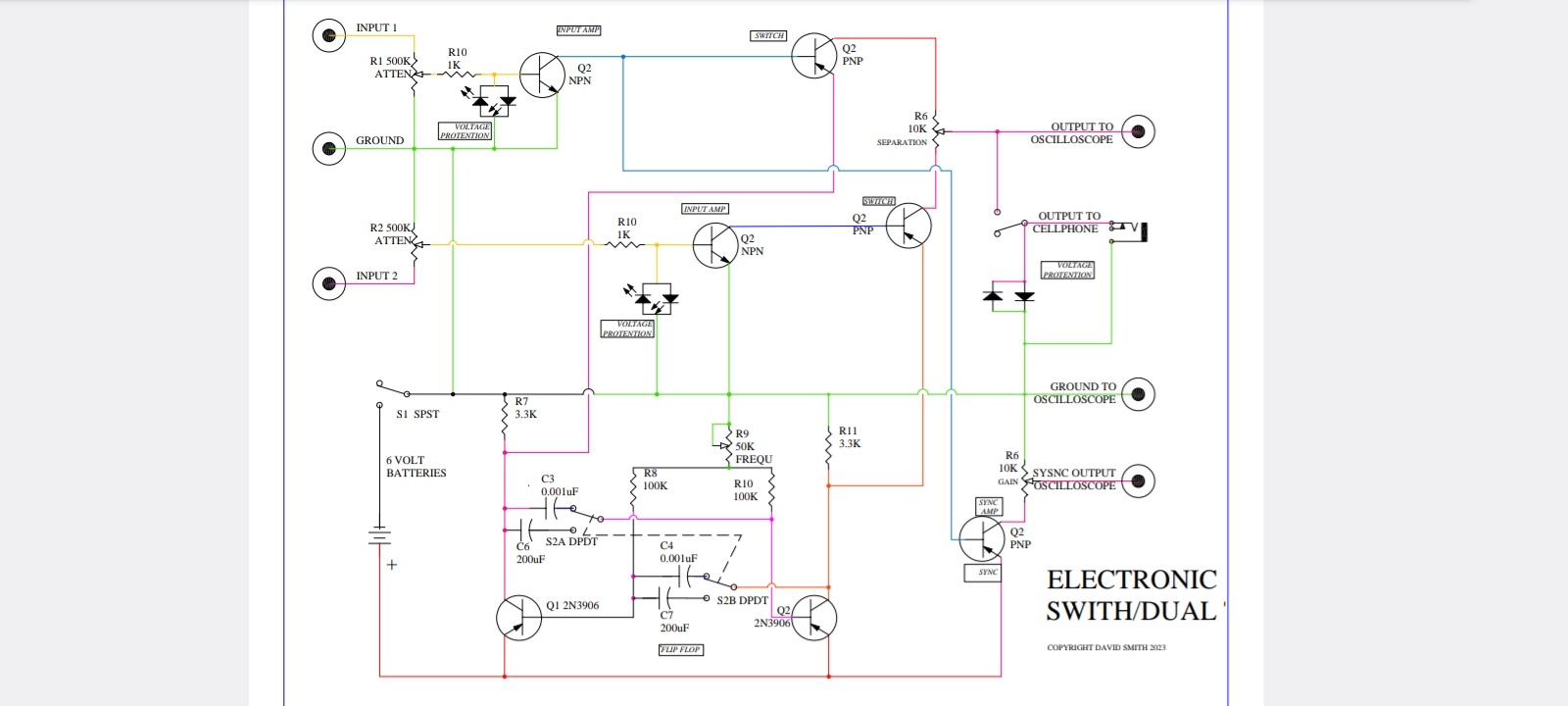

Here more update schematic showing resistors to protect the transistors from overloagood luck, instead of my deleted former entry here

Referring to my drawing in #6, Q2C and Q2D are in deep trouble.
Q2A and Q2B are very sad. The illustration in #9 is deluding.
Despite the added resistors, this design has a very high AI-level.

It is a simple amp and switch combo.
If look the old tube type they used very few parts and is a just a amp and switch
