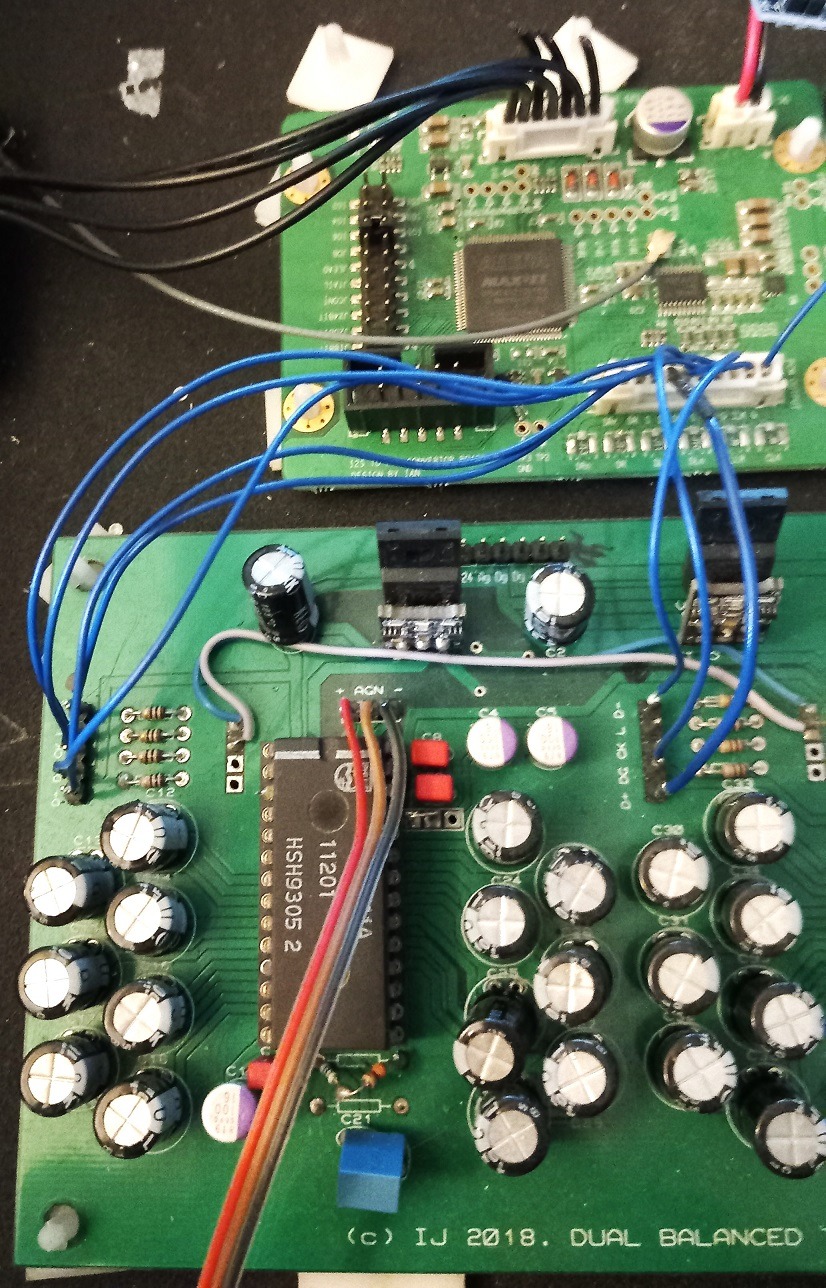

It's simple. The PCM board has 4 data outputs, L+, L-, R+, R-. The clock and latch (WS) are common to both because the dacs are in simultaneous mode so all data is latched at the same moment.
My messy wiring is embarassing!

Thanks, but no use as it doesn't provide -ve L & R data for dual DACs.
I know you can just invert the data and put up with the LSB error at very low levels.
Also no mention of the clock being stopped after the data is latched - that's a very important feature for low noise, and whether it provides the offset binary needed for simulaneous mode.
I might redesign it so IanCanadas I2s-PCM board can be fitted to the dac pcb so the Ph2 cable can be kept very short.
Also remove the voltage regulators to save space.
To use the Grundig or even a divided Bck dem clock this would have to comre from the input to the I2S board as the clock is stopped after the latches are set.
Based on what I've read, I think all those changes would be worthwhile for sure. I'd say I'm two months away from finishing my workshop and being able to construct stuff but I'm certainly willing to test.
I was planning on leaving out the regulators to start and just feeding the board directly with Salas BiB 1.3 supplies since I have all the parts
