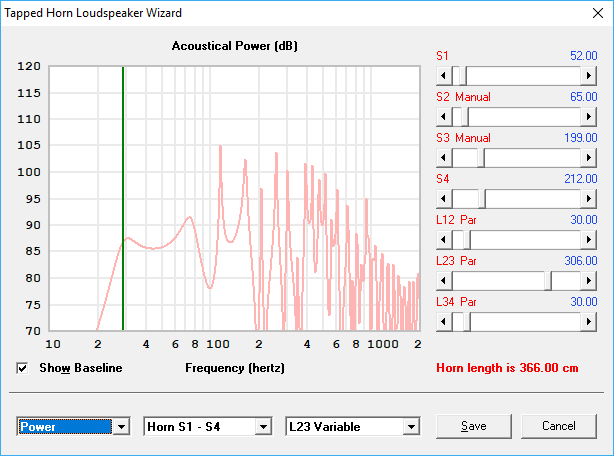

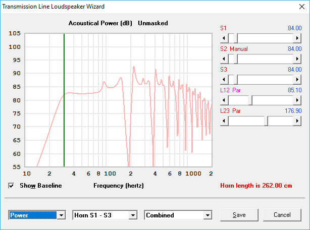

The volvotreter 28hz looks good but as Brian pointed out there are issues with its response that I think I'd have a hard time integrating in to my system. Any thoughts?
I wrote a longer reply and lost it, so here's the short version:
If you're referring to this design:
The Tangband 30Hz Tapped Horn – Volvotreter Homepage
1. It is modelled incorrectly
2. The driver parameters are slightly different the parameters for your drivers.
The first attachment shows the response of the Volveter TH, modelled correctly, with one of your drivers. The second is a simple offset TL with the same driver. It's half the size, so less efficient, but does not suffer from the response and GD problems that affect the TH design.
