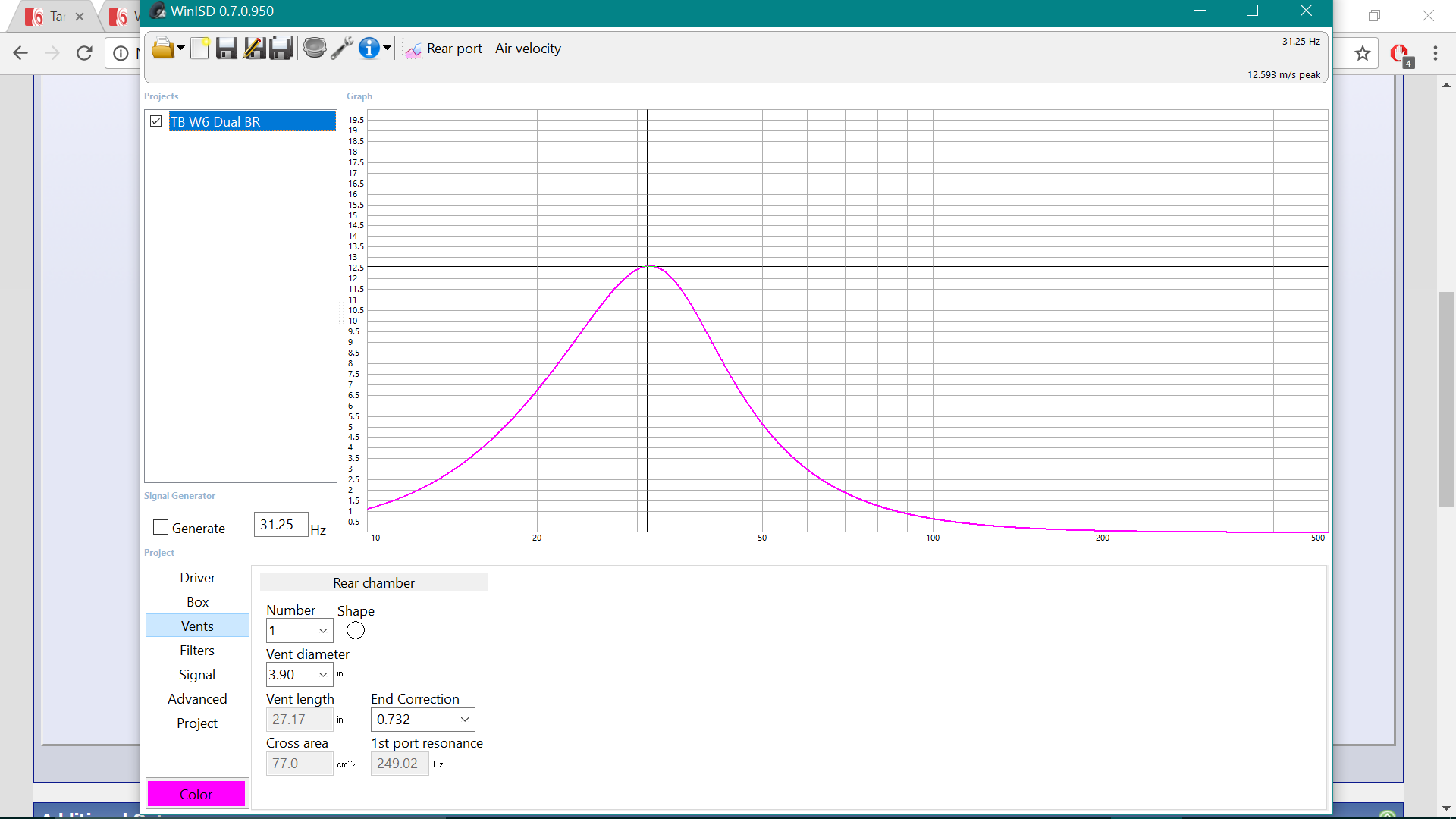

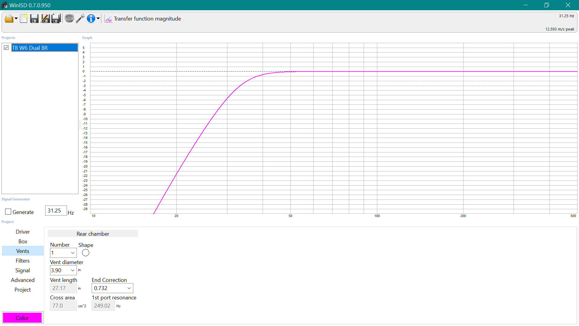

I've run sims on WINISD and have come up with the following cabinet spec for an F3 of 33hz:
26 litres / 0.918 ft3 - net cabinet volume
32.4 litres gross cabinet volume (inc. driver/port displ.)
10cm / 3.9" width port
69cm / 27" port length
Port velocity is low at 12.5ms @ 31hz.
Would anyone mind giving their thoughts on this proposed design before I order wood, please?
A couple of graphs attached that I think are relevant.
Many thanks in advance!

Transfer function looks good. How are you going to fit a 69 cm port in a 26 L enclosure?

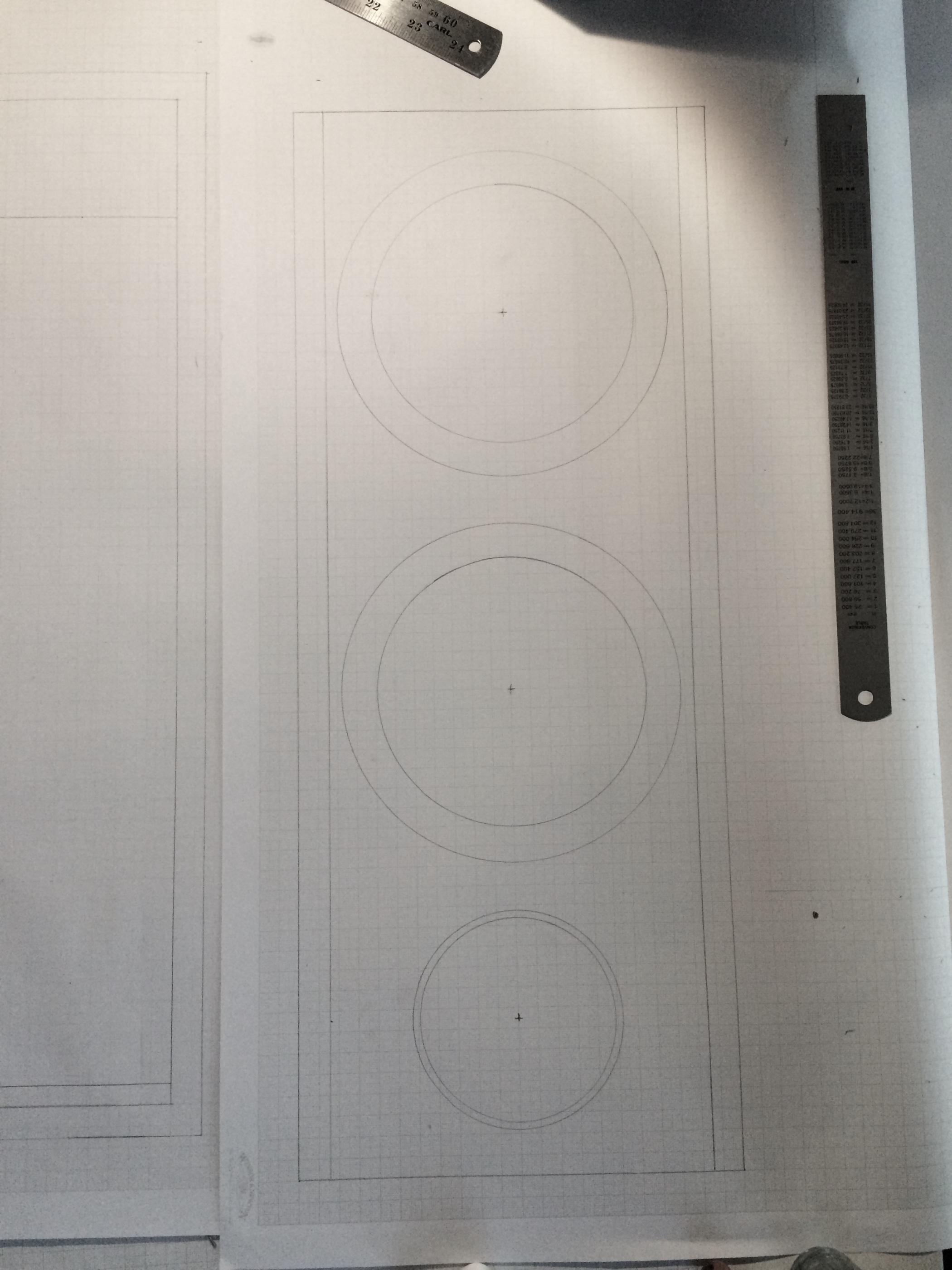

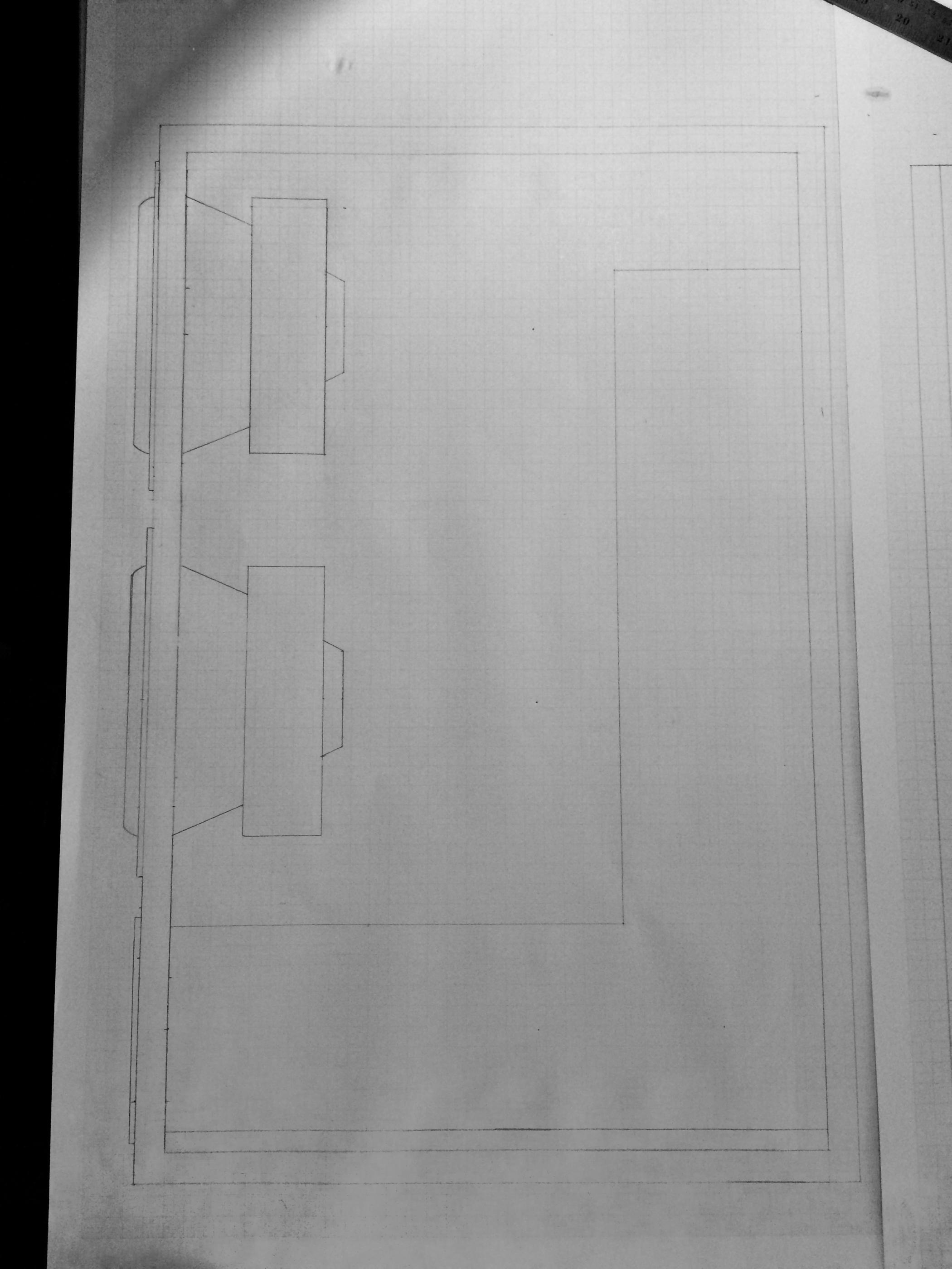

Thanks,
I will be using PVC pipe with a plumbers elbow bend so it will be a L shape. Port will be front facing beneath the two drivers in a column.
Hand drawn (lol) pictures attached!
Two things:
- a sharp 90 degree bend will cause chuffing (plumbers elbows are sharp)
- ports like to have some breathing distance at their ends, at least their diameter
Interesting, thanks. I will look in to a smoother shape bend.
What would be the negative effects of the relatively short port clearance in this cabinet?

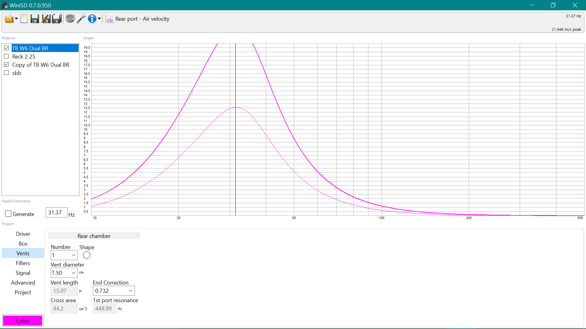

For a shorter port I could use a 75mm port diameter but the port velocity shoots up to 22ms. Is this way too high?
You should be fine with a right-angled bend and a particle speed of 12.5m/s
At 22m/s, you are going to see some vent compression effects. This may not be readily audible however, unless perhaps you're playing test tones.
The proximity of the inside end of the vent to the nearby walls will lower the effective resonance frequency a bit. Be prepared to measure Fb and to trim the vent if necessary.

Don't forget, it is 22ms at full power. Driver might be limited by Xmax.For a shorter port I could use a 75mm port diameter but the port velocity shoots up to 22ms. Is this way too high?
You can try my SpeakerSim, which simulates port velocity at maximal power (according to Xmax).
