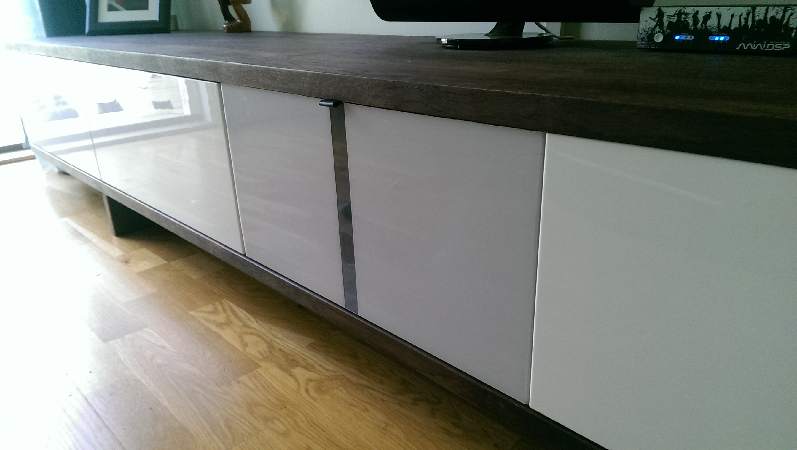

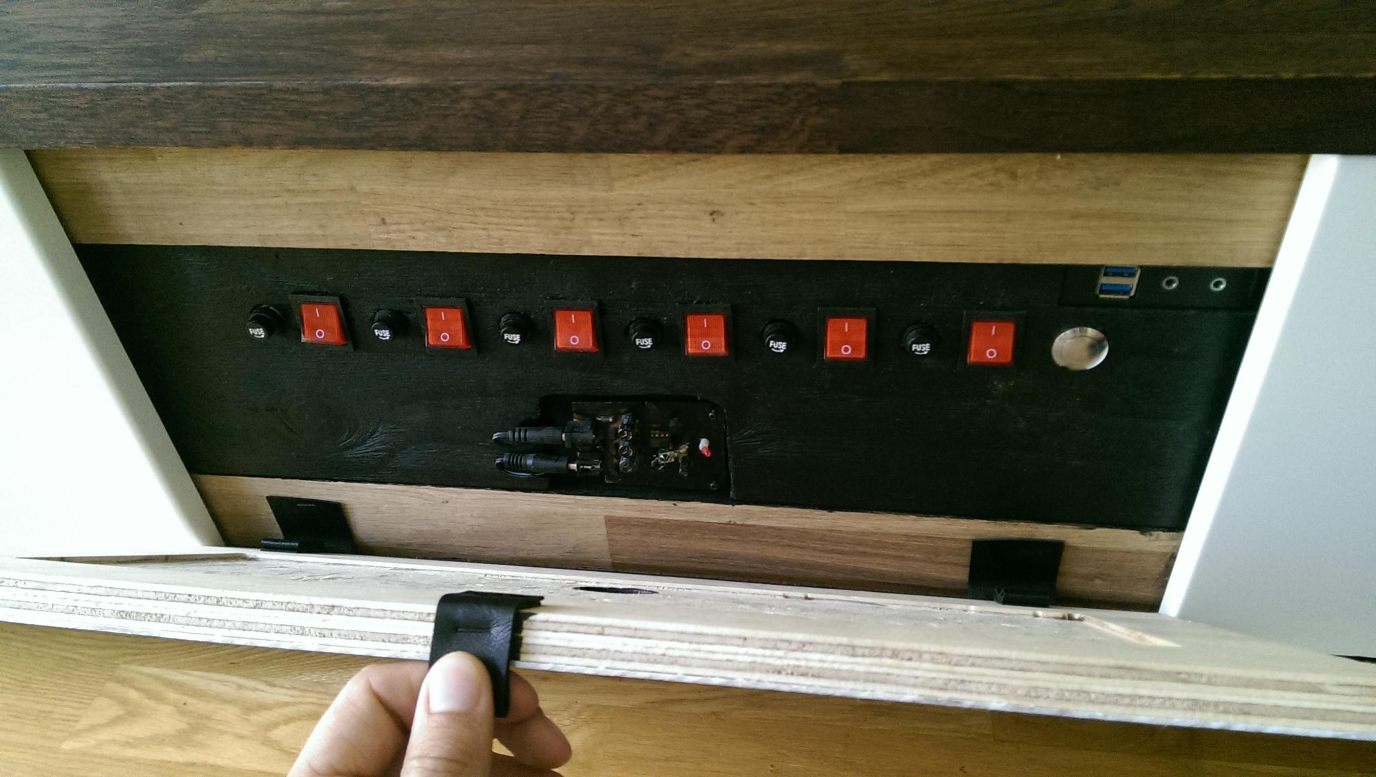

And a few pics
Now it's in the right position:
The colors in this pic is closest to the real thing.
I still haven't ordered an amplifier, so I'll connect a TPA3116 for testing.
/Anton

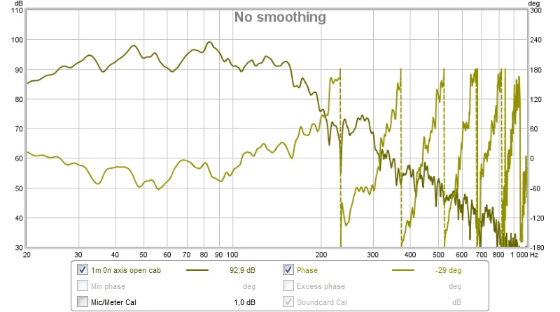

Measurements done with UMIK-1:
Near field (~15 cm) measurement of right speaker.
Comparison of left vs. right speaker. Left speaker is close to two boundaries (walls) which I assume is the reason for the difference in response.
Background noise in sofa.
The three seats in the sofa and in the chair with right speaker playing.
/Anton

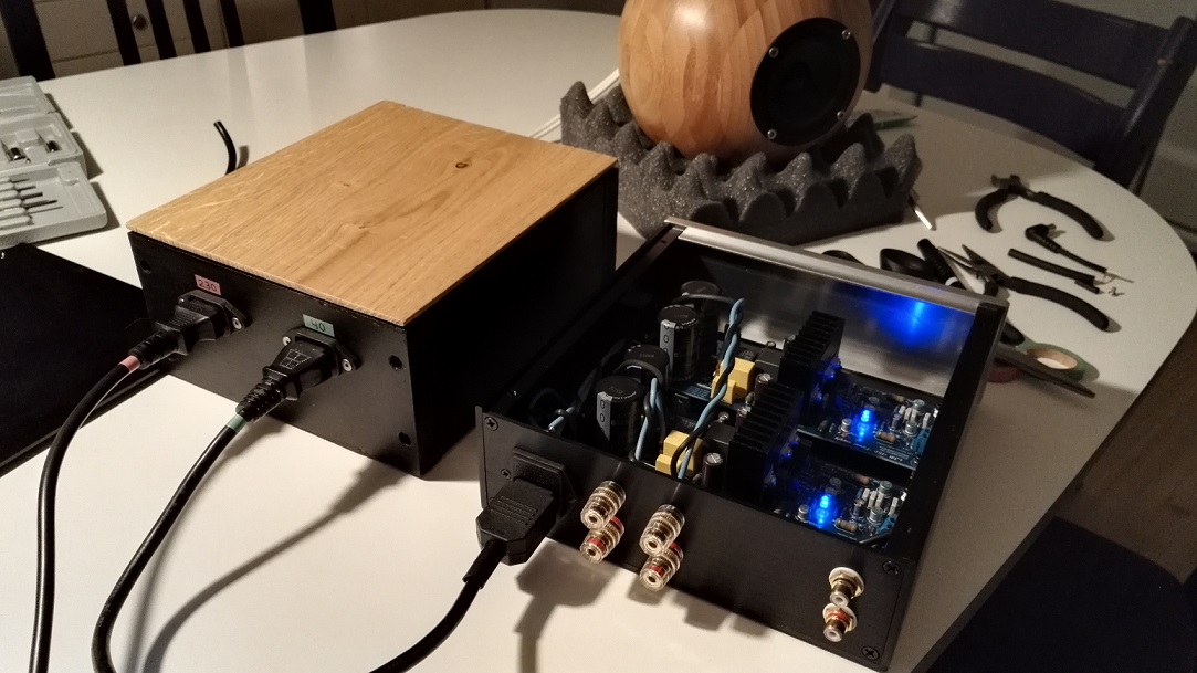

Sorry I didn't respond sooner... I didn't know as I had no amplifier with enough oumph. Today I finished a 2 x 300 W IRS2092 (L15D-PS):
The wooden box contains a 600 VA 40+40 V toroidal transformer, first time I'm making an amp using that. It's making a slight humming noise, is that something that needs to be adressed? I probably won't hear it when it's in the media console.
Hopefully I'll have time tomorrow to make some measurements at decent levels.
/Anton

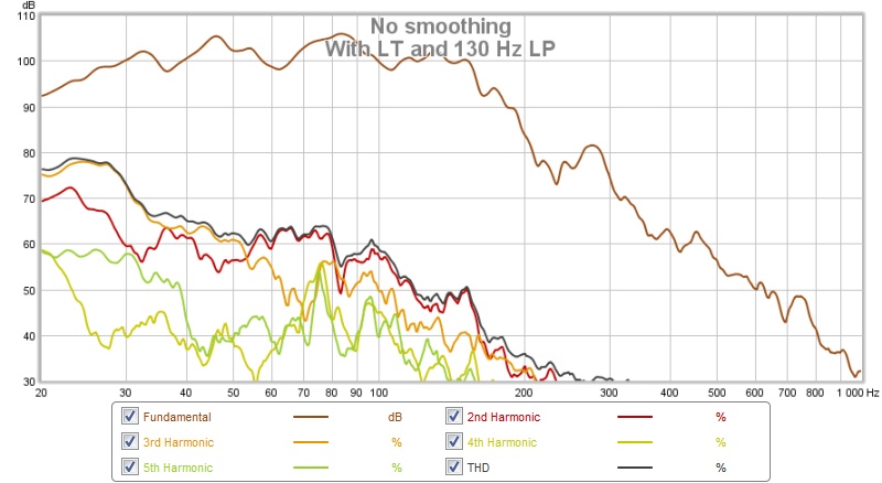

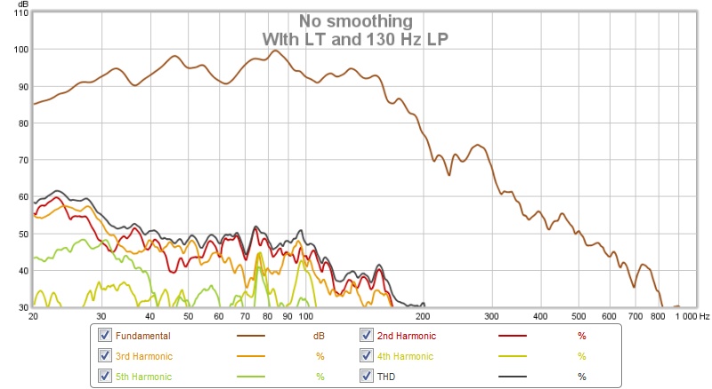

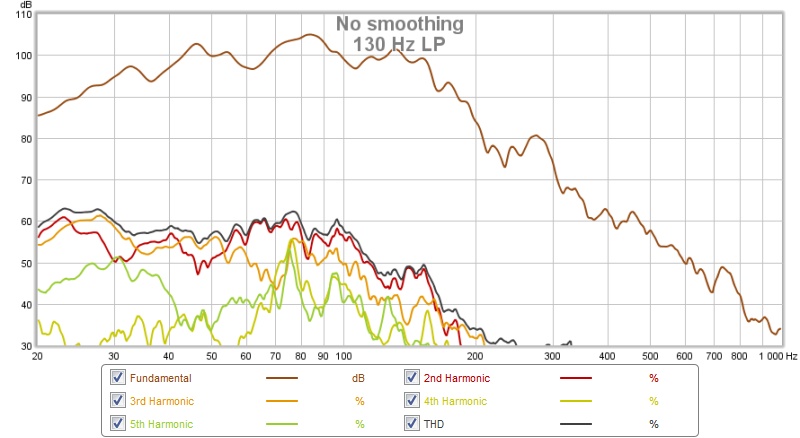

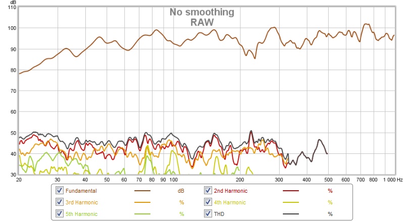

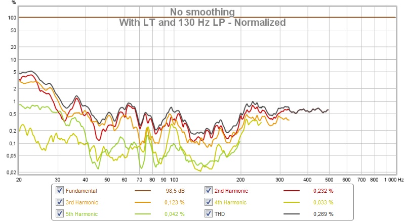

Measurements at high level
Finally some measurements that really say something! I've measured the right subwoofer at 1 m distance, with mic close to floor.
First I tested the vibrations, directly I had to move a sheet metal candle holder down as it was rattling. I put it on the floor 50 cm away but that didn't change anything (still rattling). So I moved it to another room. Now without things on the console I can't feel anything at 85 dB/1 m. At 95 dB/1 m it starts to get noticeable, but not more than the wall behind (there is a 2 cm gap between console and wall). This means that the vibrations might as well be caused by outside air pressure. There is however some point around 250 Hz where the nanoavr and the center channel starts to rattle slightly. I'm not going to use it that high though.
There is some serious rattle coming from a china cabinet 2 m away from the subwoofer and also from a sideboard (containing more china) 4 m away. They have discreet obvious audible peaks between 60 and 90 Hz and might be the reason for the broad hump in distortion in all measurements around those frequencies.
1 m, on axis 95 dB
No EQ, LT or LP:
With LT and LP (130 Hz BW24):
Distortion:
Normalized:
Below 5 % distortion for all frequencies should be considered decent. How about at 100 dB?
1 m, on axis 100 dB
With LP:
Still below 5 %.
With LP and LT:
It looks like I've found the limit for this setup. 100 dB/1 m without LT and 95 dB/1 m with. This is for one subwoofer and I have a total of 3 (2 in console and one behind couch).

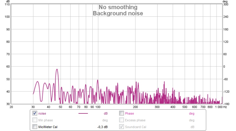

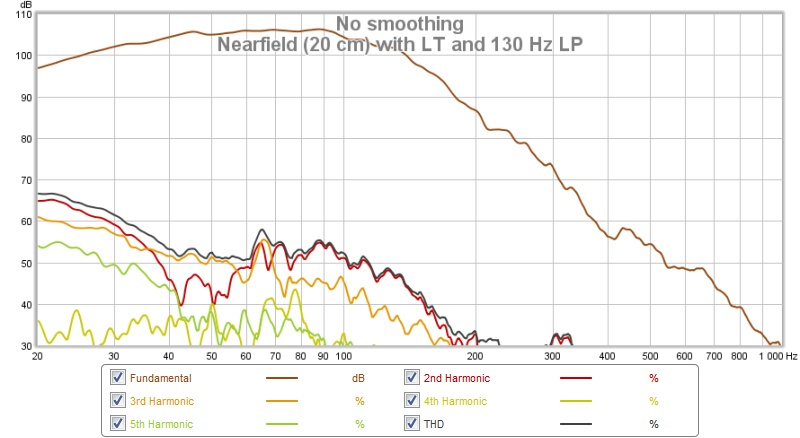

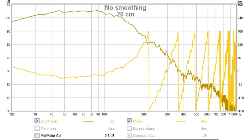

This is the background noise level in measuring position:
And this is what the near field (20 cm) measurement looks like with LT and LP:
This type of measuring is exhausting, above 90 dB is loud! Next time I'm wearing ear protection.
