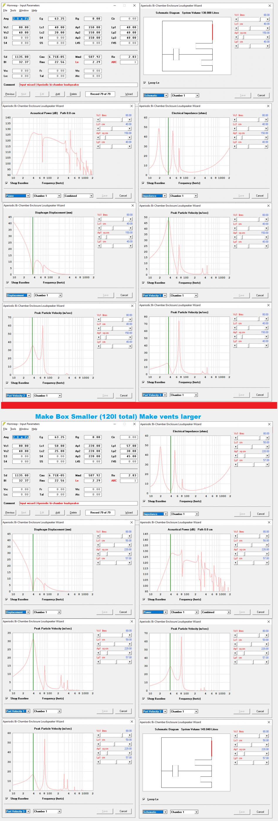

I don't have the sundown specs. But I'd think it is something similar to a sundown zv5 and nsv4. The nsv3 has about 22% more bl than the zv5 and the nsv4 has 22% more bl than the nsv3. The zv5 and nsv4 specs are on sundowns website.
FWIW a rough estimate

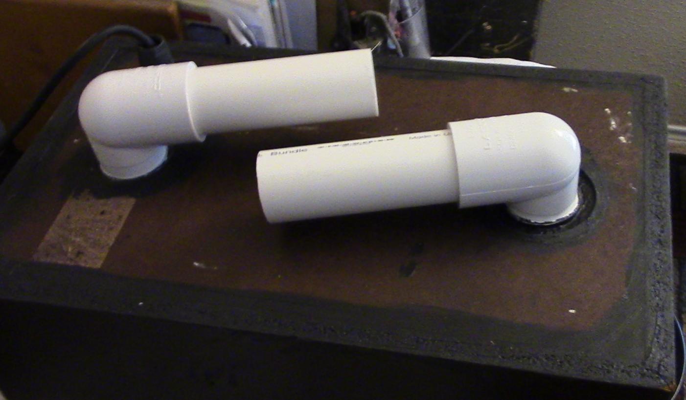

You might consider using plumbing pipe exterior to the cabinet to take advantage of odd trunk shape volume, while allowing a smaller cabinet.
Using pipe couplings in the cabinet, adding 90 degree slip elbows, then pipes from the elbows allows easy changes to experiment with different Fb.
That approach would also allow angling the port, "piping" output to the cabin in the optimum place.
You could also easily disconnect the pipe if you wanted to use the port area for a trunk 😉

I mean that would be an option. But as I said, I'd need 720-800cm2 of port area, so like 4x6" ports or 2x10" ports or one 12" port, just to achieve 30m/s of port air speed.
And the length was around 1,5m if i remember right. So it is still pretty hard to accommodate.

OK, using the 'D1' specs, the published specs of the 18" NSv4 line up surprisingly well whereas the Zv5 winds up with a bit lower Vas, higher Qes/Qts and since there's only one dimensioned cab recommendation, the NSv4 is ~ max flat with the Zv5 is under-damped with + ~ 4 dB/38.5 Hz.
112"^2 vent recommended, but factory cab is only 93.5"^2 and both have a high vent mach @ 3 kW/19 mm Xmax, though noticed on a DIYMA? thread awhile back that claims from testing that this is acceptable in trunk apps, so FWIW/YMMV.
At 40 mm Xmax, it's of course higher, though with its significantly increased VC heating, lossy inductance, mechanical stresses it should be lower, though still in the 30s, so overall seems better to 'critically' damp the vent** or use an even bigger one [recommend 112"^2] or best choice, dual 18" PRs Vs more peak power.
Re HF response, due to its low inductance, HR predicts the NSv's HF -3 dB @ ~296 Hz referenced to its ~100 Hz mid-band efficiency and the Zv5's @ ~436 Hz referenced to its ~60 Hz.
Anyway the mean usable HF BW short of adding a FLH to the driver's face = ~[296*436]^0.5 = 360 Hz/F3.
Bottom line, without even any published NSv3 18" specs and somewhat questionable specs of these others, all this might very well be just a bunch of 'floobydust'. 🤐
** Click Test: Click Test | GM210 | Flickr
edit: Will need HPF8 below tuning

But I have been modeling it on WinISD with 8kW in a 250l enclosure tuned to 25-30Hz.
And with a 20Hz hi-pass filter the excursion stays pretty nicely just at 40mm, probably even less IRL and especially in the car, acting more like a 6th order.
I have tried modeling series 6th orders and dual reflexes in both Bas Box 6 pro and hornresp, to the best of my current abilities.
With Hornresp I seemed to be able to get a lot more output with both designs than reflex, only just a hair less at the reflex's peak. This is just about what I'm going for.
I am just stuck with the overwhelming design that goes into making hornresp dimensions 3D.
I only modeled with the rough space of 250l in the enclosure. I have no idea, how much space the ports will take up, how big they should be or where they should be placed for optimal sound.
