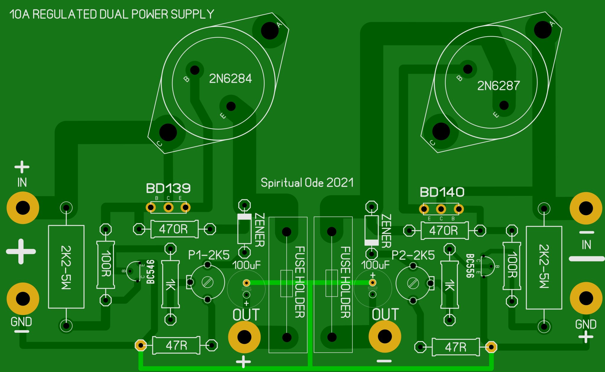

After Maximax77 request, I want to share with you, a dual rail PS that I have used in all my class A builds.
The idea had come to me by an elektor negative power supply for printers.
So I designed a dual rail +- power supply using the famous 2N6287 / 2N6286 or 7 darlington transistors and used it after my diyaudio/firstwatt CRC board for all my class A amplifiers. The power supply is adjustable via a 2K5 multiturn trimmer and using a 0R1 / 5w resistor at the output, it can draw up to 10A / 50V. The 2N6284/86 transistors require a large heat sink whether have to draw more than 1A continiously. At the image below, the positive rail is only appeared( I don't have a circuit editor yet ) as the negative rail is identical but the transistors ( 2N6287 / BD140 / BC556 ) and the zener diode that is reversed for negative circuit ( The output cap must be flipped vertically too).
The zener diode is used for limiting the lower voltage regulation point. For example, if you want a 28VDC at the output, you will use a 24V zener so that when you adjust the trimmer for the desired DC out, the DC measurement will never go below 24VDC. When there is a good DC filtering at the input, the AC ripple is less than 0,2mV.The circuit is very simple and reliable so I don't think there is nothing else for me to add. Have a look and if somebody is interested tobuild it, the layout 6 gerbers are available.
Nice circuit. Any output impedance measuremnents, preferably against frequency?
A tip for a future PCB review: if you rotate the 2N6287 180 degrees, the heavy traces get much shorter.
Better yet, if you place both power transistors horizontal the PCB can be much smaller.
Jan
You can play with gerbers and modify the pcb as you want.
I will try to place the transistors horizontally for more space but there must be space for the aluminum L bracket. The circuit works fine with a really low ripple.
It was just a suggestion. But you really should measure the output impedance. Low ripple is necessary, but if the output varies with load current, that should also get attention. It is a regulator, so it would be nice to know it actually does that and how well it does that.
Jan
Jan
As i can recall from my memory, I had tested the circuit with National Instruments 12.0, using a dummy load at the output. Both V and A were steady. In real world, my 4 class A amps work superbly with that PS.
