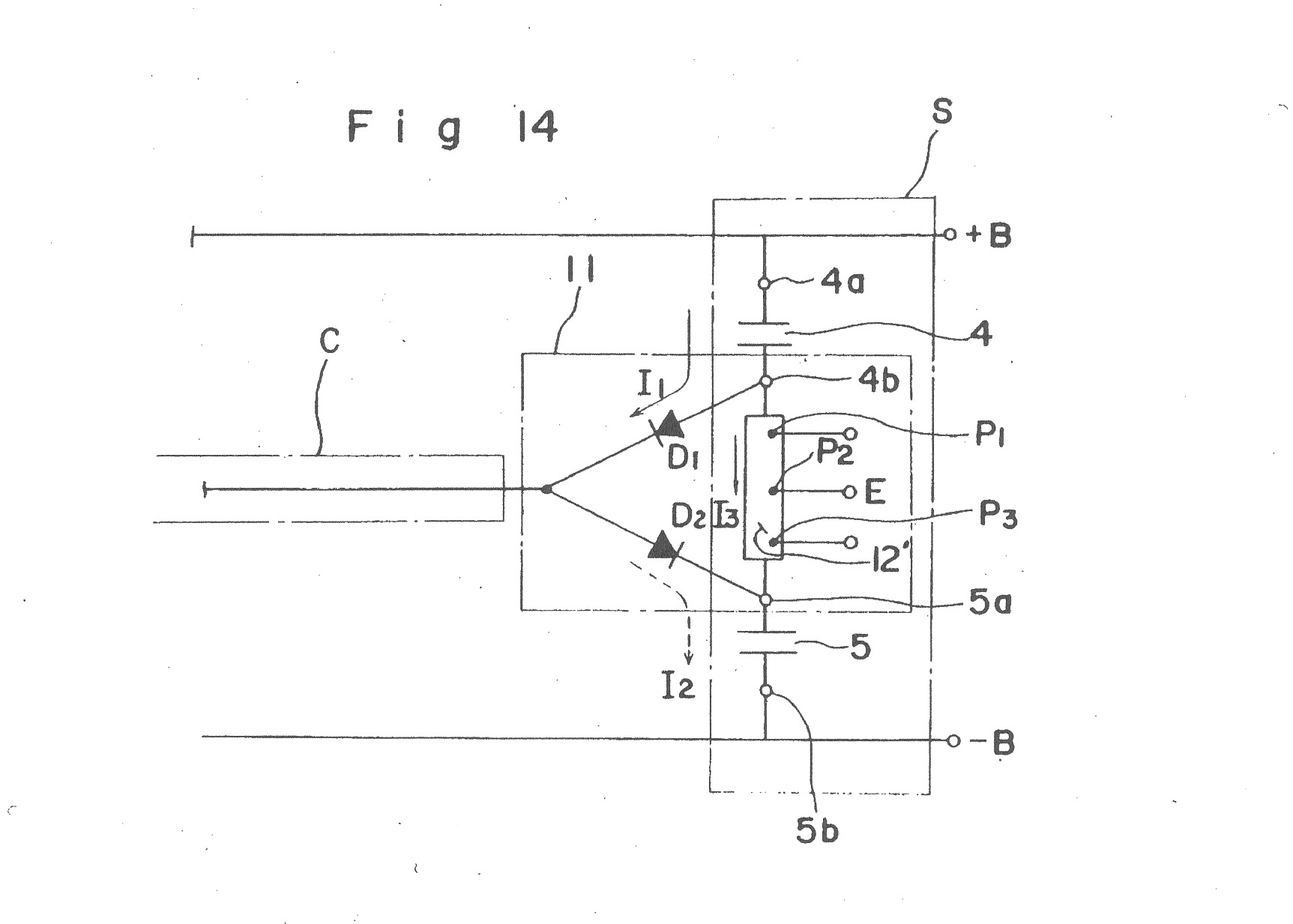

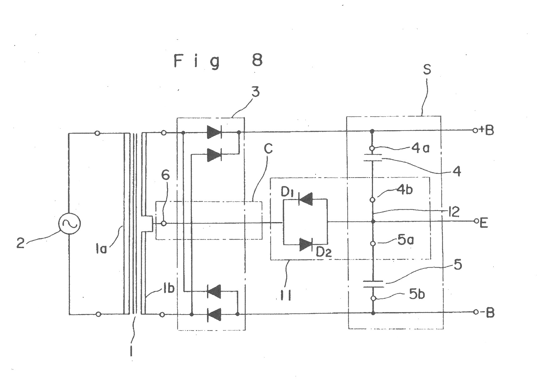

Researching for a dual PSU schematic I found a 1985 Patent by onkyo:
Rectified and smoothed DC supplying circuitry - Patent 4555751
They invented a smoothing circuit between the transformer's center tab and the rail where the smoothing caps are tied together. This circuit - #11 in the attached figure - is made from two antiparallel diodes D1 and D2.
I've never seen a schematic that include this simple device. Does it make sence? What type of diodes are the best for this job?

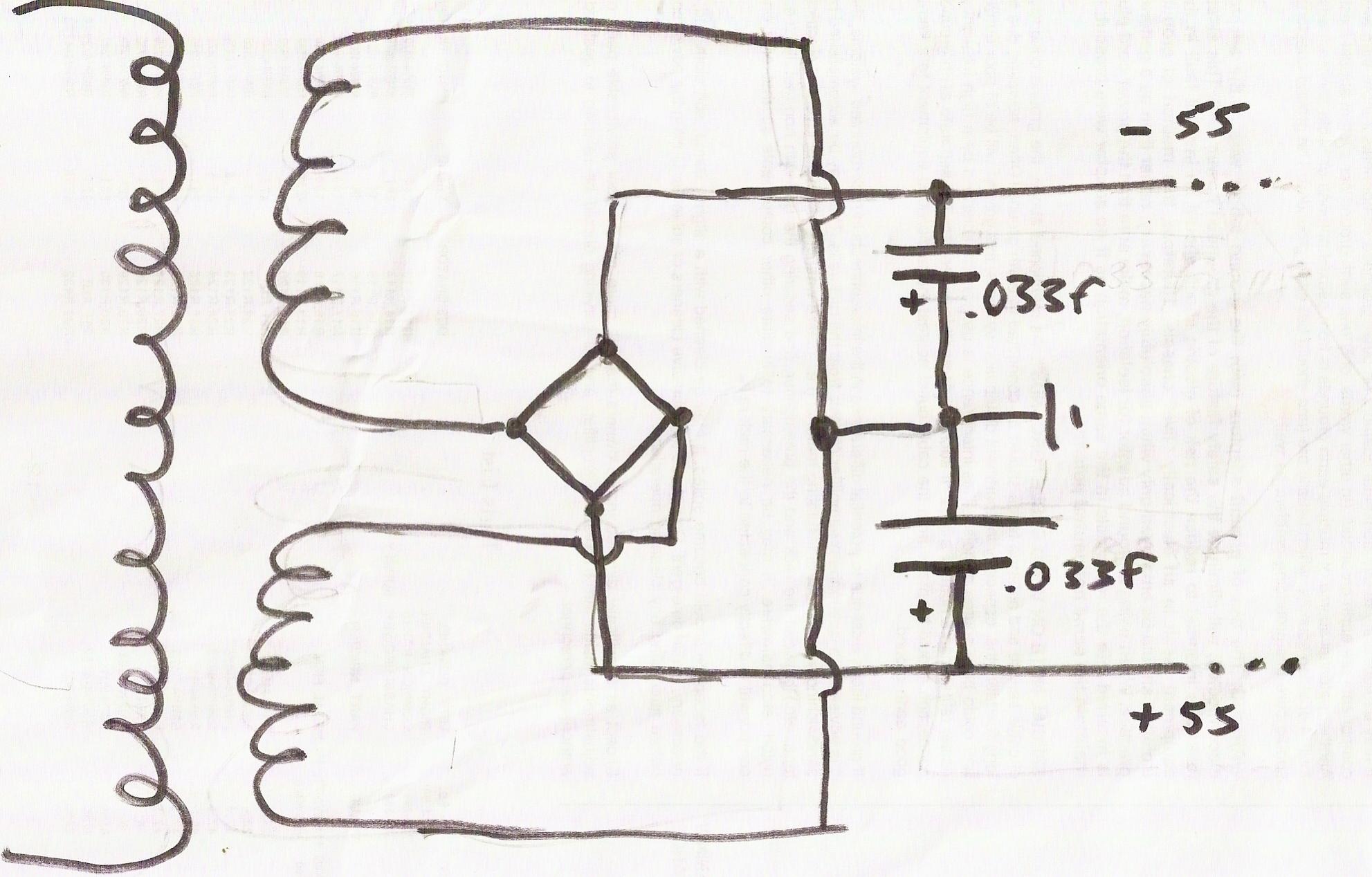

After reading thru this thread several times and studying the diagrams I feel ready to plug in my soldering iron and get busy. I hope to use that copper bus idea.
I have two Belles 1 power amps. I'm sure the 25+ year old filtering could stand some "freshening." While I'm at it kick the PS performance up a notch or two. I think my power amp has dual secondaries.
Do the above:
w/a bit more capacitance
2 bridge rectifiers, one for each channel
4 filter caps, 2 for each channel
better filter caps.
I welcome your input for new filters-skinny caps w/screw tops please.

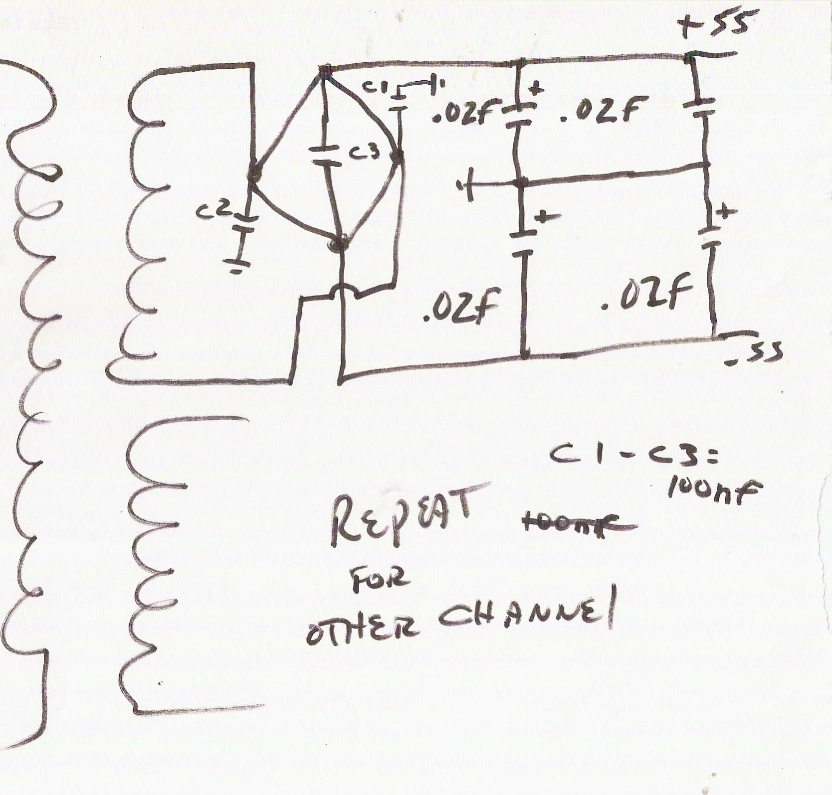

I'd like your opinion on whether I'm on the right track. Please take a look at my crude drawings (attachments). I apologize for not drawing diode bias.
Attachment 1 is the existing PS* for both channels using 2 Mallory 33Kuf 50V 65V surge filters w/ the no-load rail voltage per DMM. Near as I can tell its NOT center tapped. Yeah that's it. 2 Huge** filter caps & transformer; 1 bridge rectifier.
* add'l filtering on PCB, unknown. Belles won't release schematics
** huge compared to Hafler's
Attachment 2 are the mods. BTW I want to get the big stuff right first. I drew in early a few small improvements. Will add more bypass caps and an RC network.
Later replace the single transformer with 2 toroidals each w/dual secondaries &, if space permits, add 2 more bridge rectifiers & more filtering.

you cannot use a bridge rectifier to create a dual polarity supply from one secondary winding.
a.) If you have a centre tapped transformer you can use a single bridge to create a dual polarity supply.
If you have a dual secondary, you have two ways to create a dual polarity supply.
b.) convert the dual secondary to centre tapped and proceed as in a above.
c.) create a single polarity supply from one secondary winding using a single bridge.
create a second single polarity supply from the other secondary using a single bridge.
Connect the two single polarity supplies in series to creat your dual polarity supply.
