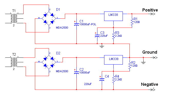

Thanks jack. I understand National's consideration for two smaller transformer. However, I am not able to follow your point on regulator. Any two regulator could be used with common ground, it really does not require two secondaries. or am I missing something.
Morever, I was comparing dual secondaries with bridge vs FWCT.
centre tapped can produce a dual polarity DC supply. The regulators MUST be +ve type for the +ve rail and -ve type for the -ve rail.
Dual secondaries can produce either a dual polarity supply with a common 0Volt and follow the centre tapped topology.
or
give two independant DC supplies which can each be regulated with any combination of +ve or -ve regulators.
Then the resulting pair DC outputs can be connected to form a dual polarity supply.
Like so -- with the appropriate resistor values for your app:
