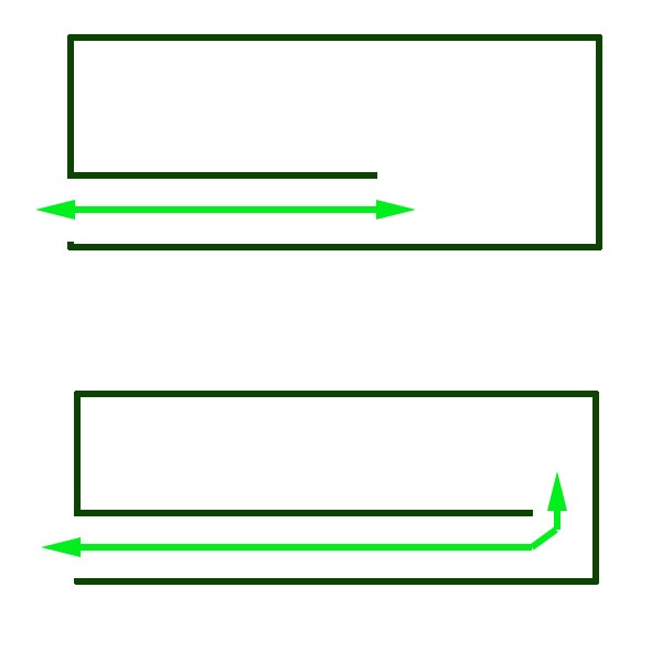

I'll take a crack at this; yes absolutely you can use walls to your advantage. The exact same effect happens inside the box when a port gets close to an internal wall. In the slot port example picture; when the port gets close to its own height away from the back wall, the effective length suddenly gets significantly longer, because the port effectively extends up the back wall as well. (The exact shape of that line is based on what is called the 'advanced centerline method' for calculating port lengths around folds, fwiw)

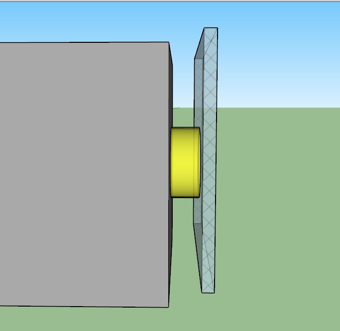

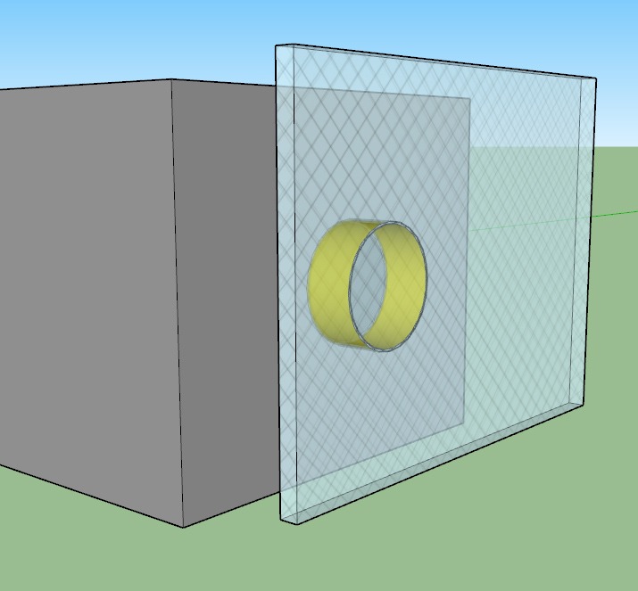

In my round port example (it's a little hard to see but it's supposed to be a round port in the middle of a gray box, firing against a solid wall of safety glass (so we can see through it)), the goal is to put it at a distance from the wall where the area of the (imaginary) yellow shape (a cylinder with no top or bottom) is equal to the cross-sectional area of the port. Any closer and you would be creating a tapered port; any further and you don't get the effect. This can be done inside the box as well.
That is about the most you can gain from a simple controlled wall offset.
To get a significantly longer effective port, you kind of have to build a slot port without one outside wall, and then plan to seal it pretty tightly against something. Which I believe is the challenge. And all you save is the material from one outside wall.

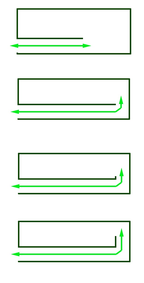

I agree! I added another picture to clarify where the 'extra' comes from... It's just an L-shaped slot port where the short leg length is zero.
