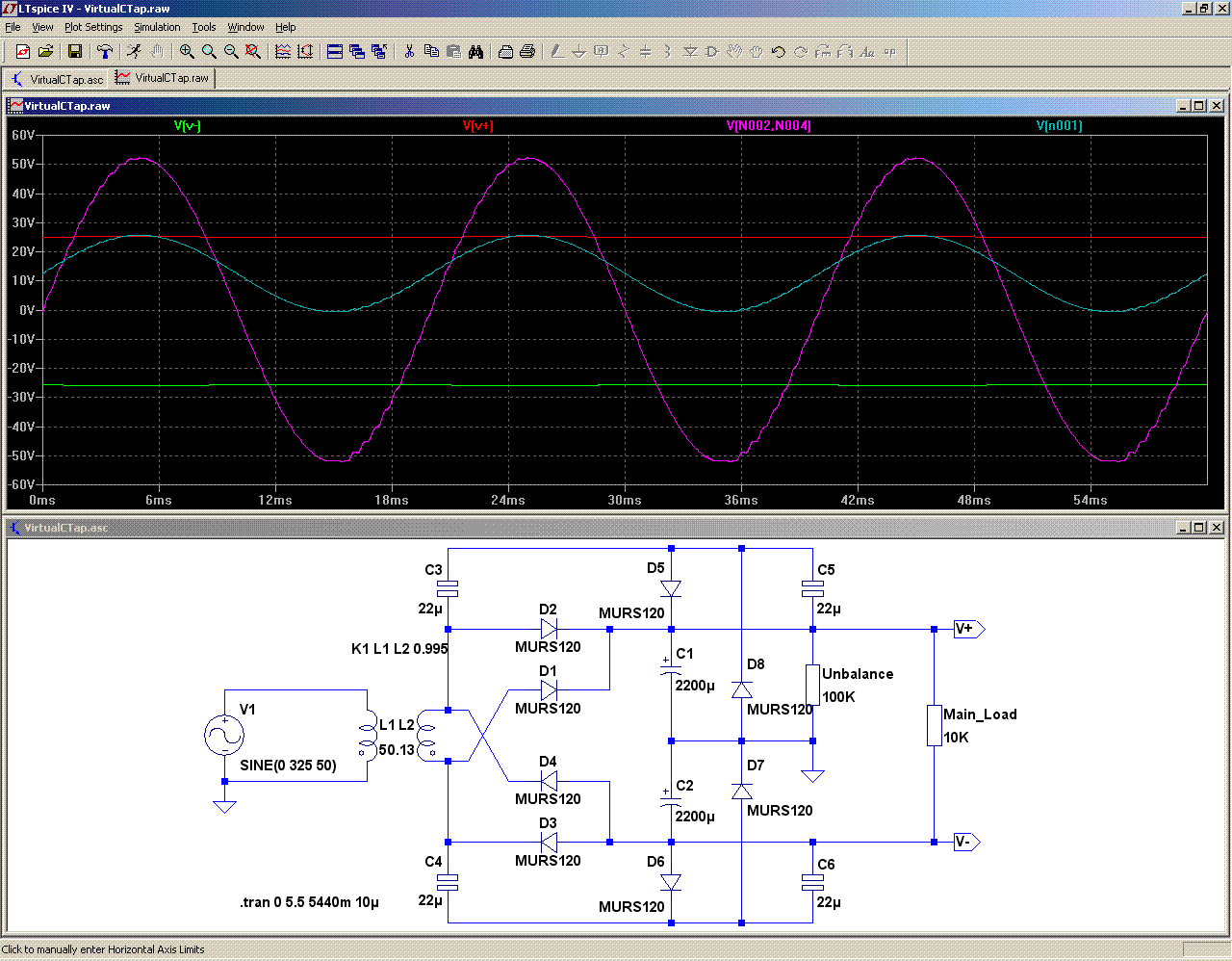

Yes I know.One thing that might be a problem with that circuit is that with low load current, the output voltages can rise up to double the normal value.
In fact, this version is not the raw circuit I initially came up with.
After some thinking, clean-up and optimization, I arrived at the conclusion that I could spare two bulky mylar caps by using implicit capacitive dividers, but at the cost of a doubled no-load voltage.
In general, it shouldn't be a problem, but here is the non-abridged version, for cases when the light or no load condition has to be taken into account.
With 4 big caps, it isn't very attractive from a practical point of view.

if you want to get dual polarity supplies out of a single secondary winding then this is what you need...
to get dual polarities out of this, make the junction of transformer lead B, C1 and C2
your 0 volt reference and take output voltages at the other ends of C1 an C2......
the circuit shown is a full wave voltage doubler type so transformer utilization will still be quite good...
