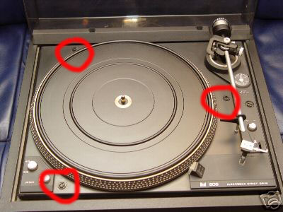

Hello,
I have received my CS522 today. Beautiful. I would like to open chassis for add "blackson" (asphalt), would like to change DIN connectors for Gold Chassis RCA and If I can, change boxe by a wood heavy box.
But my problem is that I don't know if this turntable could be open and how to open it, I don't see screws and bolts on the bottom ?
Does somebody know how to open it ?

To open a Dual TT, you have 3 screws on the of the chassis.
Formy 606 it looks like that :
I thinks it's the same for your CS-522:
http://www.compassnet.com/concept/tables/522.htm
To remove the chassis you have to turn out the 3 screws. After that press the chassis mounting scrows and remove the chassis from the box.
Alex
