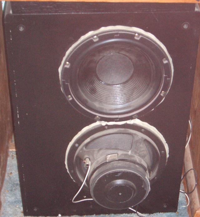

Dual opposing drivers cancellation issues?

90° at 200hz at a normal -20dB (or greater) levels is no problem what so ever. This assumes a sub driver with a very low Le, and a normal receiver 120Hz xover. It will effect things with the magnitude of a fraction of a dB at most. 😉
Most drivers begin rolling off on their own above 80Hz due to higher Le, so most can add another +4dB of loss easy.
This has nothing to do with a mid driver. 😕
The sub will act as a true monopole throughout its intended passband. No (extra, IE non-room) phase issues. As long as ka<1 there will be no issues.

Now we are moving away from polar response phase issues into crossover issues which are a separate topic.
The xover I posted was the default for most all receiver/pre pro units. (It also happens to be the LFE channel bandwidth top end.) That is why I posted it. 🙂 Using defaults he would be fine. If he used the 100Hz from the OP 200Hz would be +/= 24dB even better.
I would personally never use a mono sub with redistributed content above 80Hz when SQ is a factor.
