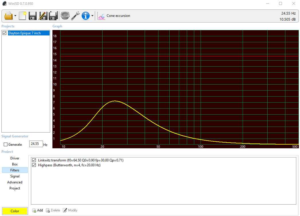

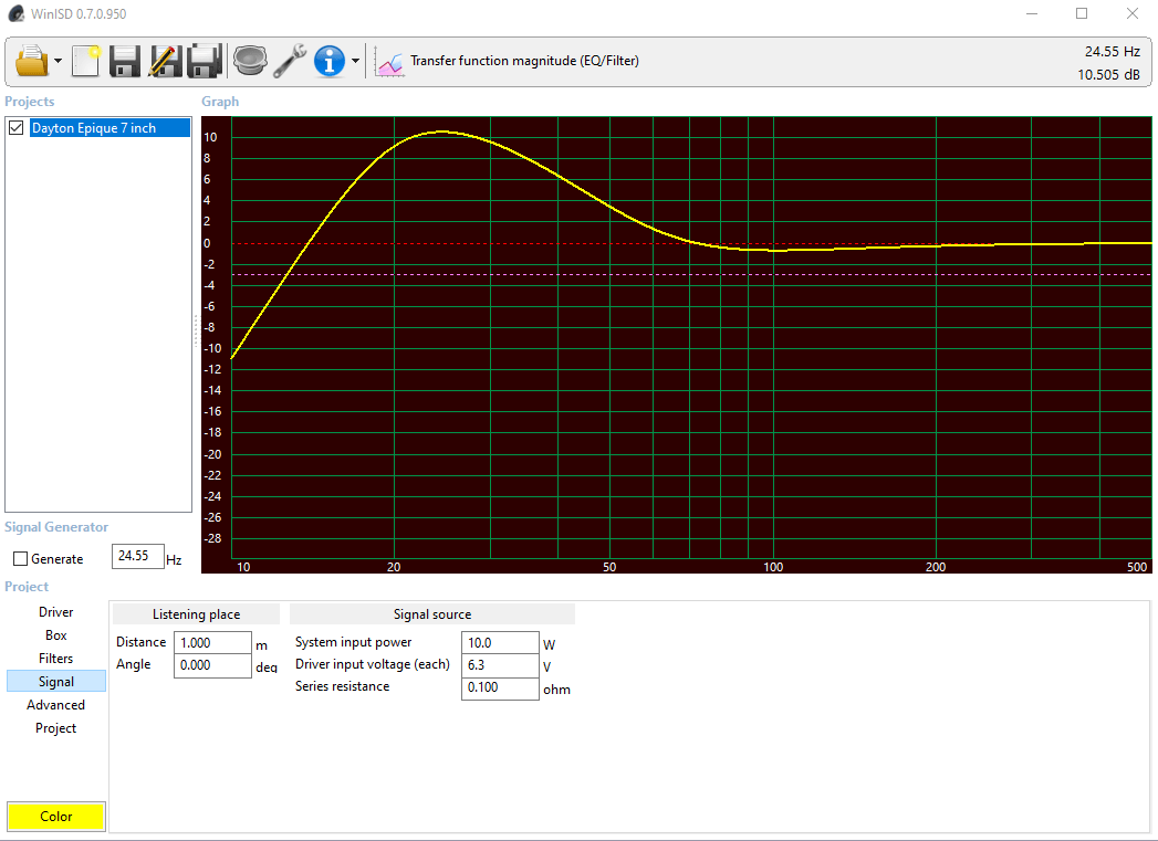

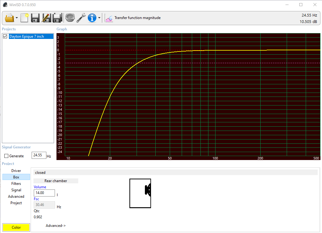

@tsardoz, when you input the driver's Znom in place of Re, was that a deliberate strategy to compensate for the additional series resistance of wiring, or just a mistake?
It's just that, if the former, an extra 1.2Ω is rather a lot - most people use 0.5Ω. You'd only need to use 1.2Ω if you had exceptionally long, skinny speaker cable, which isn't a good idea.
Also, rather than hard-coding that into your driver record, it's perhaps easier to put it in the "series resistance" field in the signal tab, that lets you get at it to see the effects of different values a little more easily.
That being said, it only makes <1dB difference to your model, which you could easily tweak with adjustments to the LT.
@GM, not sure what you mean about needing a new "system" file, the latest version of WinISD (0.7.0.950) runs just fine on Win 7, are you using an older version perhaps? That being said, I can't remember if there were any compatibility issues between older WinISD project files and the current version or vice versa, it's been so long since the current version came out.
Anyway, here's a few screengrabs:

If you mean these 7" Epique, then at a glance see no reason why they can't be dual opposed in 20 L net sealed @ ~0.75 Qtc, though will be somewhat under damped if much power is used due to VC heating, so finding the right EQ compromise could be tedious unless there's some sort of dynamic EQ gizmo available nowadays.

Hmm, poorly worded + didn't complete the thought, i.e. 'haste makes waste'
......... "will be somewhat under damped and will be much more so if much power is used due to VC heating raising effective Qts of an already fairly high Qts driver"
Passive radiators need to be at least 1.75x effective driver area (Sd), so need at least 10" based on the (Sd) of a couple of Dayton 8", which might not fit on the box and FWIW, PRs don't sound good until tuned down around 14 - 16 Hz IME, though used dual 12"/15" on one pair and dual 15"/18" on the others, so could just be due to their ability to pressurize most HIFI/HT rooms.
