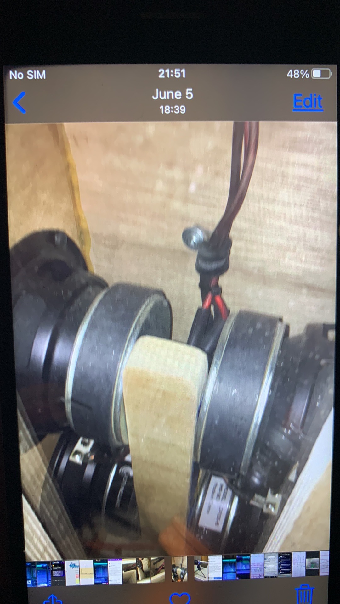

If you directly mount two magnets back to back, it's a ridged, solid connection, if you don't, the chassis/enclosure will act like springs and you'll end up with a tunning fork - this effect is so pronounced that when I connected to opposing magnates together with a 20mm dia, 200mm long steel bar (with threaded studding going through the whole lot) I ended up with a "zingy" sound, when I removed the steel bar and used the enclosure to connect them it still remained, only cured by adding baby-belle red cheese wax to the gap between the pressed steel chassis and the magnet, which damped the vibration; in this application I was using the drivers full range, perhaps if the were just used for bass the resonance would be too far away to cause a problem. On my packing case speakers, I used a little bit of foam between the magnet and an internal deflector to dampen chassis/enclosure vibration, but without testing a with and without, it's difficult to access how effective it is. Car speakers are often derided, but the coaxial ones do have the advantage of a hole through the pole piece, that's handy for bolting the magnet to something.
