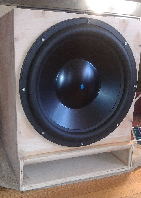

I have an outdoor gig coming up in about three weeks. I currently have two 15" slot ported subs tuned to about 35hz. Would it be worth while to attempt to strap them together like this with spacers, what would be the benefits...?

If the cabinets loose frontal area when the cones are pointed at each other the output will be less. Big baffles are good.

Right, but I mean by combining my subs similarly to the first post in this thread...I would think it would lower the extension at the expense of sensitivity.

Yes, if your plan effectively doubles the length of the ports, Fb goes lower, extension at the expense of sensitivity.Right, but I mean by combining my subs similarly to the first post in this thread...I would think it would lower the extension at the expense of sensitivity.
Without a picture of your cabinet design in whatever configuration you are thinking of, have no idea what would occur.
It would effectively be the same as the pic above vs. a pair of coventional slot ported subs....

Tip it on it's side, face the pair driver to driver about 4-5" apart, then wood on the gap on 3 sides. Figure it must more or less extend the existing port by about 16", or about 60-70% longer.
And if you put the drivers to the rear, ports at the front, it won't extend them at all.![]()

Just curious what my options are. I would think that simming a 60-70% longer port would be about right.
I'm already working on plans for some ghetto barn doors / horn extension. Any comments on aping the funktion-one infrahorn extension, with three panels of plywood?
http://www.funktion-one.com/products/infrahorn/
Go for it, but don't expect much more than 3 dB gain.Any comments on aping the funktion-one infrahorn extension, with three panels of plywood?
