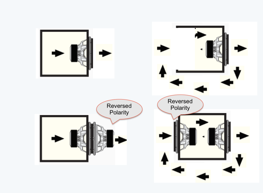

Hello all, I have been lining up a number of projects at the modelling stage waiting for when I can start setting up the home workshop tools with the final bench stand being setup today. Here is the last one in the set of items of interest that I have acquired most of the recent equipment for. I have two identical 7" sub drivers that will go into this 300x300x300mm sealed cab. Most curious about all the possible wiring configs....... to hear and measure graphs for to learn about such things. Especially interested in when both drivers move together as if connected by an electronic pushrod and very curious about also repeating those tests with a shorter bandwidth on one driver biased low
Predictions? Thoughts? Anything folks would like added to the tests?

Reversing the polarity of one of the drivers, making both drivers move together as if connected by an "electronic pushrod" would cause the pair to exhibit a dipole response, but with the displacement of a single driver.
The comparable monopole (both drivers wired with the same polarity) has a flat frequency response (0 dB), whereas the dipole rolls off at -6 dB per octave.
To maintain constant sound pressure level (0 dB) the monopole displaces four times (+12 dB/oct) the air volume for every halving of frequency, but the dipole has to have eight times (+18 dB/oct) the displacement.

The left side of the illustration below depicts a monopole "clamshell" isobaric loading using two drivers face to face, the exterior driver's polarity is reversed, positive voltage moving the cone forward. Since the two drivers function as one, the displacement is the same as one.
The rear opposite polarity rear output of the driver is enclosed in the box, and does not interfere with the front output.
The right side of the illustration shows a dipole, the box open on the back. Much of the front wave wrapping around the cabinet destructively cancels the opposite polarity rear wave, so it's output is reduced by -6dB compared to the monopole.

Just as in the "clamshell" arrangement, adding a second speaker to the enclosed box with it's polarity reversed is virtually the same as the single driver dipole- there is no more air displaced than a single driver.
It seems in a probably flawed misconception types thingy that a motor on the second unit will drive that diaphragm back cleaner than the passive?
A passive radiator is primarily "driven" at Fb, the resonant frequency of the box/PR, and same as in a ported box, the PR Helmholtz resonance is in phase, but one cycle behind the driving force.
A second active driver's output with it's polarity reversed is not "driven" by resonance.
The air in it's sealed box is not compressed, so the polarity reversed drivers won't require as much power to be driven "clean" to full excursion, though full excursion for the pair won't result in as much output as as a single driver in the same sealed cabinet.

Thanks for the pics man. Let's take the last one, that represents my screenshot. Do you have a drawing of that second driver being passive and the arrows showing the interaction for that?
An active driver will move in the direction of the electrical signal, normally a a positive (+) signal to the (+) terminal driving the cone away from the magnet. If the polarity is reversed (+ to -), a negative signal (-) drives the cone away from the magnet.
A polarity reverse shifts the cone's direction of motion 180 degrees at all frequencies.
A passive radiator has no polarity, it's movement distance (excursion) and direction (phase) varies with frequency relative to the driver.
Arrows showing the interaction by frequency would look like this: ^ (0 degrees), > (90 degrees) v (180 degrees), < (270 degrees),^ (360 degrees).
Driven at the box/PR resonant frequency, the PR is 360 degrees behind the driver, but "in phase"- the arrow points in the same direction.
