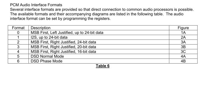

automatic DSD\PCM selection
another Japanese site with audio kits including dual AK4497 and ES9038PRO over here
The boards there has a separated PCM and DSD inputs. As well they doesn't automatically switch between PCM and DSD, need manual selecting.
It's possible to use their SRC front end, but reclocking everything to a fixed frequency or DSD isn't a good solution at all.
Any suggestions?
The AK4490/4497 do not support automatic switching between PCM and DSD. You have to know what kind of signal you will be converting and use a uC to set up the DAC accordingly.
As I recall, I'm not sure that is quite right. I think the AKs will auto-switch between incoming PCM and DSD in 'normal mode' but if you want to use the 'Direct DSD' mode you need to select it via the menu and that turns off the features of normal mode, such as the auto-detect, volume control etc.

According to 4497 datasaheet, DSD is not available in parallel mode (hardware setup) as for AK4495. In serial mode (software setup) DSD/PCM switching require a change on a internal register and a soft reset (another internal register).
So the uC which is steering the DAC needs to know weither the stream is DSD or PCM, and this information is not provided by the AKM DAC chips. For example this information is available on USB adapter Amanero connector pin 7 or JLSound I2S2USB pin 8.

I'm pretty sure that (at least the 4490 that I'm playing around with) it does not, Ray.
In parallel mode (a.k.a. with no uC) they do not support DSD at all. In serial mode (I2C or SPI control) they do support DSD but you have to change a register in the chip. Otherwise DSD produces garbled audio. It doesn't matter if you choose normal mode or Direct DSD (but if I remember correctly, if you have selected Direct DSD but have set the DAC in PCM mode and sent it PCM, it outputs garbage).

Is there *any* chip that can auto-switch between PCM and DSD? I am pretty sure that there isn't, but would welcome a correction!
As far as I know, PCM and DSD are raw data stream, they're mainly aimed to be D/A converted or digitally filtered. Raw data means that they're only what is called the 'payload'. There's no framing, preamble wich usually contains the information describing the nature of the payload. So the DAC has no practical way to decide weither it is PCM or DSD (or anything else...). This is why DSD/PCM detection is made at previous stage where the framing informations are available: at the USB level or within the DSP, etc...
I found nothing in the AK4497 datasheet about a output that tells you if you have a PCM or DSD digital input.
I really don't know how you can switch from one mode to another if don't have this information.
As showed above, you have separate inputs for DSD mode when DSDPATH=0 : DSDL, DSDR and DCLK.
You have also to setup the DSDPATH to 1 for identical inputs.

I hadn't noticed that the 4497 had separate pins for PCM and DSD.
That is very annoying.
Most (if not all) USB interfaces have a single combined I2S/DSD output. That will have to be split in two, and possibly buffered.
Most if not all USB receivers provide a "DSD signal" pin.
