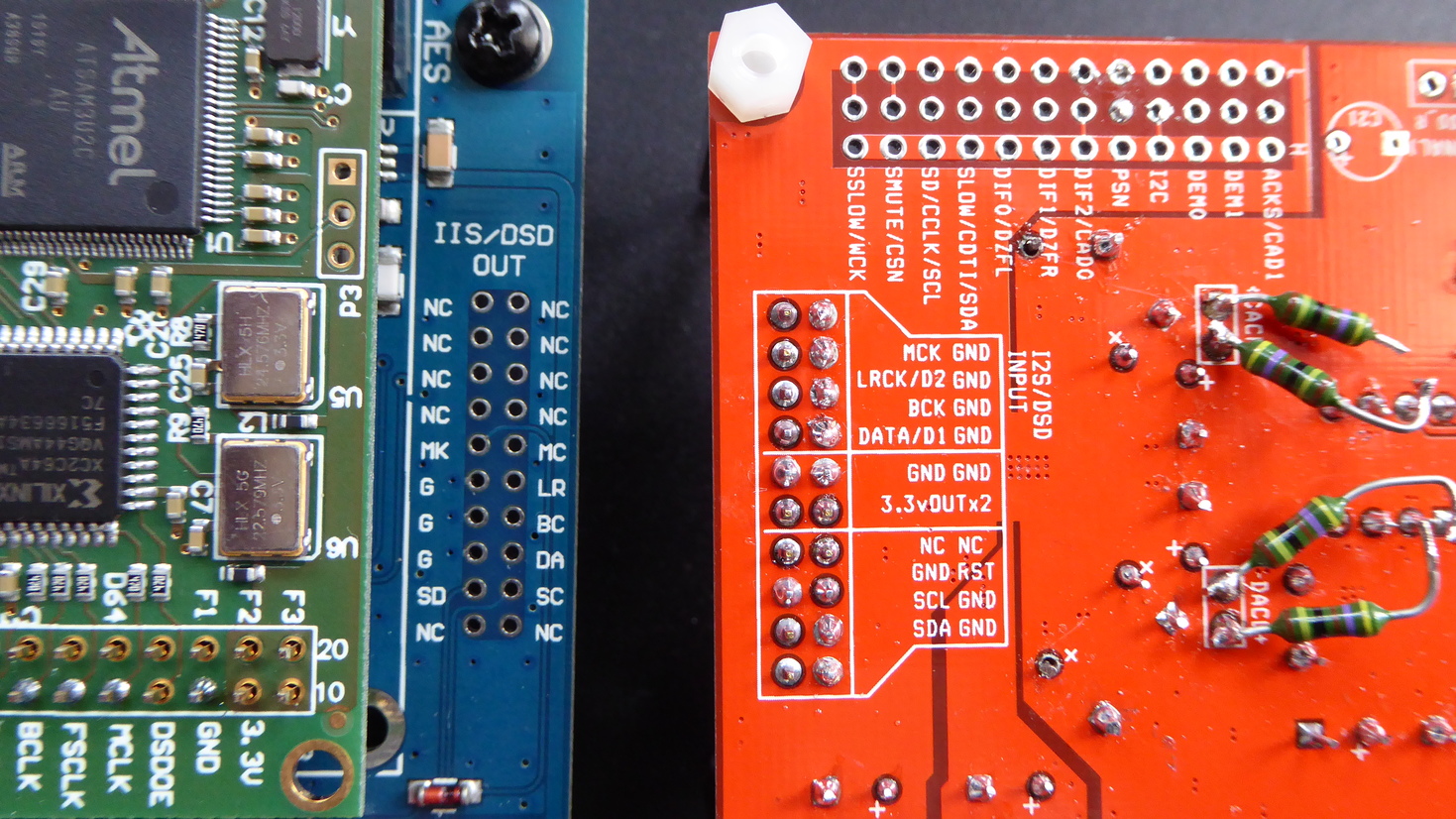

I don't own dac board from same designer, my plan was to try to wire it with diyinhk ak4490eq dac board(datasheet implementation).
I guess software codes should be the same...

The input selection should work anyway as it's just a matter of connecting the i2s output from the 4118 to the dac. The codes being sent by i2c should be the same but i'm not sure if there is something else which might prevent it from working with the diyinhk dac for filter and volume control. I suppose the only way to tell will be to put the diyinhk board into software mode and try it.

I do. Everything that you need to remember (if you want to use the "online" version with volume/filter/DSD control) is the right configuration CAD0 and CAD1 pins of AK4490/AK4495.Has anyone tried one of these boards with another brand 4490/4495 board?

Anyway I'm willing to try to wire it up to diyinhk board, I think I can trace lines from pictures that kukynas generously shared.
Do you have idea which chip has MCU function on your board?
There is no need to trace the lines the board is marked with a legend that describes the i2s and i2c pin out.
The MCU is the large square chip nearest to the shrouded JTAG header.

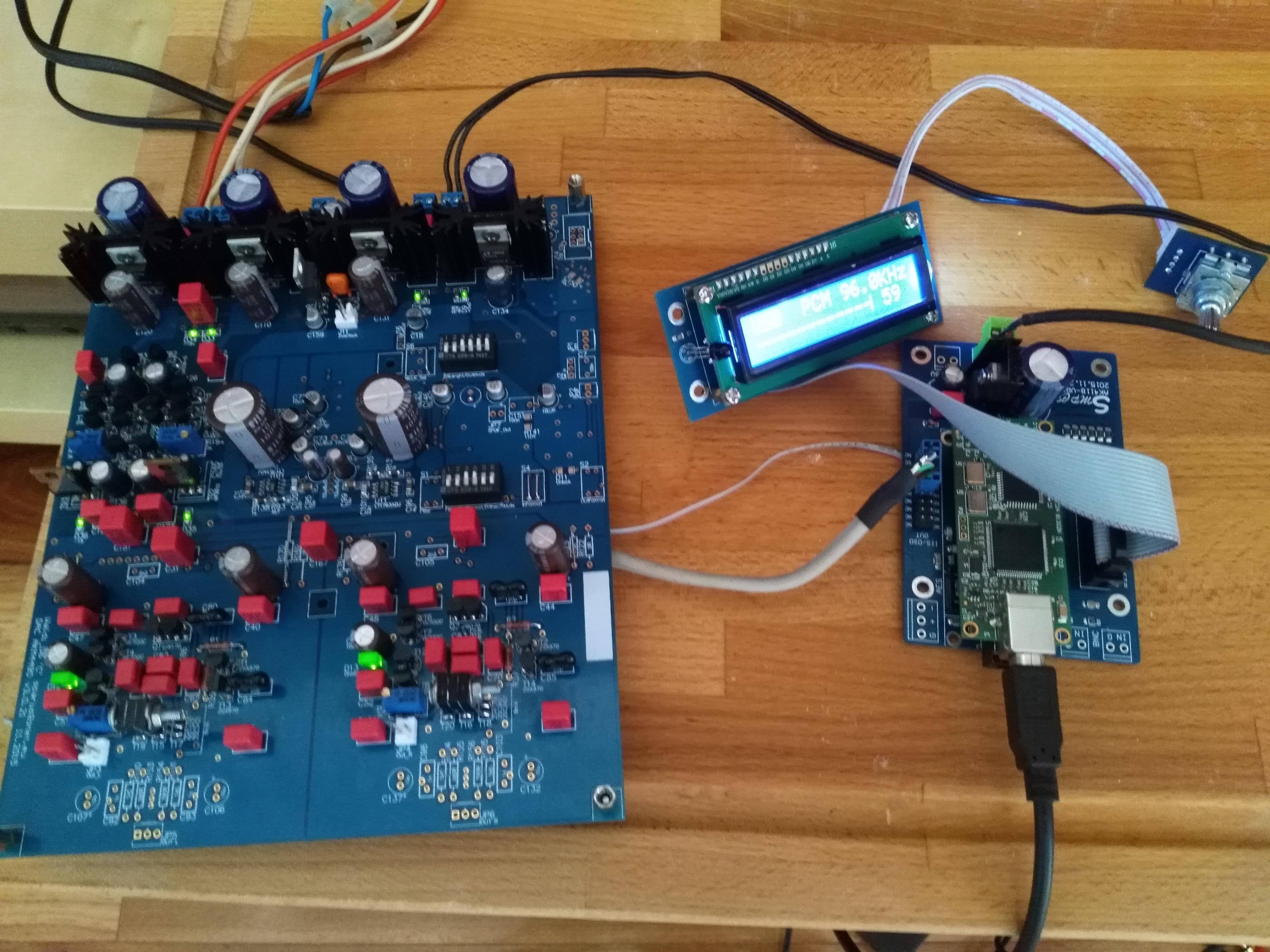

Finally had the time to replace the AK4137 board with the AK4118 board and got a noticeable improvement in detail and timing.
So bottom line , the AK4118 board is cheaper , better sounding and offers remote control and one additional filter (super slow). You loose SRC but imo this feature introduced more problems than it solved.
Boards work in online mode with jumpers 10 and 11 shorted.

Could someone confirm I'm going to wire it up correctly?
NC > NC
NC means no connection, you do not need to connect those in case you were going to😉

The 4118 and Dual 4495 boards are very simple to connect with a 20 pin ribbon connector. Use the jumpers to close J10 and 11 for online mode as has been stated before. That's it. Connecting your xmos to the i2s inputs might be more difficult as it is designed to use an amanero size board stacked on the headers.
