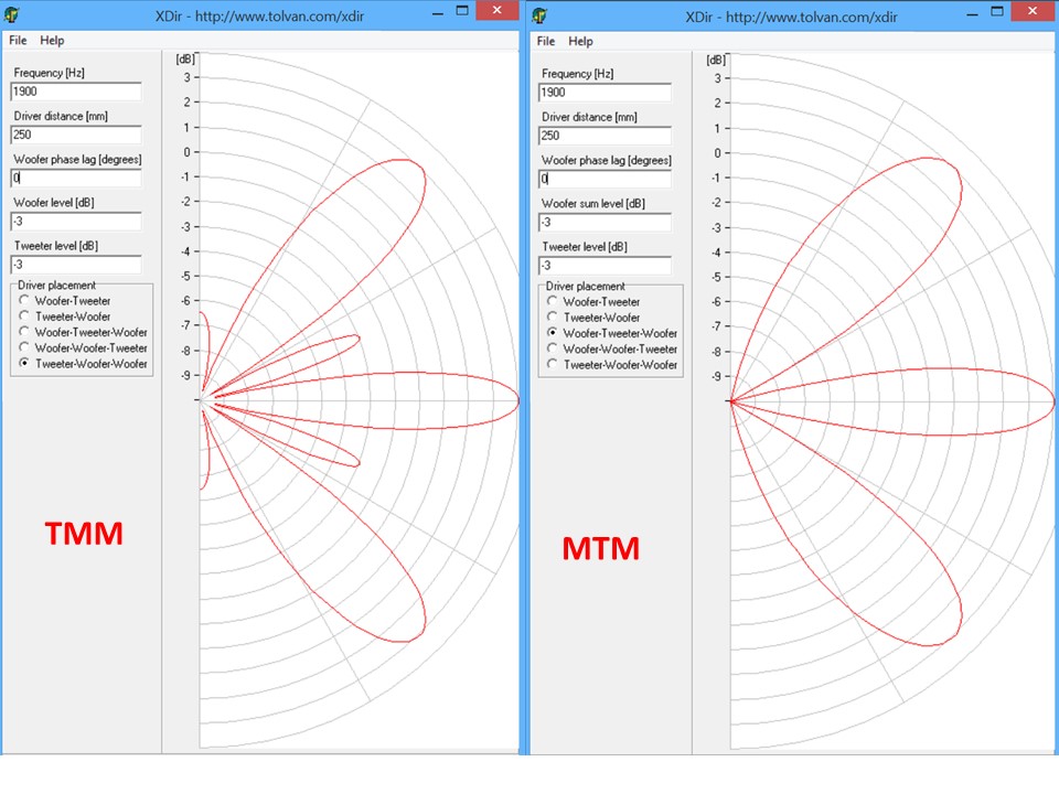

Dual Midrange - Vertical or Horizontal Alignment
I have not purchased the mid range drivers yet - will be using the SB Acoustics MW13P-8 which is a 5inch driver. Shadders.
A properly designed MTM using 5" drivers should produce a listenable main lobe.

Active crossovers cannot fix edge diffraction effects, or MTM / TMM mid-mid lobing effects. At some listening angles, a pressure wave on one midrange cone point will combine with a reverse pressure wave from the other midrange at the listener's ear and generate a null. Even with active xovers, there are good reasons to build a 3-way TMW with attention to cabinet diffraction(bevels, rounds, tweeter offset). Great white papers from British engineers at B&W and Vivid.

Hi LineSource,
Thanks for the write up and link - i recall this software site tolvan, so will have a play with the programs.
I have some basic books - but this site should allow to see the results of what is referred to in the books.
Thanks again for the information.
EDIT : I had a play with the program - as expected, the optimal listening position is in the main lobe direction. The datasheets only provide the dB loss with respect to frequency and 30deg and 60deg offset from the driver centre. From rf work, as expected, the higher the frequency then the more focussed/thinner the main lobe becomes.
Shadders.
