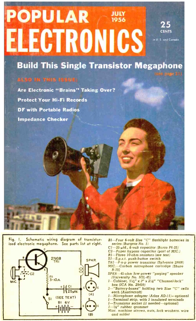

> Low power and maybe low efficiency as well.
The maximum efficiency of resistor-loaded audio amplifier is 8%. And it idles hot. An AB amp like LM386 can exceed 50% efficiency and idle hardly-warm.
The sound quality is known from the 1950s when this was leading-edge.
