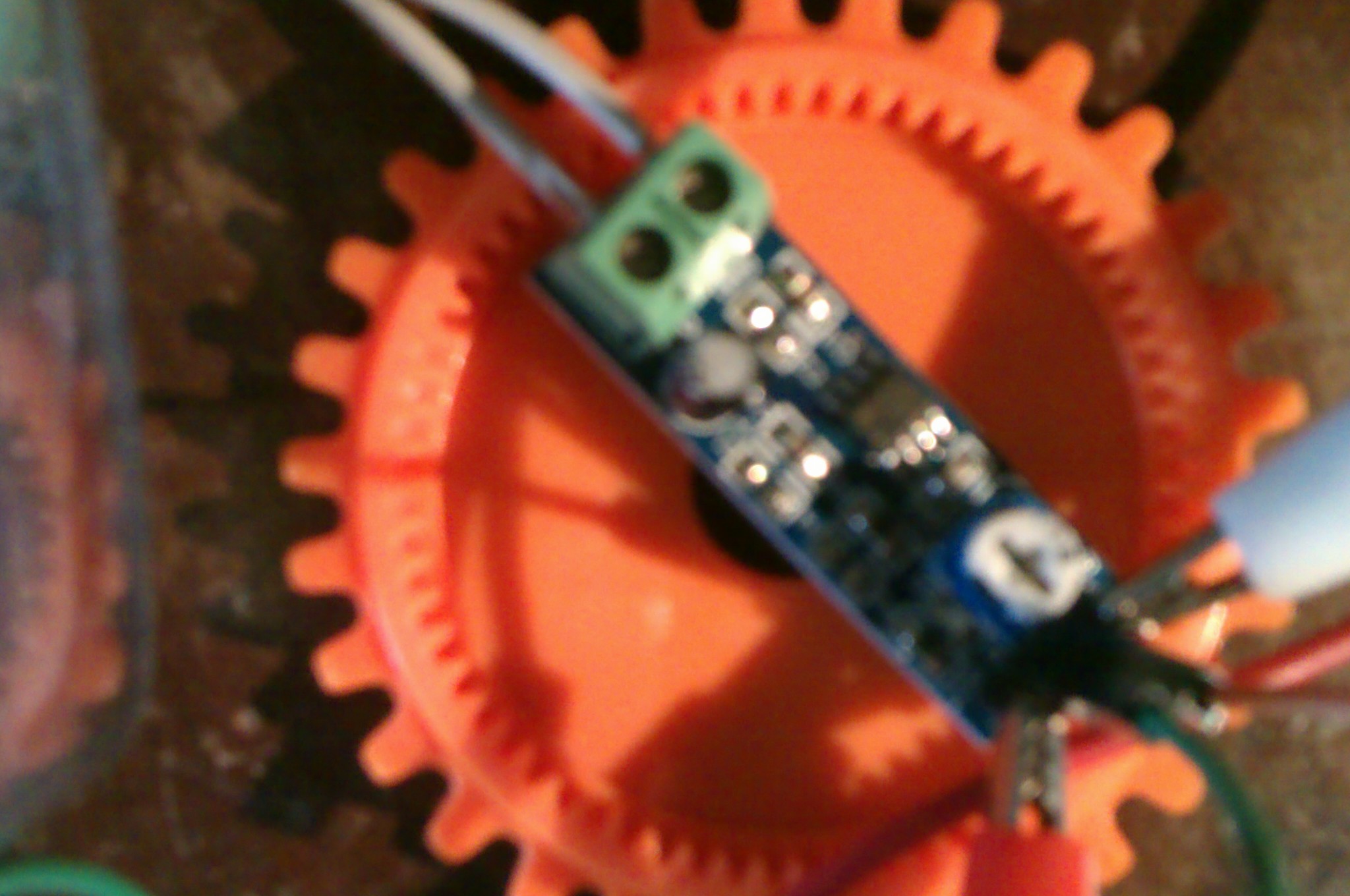

At first listen it sounded harsh, and a little bright. I connected it to my open baffles and then to a large Sony mini-fridge type speaker, the ES 333 or something. Without any amplification (yes I tried that ) there was hardly any sound but with the amplifier the music was soft, distorted and muffled. Maybe it was the source, as CD-derived track and Deezer type streaming sounded better. It plays quite loud 70dB at 10 cm from the speaker front.
Sorry for the blurry pix - actual setup. There is a nice clear description of the lm386 here:

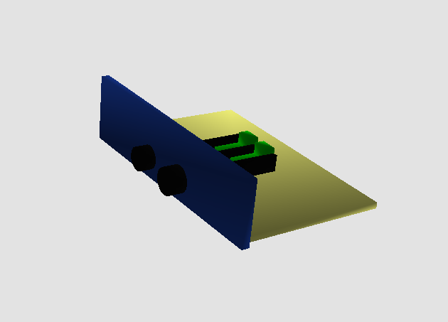

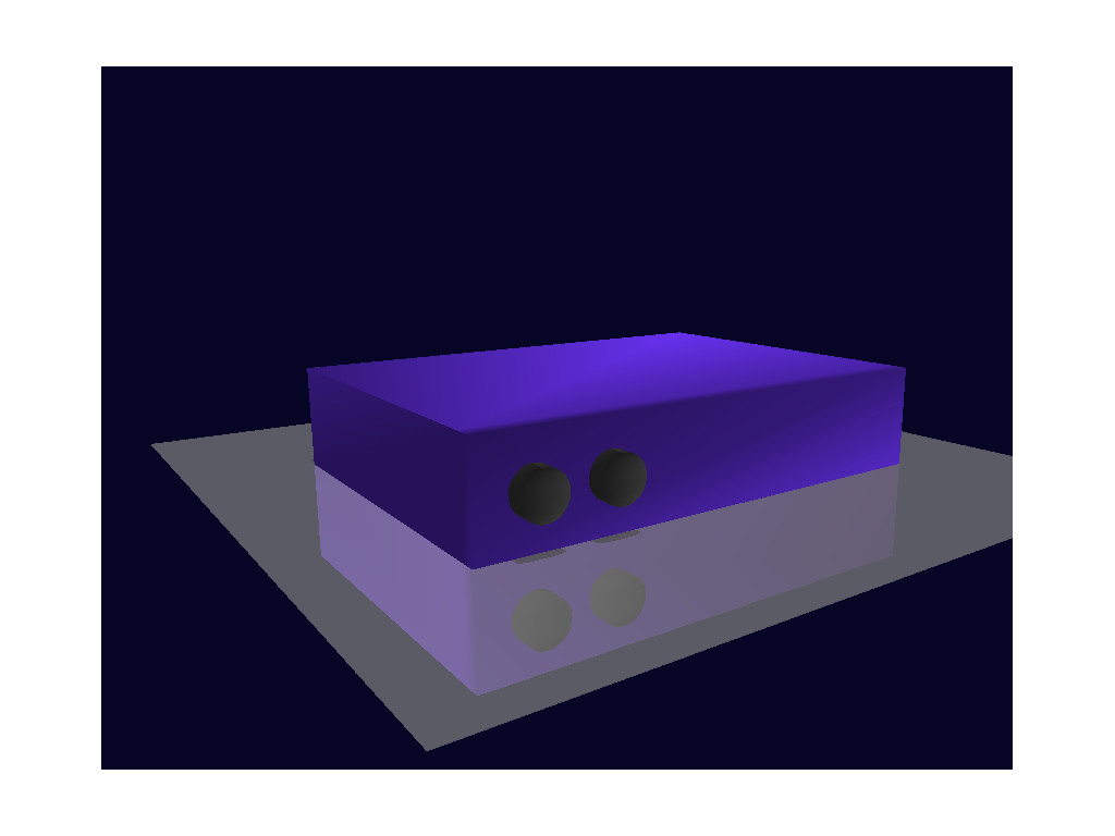

3D Design revision
Updated design. (Wings 3D). Apart from placing the boards, I have to add the volume controls and tone controls, as well as the connectors.
An external Bluetooth adapter is definitely in the cards, and will there will be a slot in the case for that.

LM386 is a low power amplifier, a fairly old class AB design with less than 1W output and high distortion. It's really for things like clock radios.
I think you will have better results with PAM8403 which is a newer class D and has 3W output.
But I would instead look to the TPA3116d2. Modules can be had cheap and this chip is good for 50WPC with the right power supply. With a modest 12v supply it's good for 15W or so and with very low distortion.

I bought these years ago when I was searching for options to build an amplifier. Finally settled for salvaged PC speaker amp, but I just took out the lm386 the other day to see how it sounds. I am quite satisfied with the detail in that thing, and the punch. I tested it out with the SONY ES 333 large speakers and plays acceptably OK but the phone has to be turned up to full volume, a line out from a CD player would give better power, even a PC headphone out should have more power. Now that I have it might as well use it: use what you have.
One lesson I learn is that the amplifier and speaker must match, must be tested and work together.
The PAM8403 has higher power, but I am really worried about the class D switching design. The other class D amp I used was the Lepai and that was terrible, loud but empty sounding and I gave it away. That was a class D as well.
Lets see if it is too small to connect using crocodile clips, nothing but testing them out to see how it will sound.
Edit: Crocodile clips just fit, so I will go ahead with the test.
