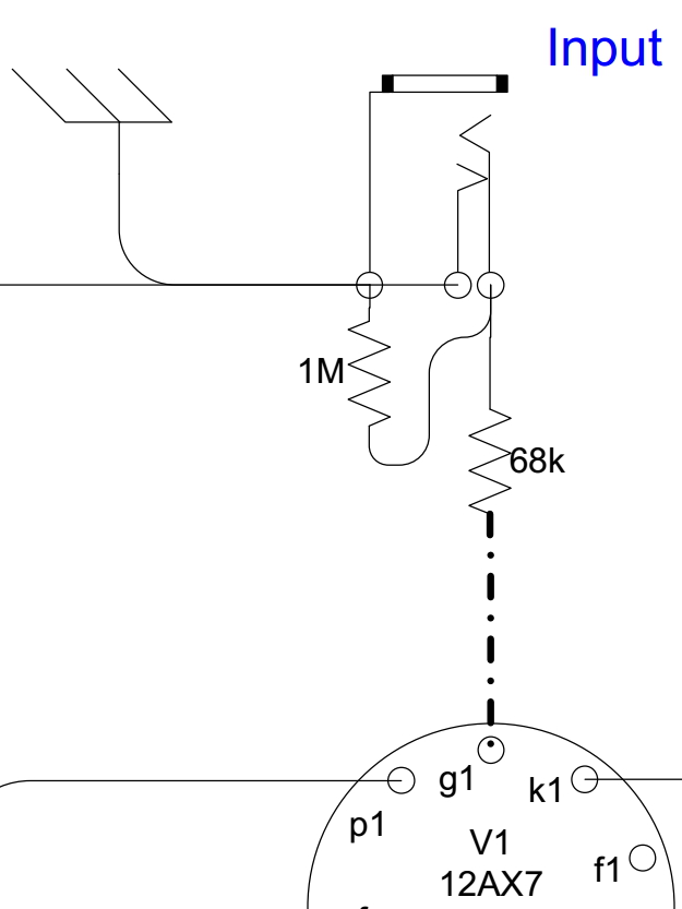

I built a preamp fashioned after a Fender design. Instead of using the Hi-LO dual jacks, I used only one input jack.
I would like to add a second input jack on the back of the chassis. Both should work independently - i.e. one or both jacks open or closed with inputs won't affect the other in any way.
Currently, my single input goes through a 68K resistor before grid 1. When open, there is a 1M resistor before the 68K, wired to ground.
When the jack is closed, the signal grounds directly to the chassis.
I have a 33K resistor on a switch to toggle an additional padding effect like the original Hi - LO input circuit. I'd like this switch to be able to pad my new rear input as well
Can I simply duplicate the front jack - 68K to G1 with a 1M resistor to ground? It looks like there will still be a short to ground through the other jack this way.
Can I just connect the second input jack to the same points the first is connected to? I seem to remember trying this once and it didn't work. - Both switches had to be open to keep the signal away from ground or none would work, etc.

The hi/lo thing is easy enough, but first your jacks. Why not parallel the front and rear jacks? Instead of grounding each tip in the jack, Run ground up to one cutout, then series that to the other jack cutout, so either jack, when used opens the ground shunt.
Hi/lo: In the high jack, the two 68k resistors are put in parallel by the cutout contact in the low jack. That leaves a 34k resistance in series with the grid. In the low jack, the high jack still has its 68k grounded, while the low jack 68k is not. That results in the two resistors being in series across the low jack and ground, with the signal to the grid coming from their junction. Those two resistors thus form a voltage divider, cutting teh signal voltage in half going into the grid. That is a 6db reduction.

Can you draw a picture? My schematic brain works on visual schematics, not imaginary ones in my head.
Better than a picture, here's the schematic of what I have now. EDIT : Well, it's the layout map, but you get the idea.Can you draw a picture? My schematic brain works on visual schematics, not imaginary ones in my head.
Enzo is right.
If you plug into the one where the cutout is grounded it opens it and you are good to go.
If you plug into the other jack it disconnected the tip from the cutout connection, which goes to the other cutout connection which is grounded, but you just cut it out so no problem.
Your second jack will look exactly like this, a 68K, a 1M, except, the cutout lug will not go to ground, but to the cutout lug on the first jack.
The unused jack won't have it's tip grounded, but it doesn't matter I guess because you are driving it with the input signal. It does leave it floating with 68K to keep the noise out, but that is probably low enough. Maybe it would be better to just have a single 68K resistor?

If the unused jack still has it's tip grounded via the cutout, and both tips are now connected to the G1 input - won't that also ground the one in use?
IOW, it doesn't matter where the second jack's cutout lug is connected, the signal is still grounded if one jack isn't in use (?)

I suggested putting the cutouts in SERIES. Both jacks wired in series. Plugging into either one breaks the ground shunt.
Wire the tip cutout of one jack to the tip itself of the other, then wire THAT cutout to ground. Now with both open jacks both tips are grounded, and plugging into one or the other opens that series string to ground.
Here, look at the input jack wiring here, one jack is up front and the other in back.

Ok - I see it. Thanks for the schem, that helps a lot!
Trying to visualize the tip contact wired to the cutout contact on the other jack might have been what was throwing me.

Well, it's as I originally suspected.
Use of the front (J101 in the schem) disables the back (J103).
I found the original Peavey Valverb manual, and it confirms that use of its front jack disables the rear one.
I'll go with this for now, because I think any time I'd plug into the front, I wouldn't want the back in use anyway. BUT I'd still love to have each work independently.

I wouldn't want to use both inputs at once anyway, they will be force mixing the signals in the jacks.
If you want to be able to use either one all th time, just mount a simple A/B switch.
The basic wiring I suggested allows you to plug into either jack at will, but not both. The only time you would use both is to have two competing inputs plugged in, not desirable.
You could still wire up both to work with muting, but you'd need to use jacks with extra contacts, like TRS jacks. Similar to the Peavey example, you'd wire the #1 jack cutout contact to the tip, then the #1 ring to the #2 cutout, and then #2 ring to ground. That leaves both tip contacts unused in the muting, so you can wire both with series resistors to the input circuit.
