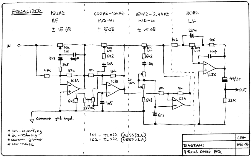

dual ganged pot
Does anyone have a schematic or diagram for the dual gang pot in the eq schemayic?
