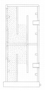

You certainly can use a pair of TLs. I used a pair of mass-loaded lines for two 7-inch woofers in my 3-way TuLines design quite a few years ago. These obviously aren't tapered which makes them easier to implement and build, and the midrange driver I used was a dome, not requiring a separate enclosure (or another TL for that matter). I've attached a scanned side view drawing of this design in case it might help.
Paul
This has been done commercially. From memory Castle Acoustics (British company) made a model called the Howard. It had 2 separate lines with one forward firing unit and one upward firing unit (plus a forward firing tweeter). The lines were tuned to different frequencies. Received very good reviews. 1970s/80s I think.
