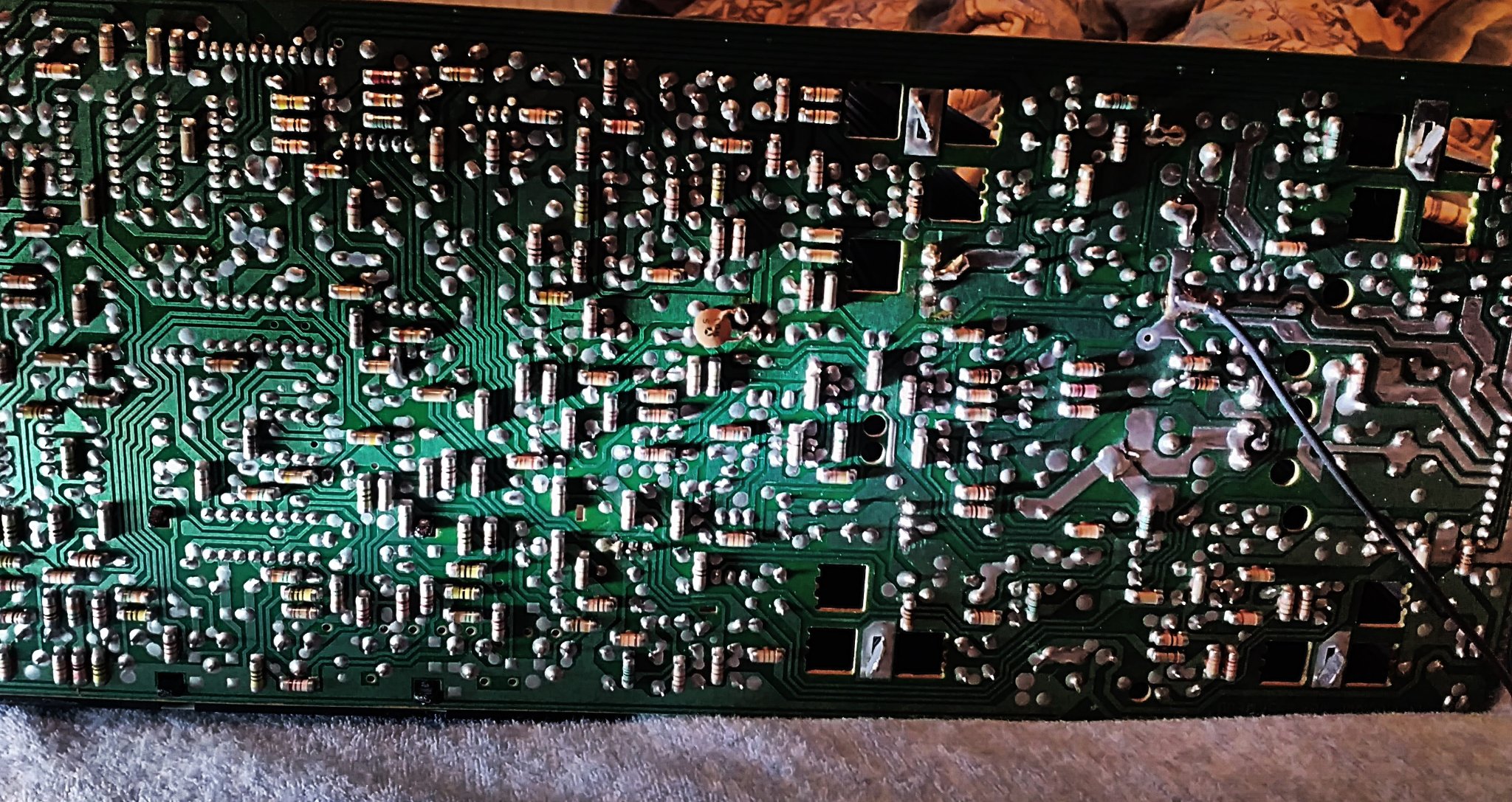

Hi, everyone.
I opened the amplifier and examined the soldered side of the circuit board. It is a semi-SMD board with many components on it. I have ordered replacements for the capacitors, but I see that replacing them will be too difficult for me due to very little space between the solder joints. With a normal soldering iron, I wouldn’t be able to change them without risking damage to the SMD components from heat.

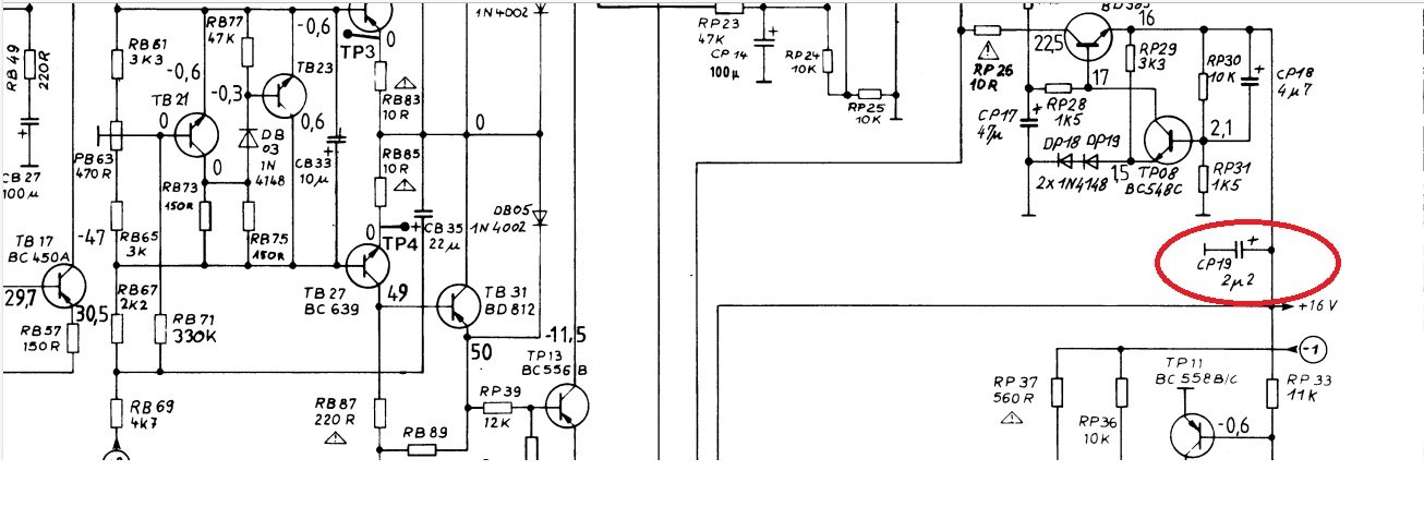

Hi all, I recapped the amp. Everything plays OK, no hum or buzz, but I have strange issue now.
When I put cover on the amp I heard loud static noise in my speakers.
What is more scary: when I unplug some devices (CD player) from the socket, where the amp is plugged in, I hear loud noise in speaker too.
It´ s like the sound you hear, when some cap is failing in yor amp.And CD player is not even connected with audio cables to the amp.
Otherwise the sound is excellent.
Does anyone know the reason?
Thank you very much.
Jan

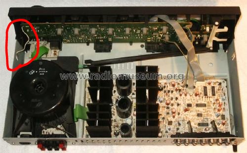

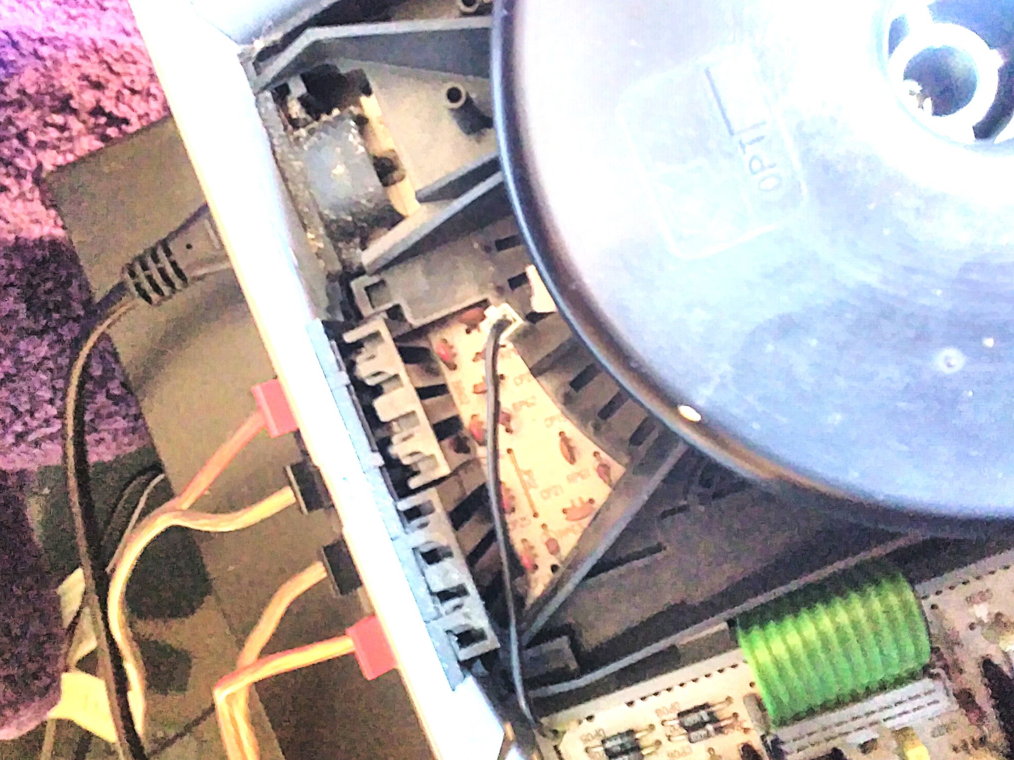

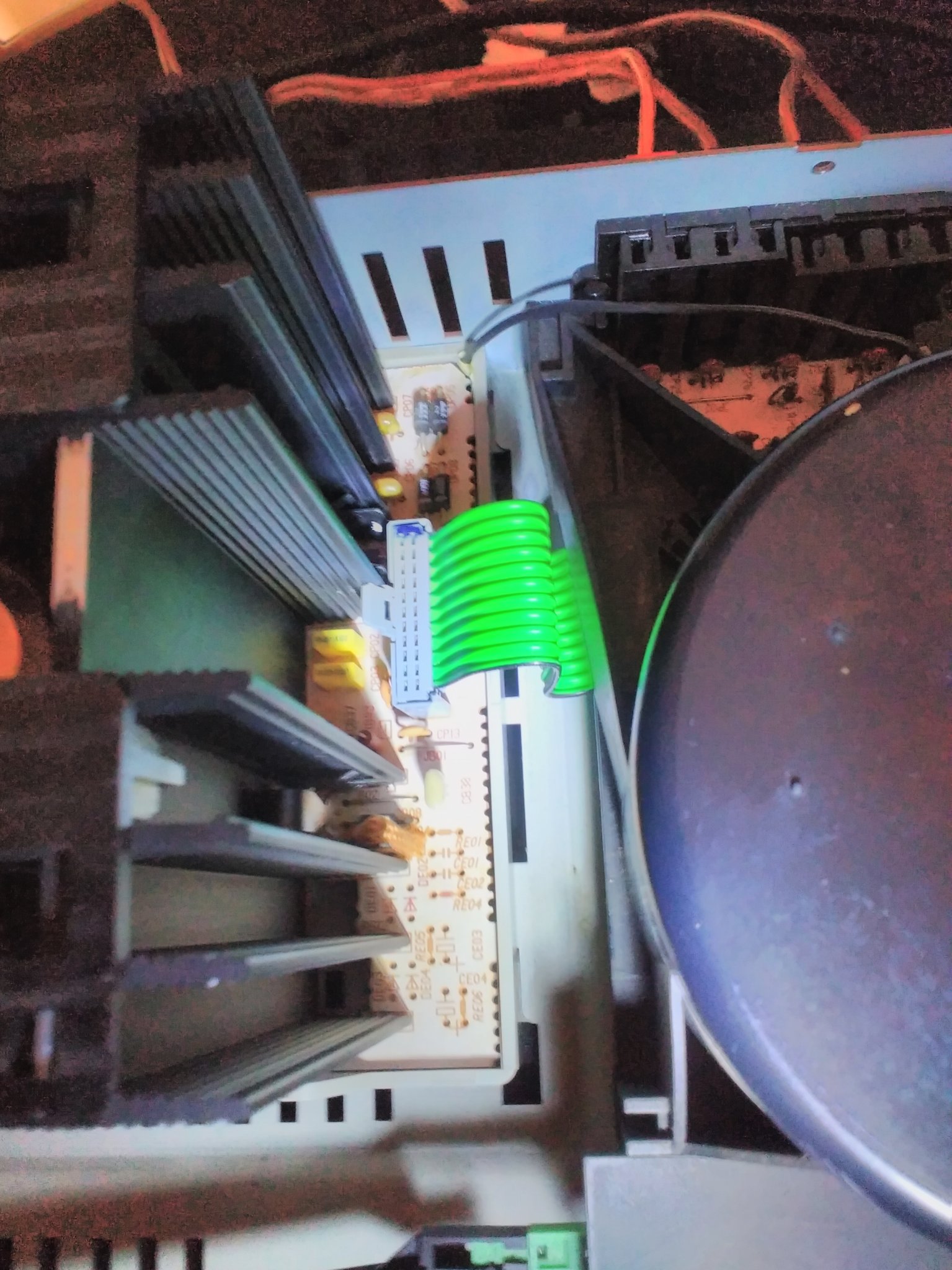

Ok.In the picture"Board" you see the black wire going to the transformer grounding point.
The next pictures are just for to see the upside of the board and the connection from the transformer.
I´m just thinking now.
Could it be caused by the high offset or idle current value?
It´s got two trimmers for adjustment.But TP points are not separate.You have to measure it on the transistors.
I´m a bit worried about it.
