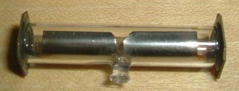

There really aren't too many components regarding the strobe. Have a look at the schematics:
The components are the lamp Gl. 1, the diode D51, the capacitor C51 and two resistors R51 and R52. You can check them easily. But the lamp remains the most suspicious culprit.
Best regards!!
If you have removed the Neon, and are in 120V land, wire the neon in series with 47K resistor and *carefully* connect to 120V. It should light "steady". They do get weak over the decades. Old neons typically flicker, or work in the light but not in the dark.
This way with raw AC, the "steady" glow (if any) is really a 120Hz flicker. The Dual adds a bunch of parts which seem to make it a 60Hz flicker, so they can use half as many wider strobe-bars for a nicer pattern.
Neons can still be bought from China, but LEDs make a lot of sense now.
You can by Neons, not only from China. But i doubt, that you can by a neon that works as a 1:1 replacement for the Dual players.
If you have a dealer in China who sells these bulbs, let me know.
LEDs work great, but please use an orange one 🙂 I've seen so many with a blue LED replacement 😡
It's a DUAL not a Pass 😀

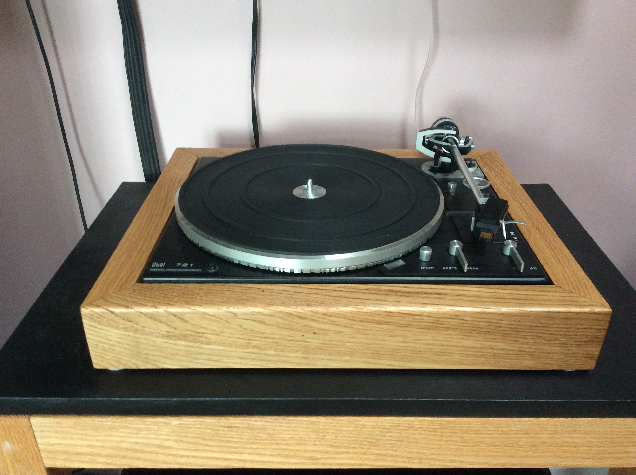

Oak plinth
Here is a picture of the 721 on the oak plinth I made over the weekend. I certainly won’t hide the turntable under a dark dust cover. Too gorgeous for that!
