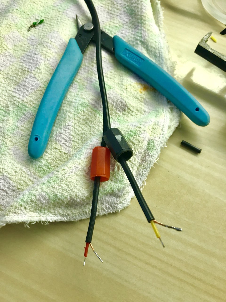

Thanks Kay Pirinha for pointing out the ground shorting link shown in the left hand diagram of Figure 1.
I would favour removing that link completely and replacing the DIN lead with an RCA lead and ground wire as shown in the right hand diagram of Figure 1.
However, if the DIN cable is a twin coaxial lead as you say, then by far the easier option would be to cut the existing DIN plug off the lead and replace it with two RCA plugs. (There would be no need for a separate ground wire in that case, as the ground shorting link you mention would remain in place.)

I will go visit him on Saturday with preamp and speakers, soldering iron, RCA cable and pair of connectors.
I will decide on site what to do with cable, I want good electrical but also mechanically sound connection.

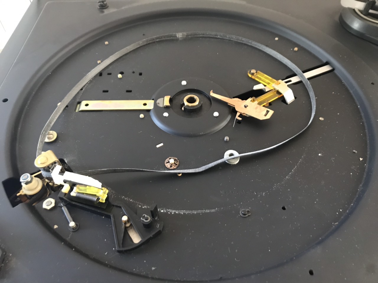

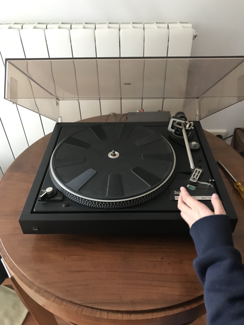

Unfortunately bad news, platter was spinning super slow and then came to a halt, new belt is in order I suppose.

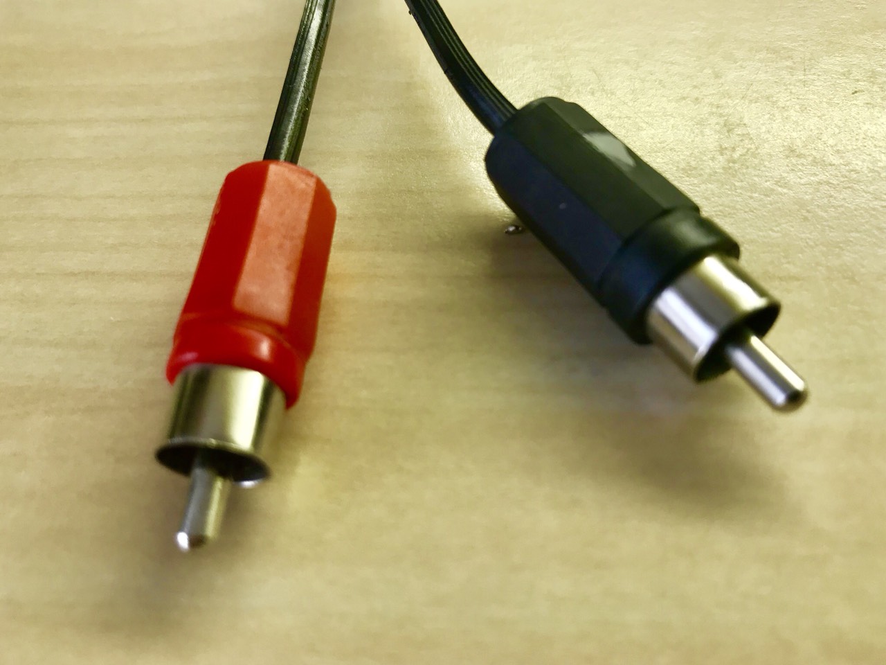

Good news is that the system is completely Hum-free Bogart with new RCA connectors on old DIN5 cable, but only with separate ground wire connected to preamp chassis.

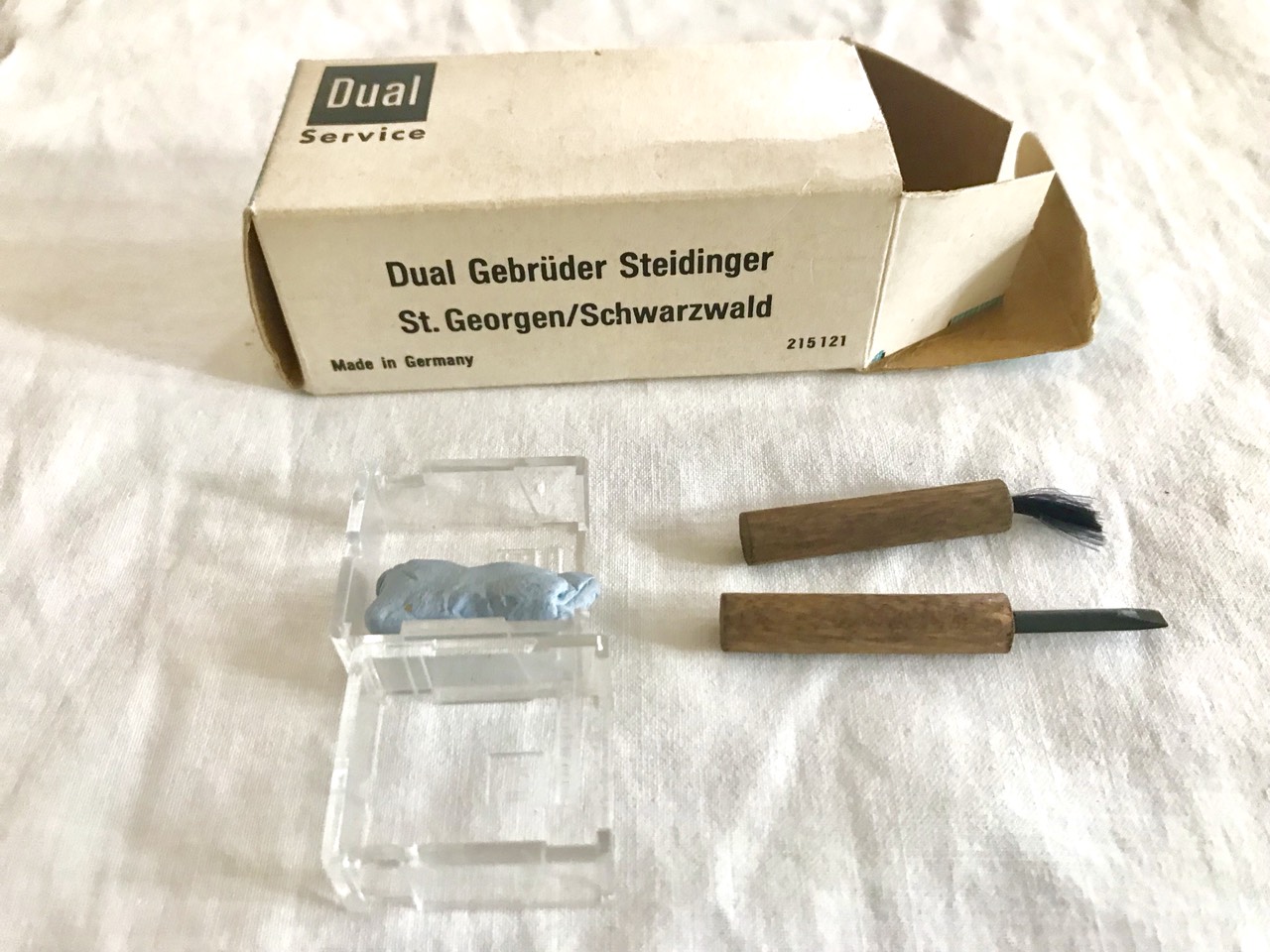

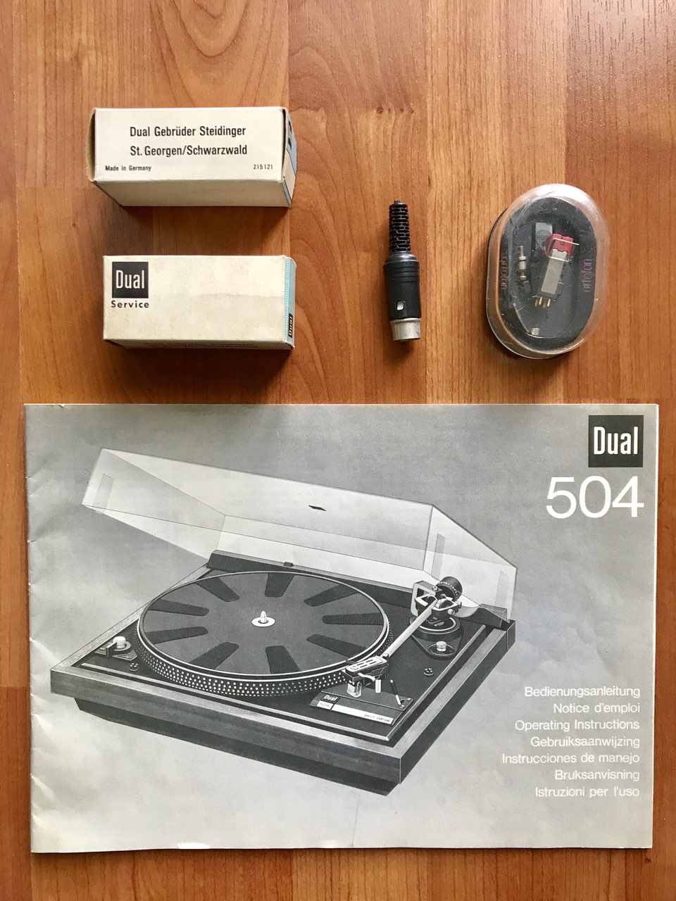

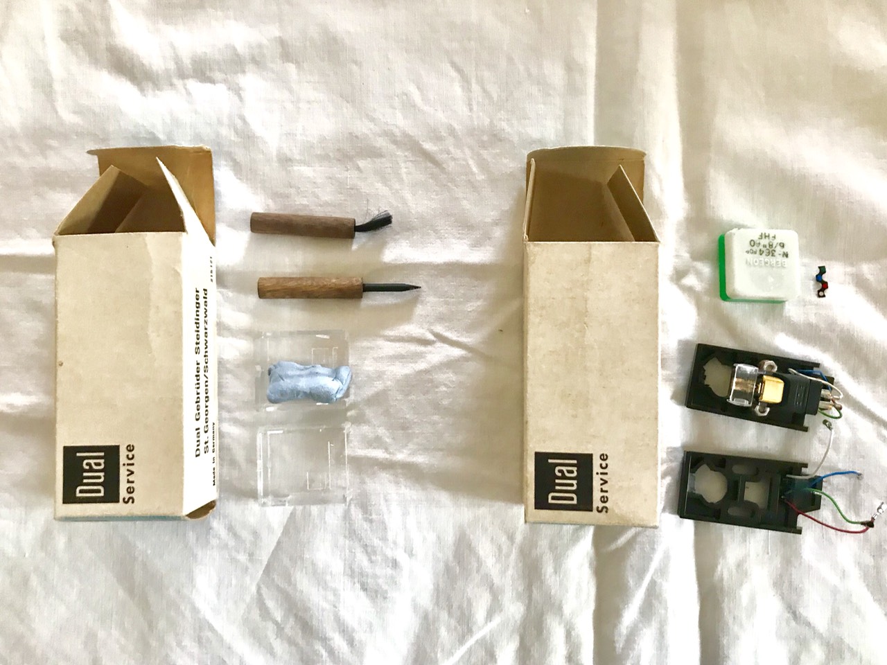

Pictures of accessories he got with the turntable, really nice package, cleaning kit, extra stylus...

And congrats for this nearly pristine Dual 504! I think it has deserved RCA plugs of somewhat better quality, though 🙄.

Another job well done! And don't worry about the quality of those RCA plugs, they will conduct the electrical signal perfectly well! 😉

Initial plan was to solder new RCA cable of better quality, but on site a plastic under tray seemed complicated to remove ( I did not dare to turn turntable upside down). So, I just soldered cheap connectors I had with me on the old cable.

I don't like threads to die without resolution so here I am to report total success 🙂
Changed the belt, it was obvious after removing the platter that the old one was long gone. Uncle is happy, me not so much I feel as dynamics are missing in the sound but considering his hearing all is well.
