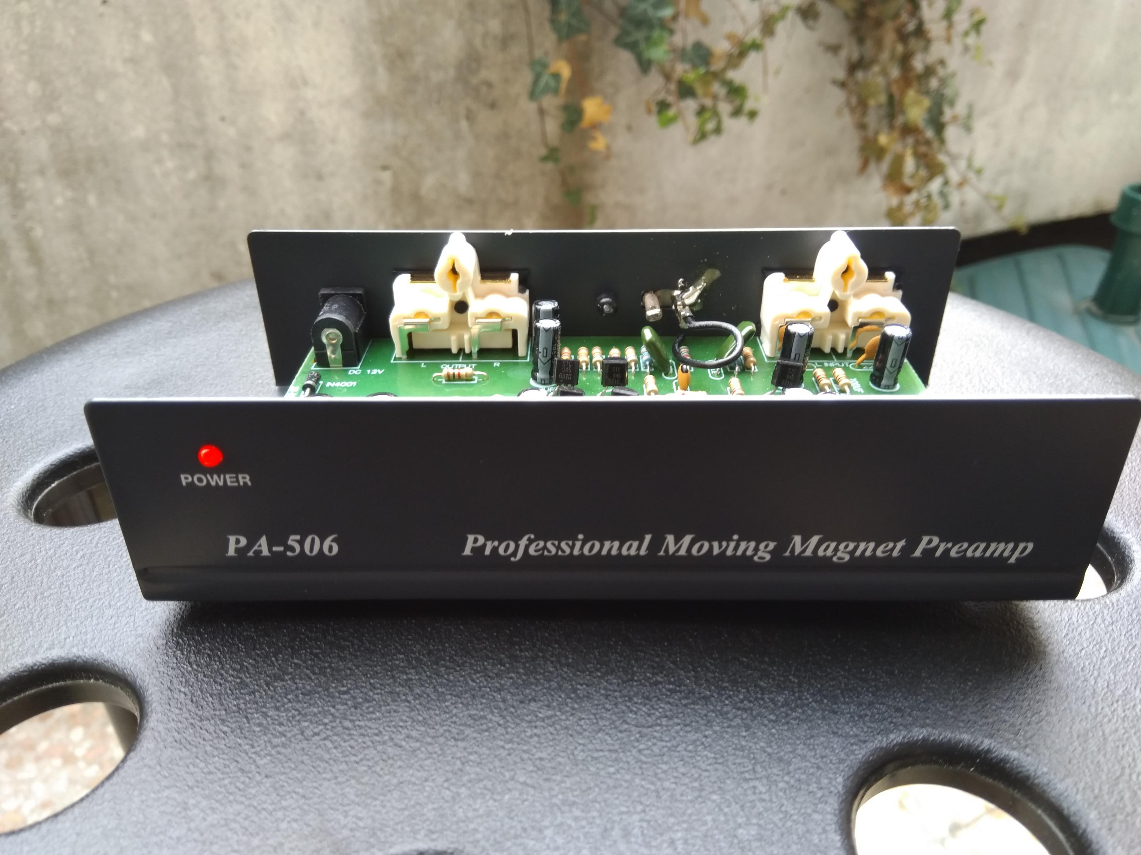

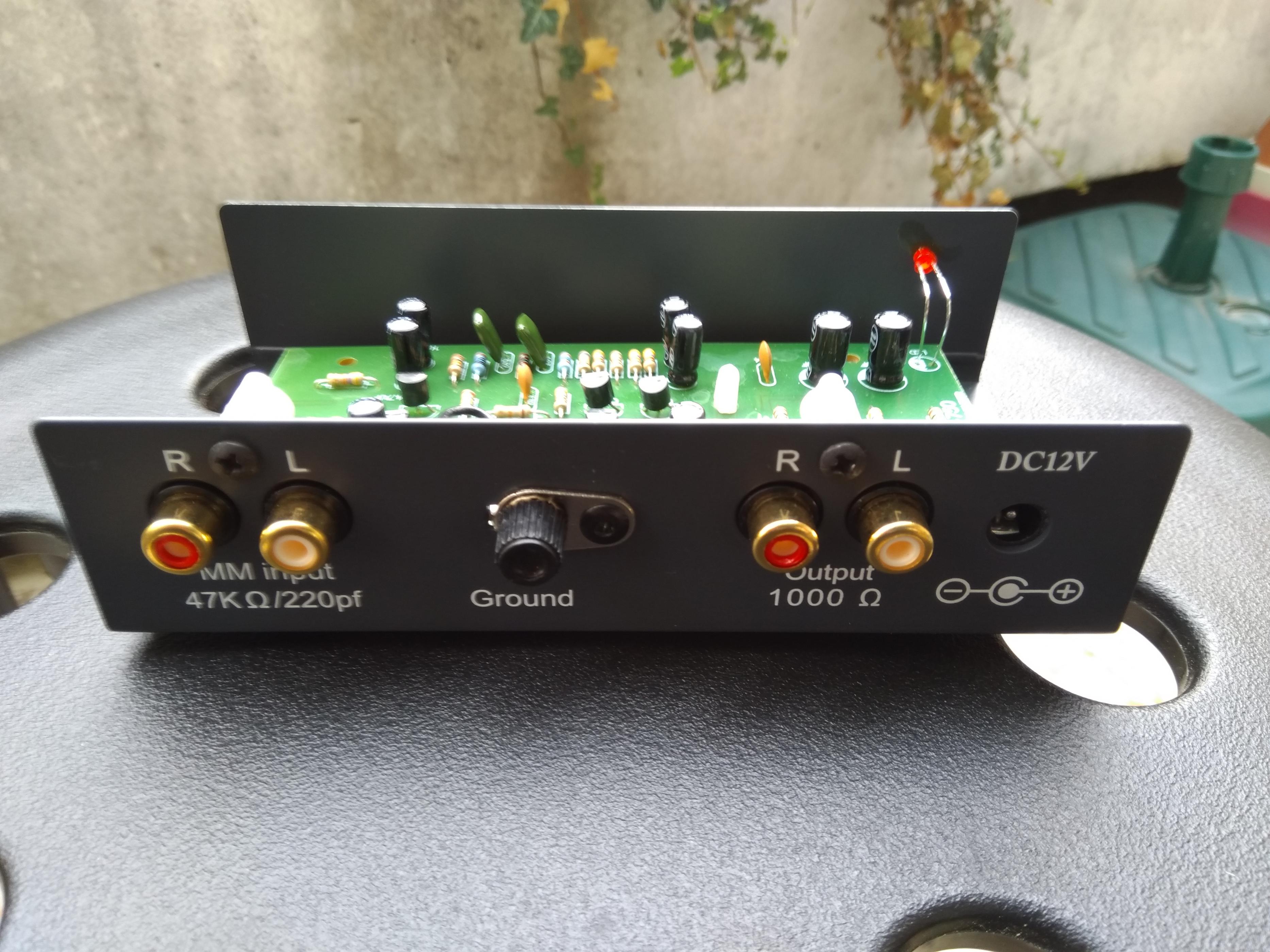

The preamp employs discrete transistors instead of opamps, which many users believe give better results.

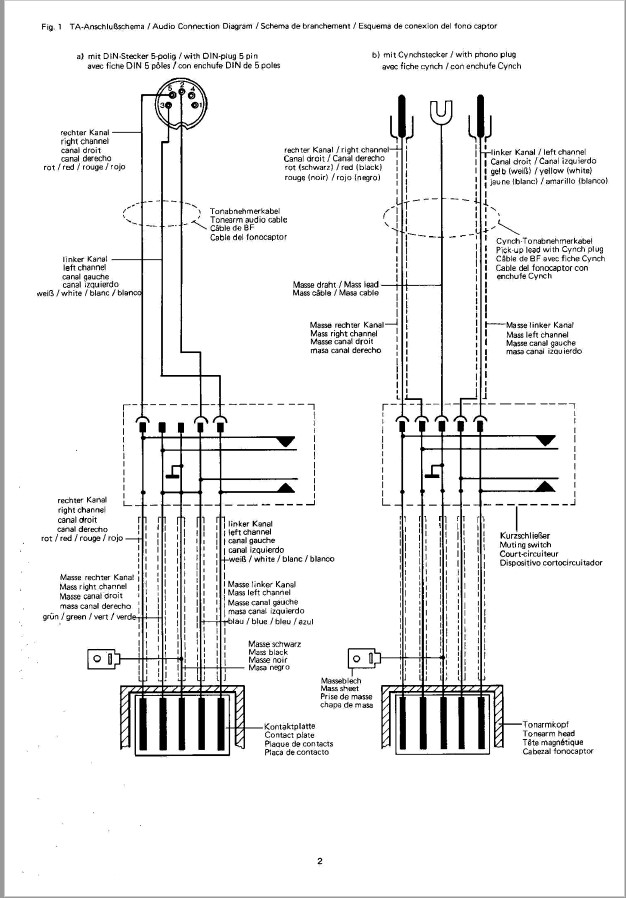

I have another question, it seems that turntable has DIN 5 connector on its output and a separate wire for shield. Do you suggest I:
a) buy DIN to RCA adapter
b) cut DIN connector and solder RCA connectors instead
c) change DIN cable for RCA cable and solder on turntable side
You have right but a truly professional preamplifier is not only made only with 3 transistors.
@mkusan: If you are sure that the cable are completely separate into 2 shielded wire that better you cut the cable and put two quality RCA connectors.
Provided there is access to a handy tag strip on the underside of the turntable, c) would be my preferred option.c) change DIN cable for RCA cable and solder on turntable side
And as sesebe states - the DIN lead may not be suitable for taking two RCA plugs, which would rule out option b).

...a truly professional preamplifier is not only made only with 3 transistors....
It is possible to make a very excellent phono with three transistors.
However 12VDC power is mighty low and casts doubt on the "professional" badge.
OK, sticking the word 'Professional' on the front of the preamp is a bit cheeky, but I'm sure that uncle will be more than happy with the performance!

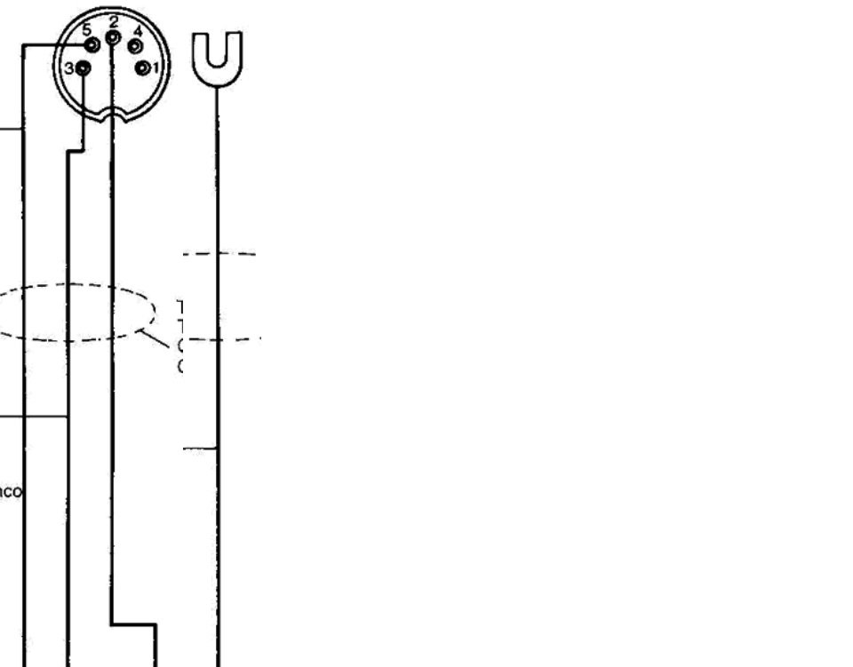

According to the service manual L&R channel are not separately shielded, see below.
View attachment 710874View attachment 710880
In reality the stock DIN cable is a twin coaxial lead. Both channels may easily be separated and equipped with RCA plugs.
And yes, there's an easily accessible tag strip beneath the chassis, called the muting switch, where one can solder new RCA leads as well. The stock DIN cable features three 2.8 mm Faston blade connectors.
If you have a close look to the left handed drawing, you see a bridge that short-cuts left channel ground, right channel ground and chassis. If you swap to RCA leads, it depends on the actual (pre-)amplifier and the cartridge grounding whether it is best to leave this bridge (and omit the separate ground lead), to cut the bridge from the chassis, but leave it between the channel grounds, and provide a separate gnd lead, or to remove the bridge completely and also provide the chassis gnd lead, of course.
