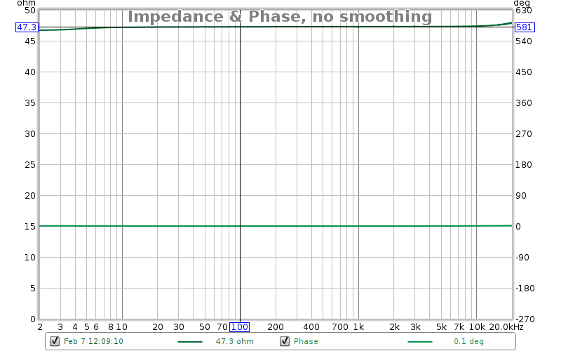

Easy with REW to measure your system residual distortion, FR, etc. Simple electric design that feeds your DAC (a little jig about the same as measuring impedance), just like your mic amp feeds it. But unlikely amp contributes enough to worry about unless tubes before 1970. Nor to fuss about absolute loudness - just test loudish.
Here's a test jig. Needs a few alligator clips or you can be clever with rubber bands. "DUT", device under test, can be a resistor so you can see the FR and distortion of the whole chain ending with the amp or a speaker so you can see the relative impedance plot (really interesting to see how a BR is working or how your 32 Hz drivers are behaving).
Trick is to find "resistors" around the house to use. Most resistors in the range of interest are those that get hot like incandescent bulbs or bread toasters. Anybody with ideas?

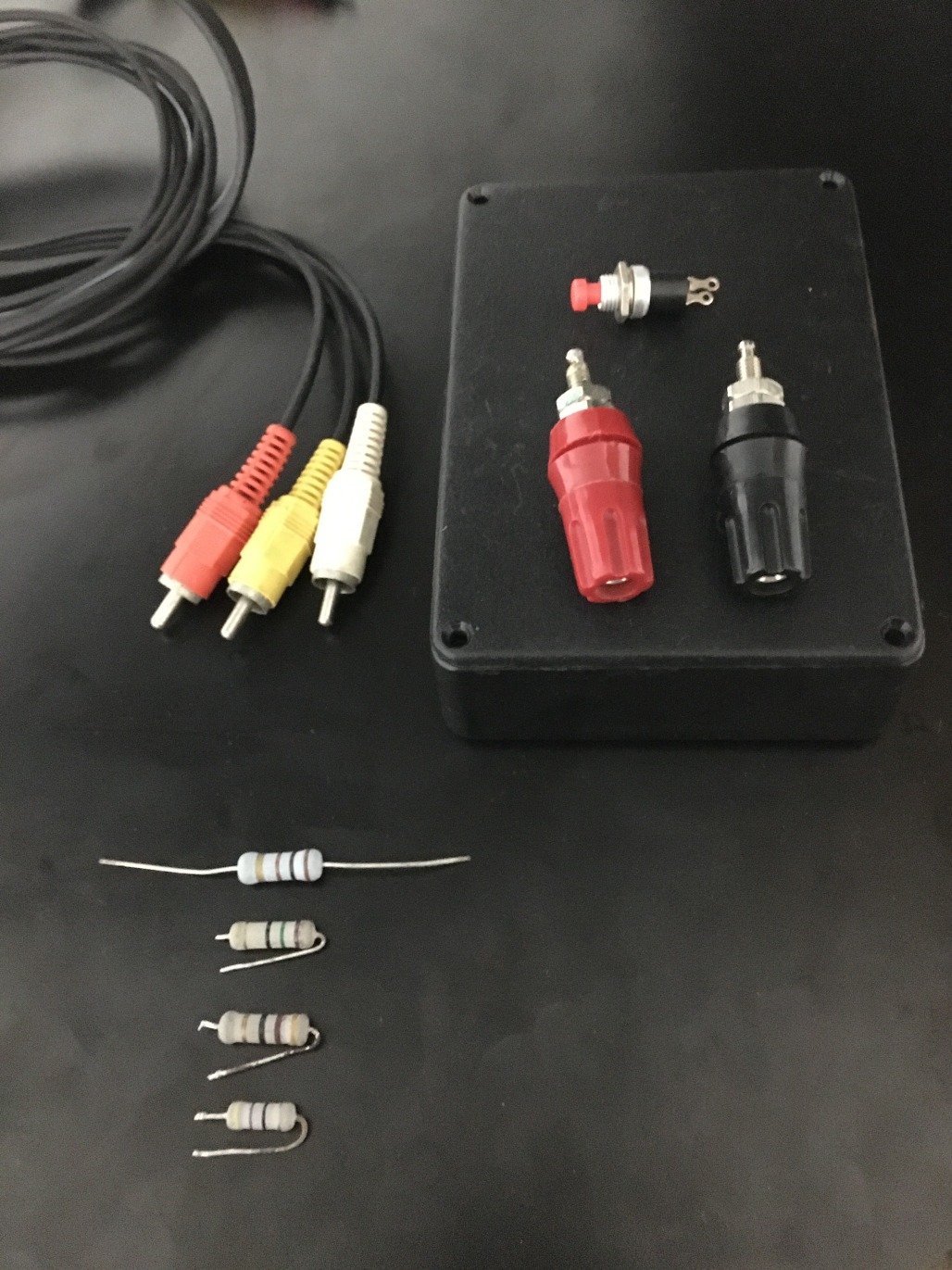

P.S. In the mean time I found some old parts in my stuff bin to build an Impedance jig for REW and play with, I have resistors between 100,75 and 47 ohms
so still thinking what will be a good value to start with.

Start with 175 Ohms because you want a largish multiple of the DUT resistance. Just a matter of getting enough signal off the DUT to drive the REW input. But with small-sized resistors, take care not to pump to much amp power into them since a 5 watt sine wave will destroy a 1-watt 200 Ohm resistor in a few seconds, eh. Just enough to keep out of the residual mud. Start low.
An amp outputting 5 watts will have an output voltage around 7 VAC.

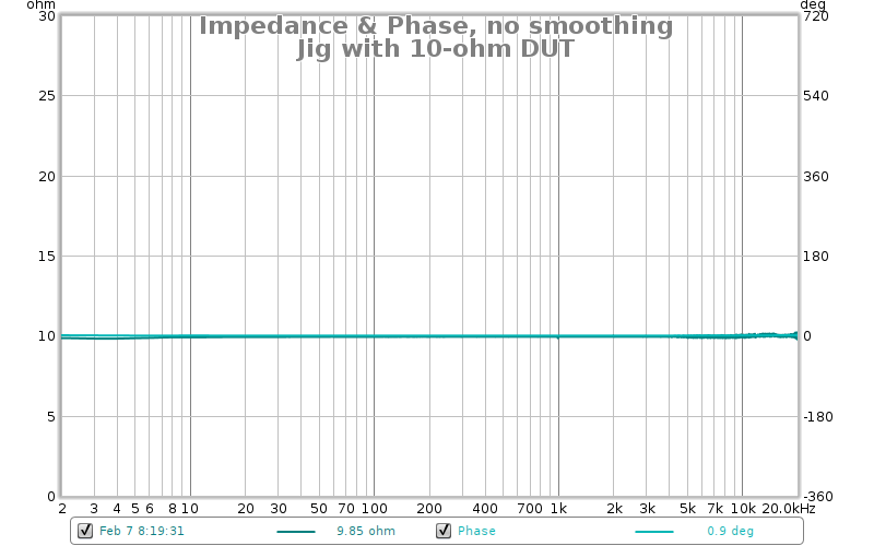

First run a plain resistor as the DUT to see if you are in the ballpark for measuring OK. If you have like 10 Ohms, that will serve nicely as a reference.

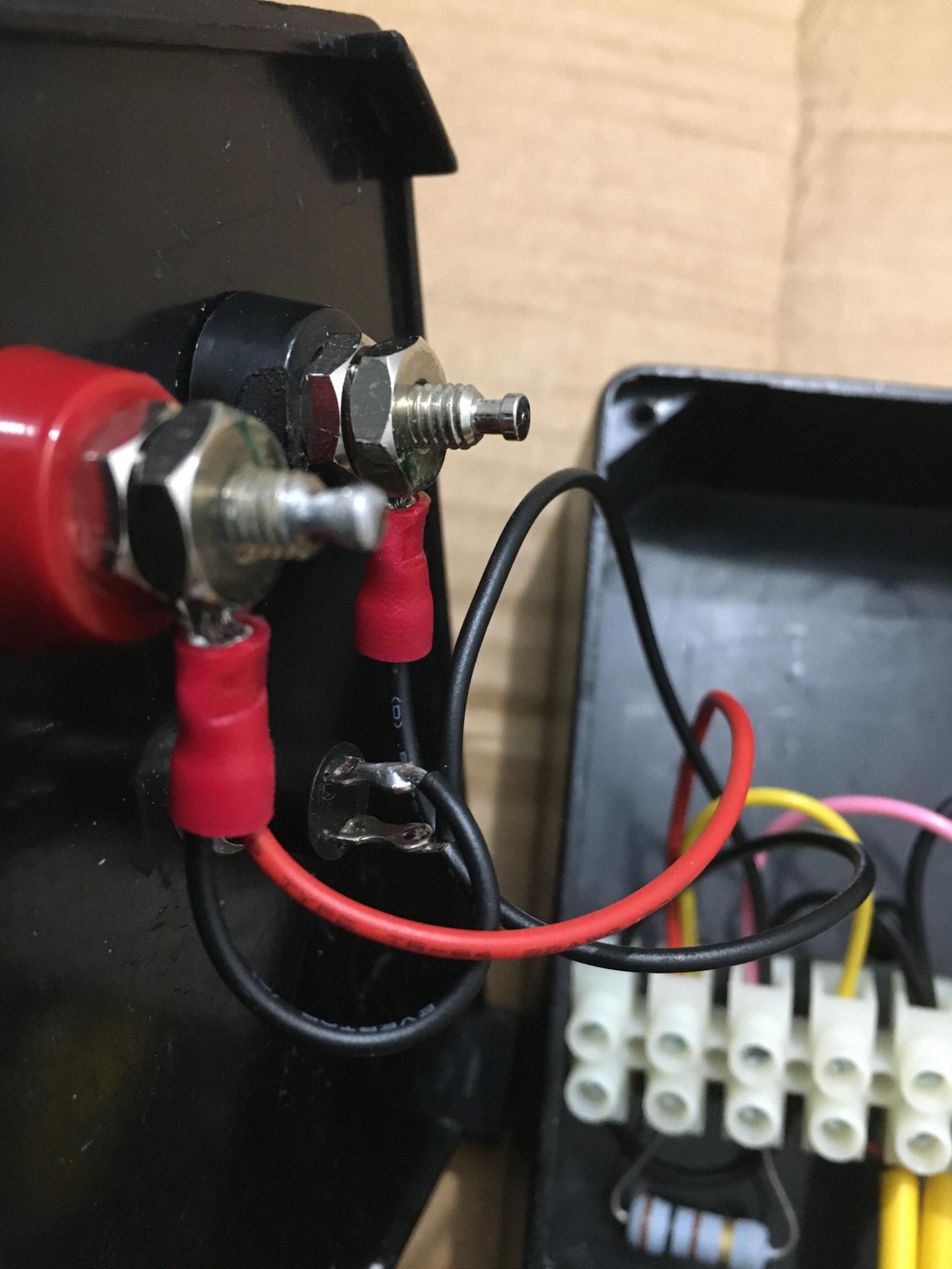

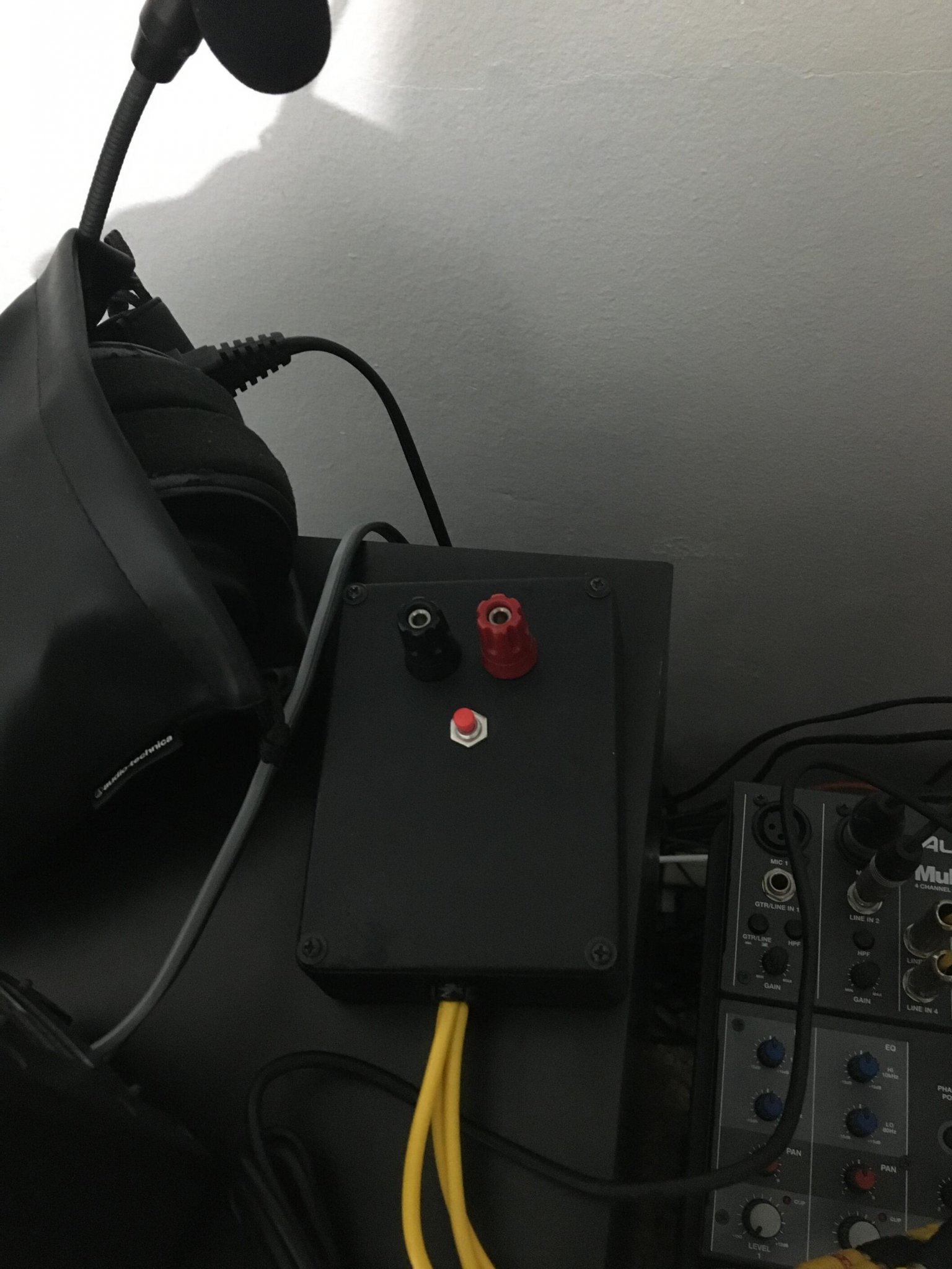

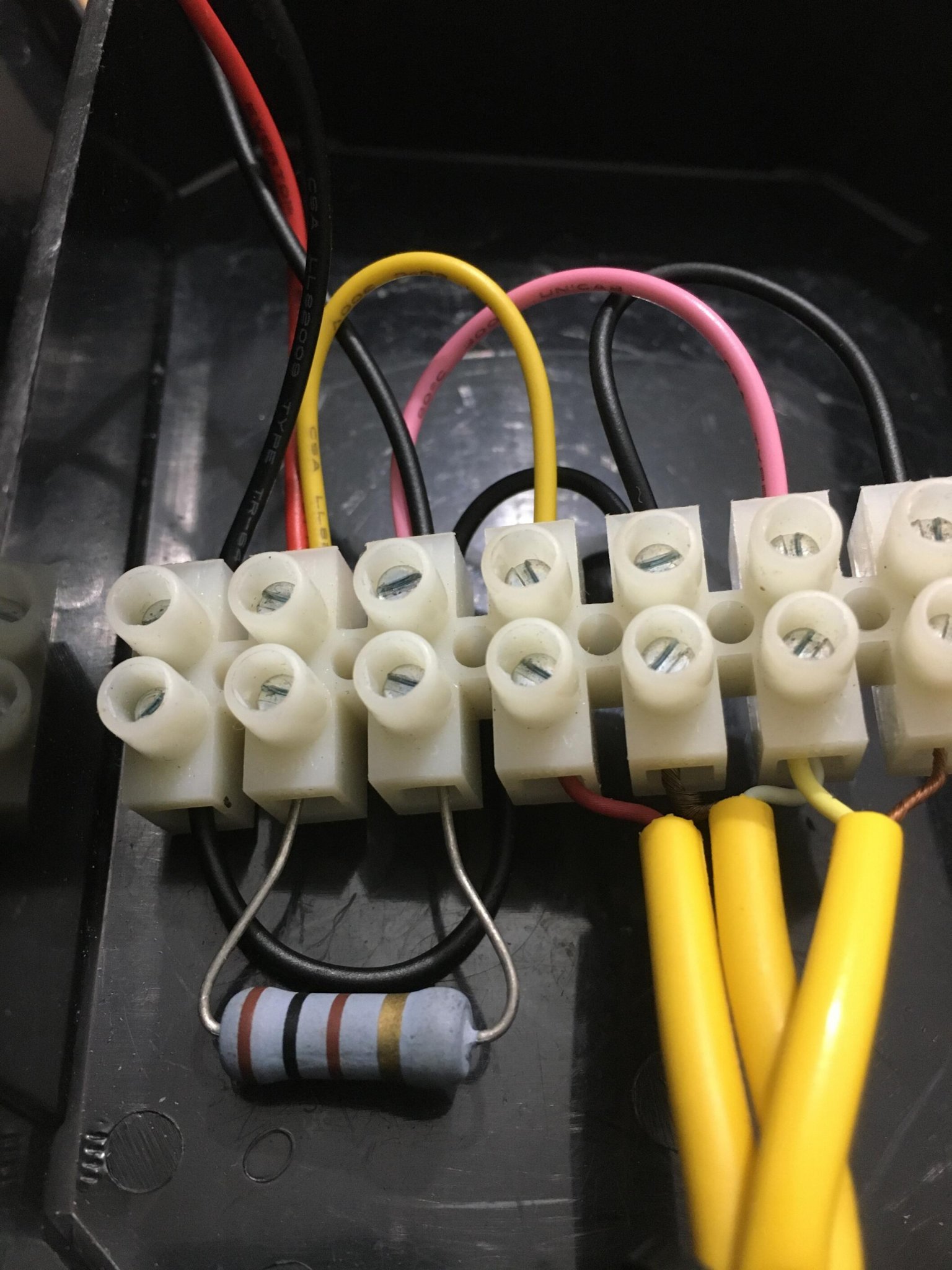

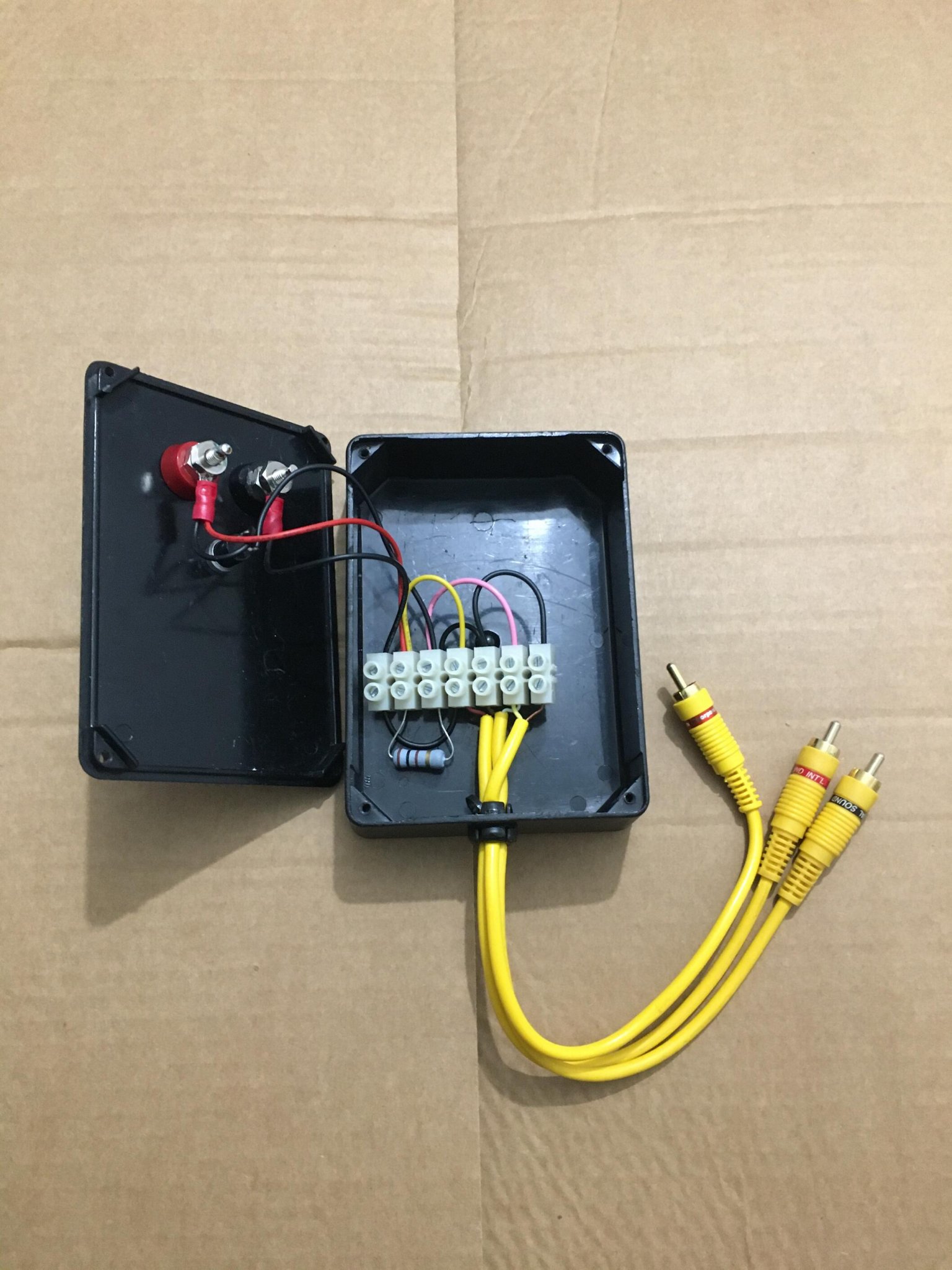

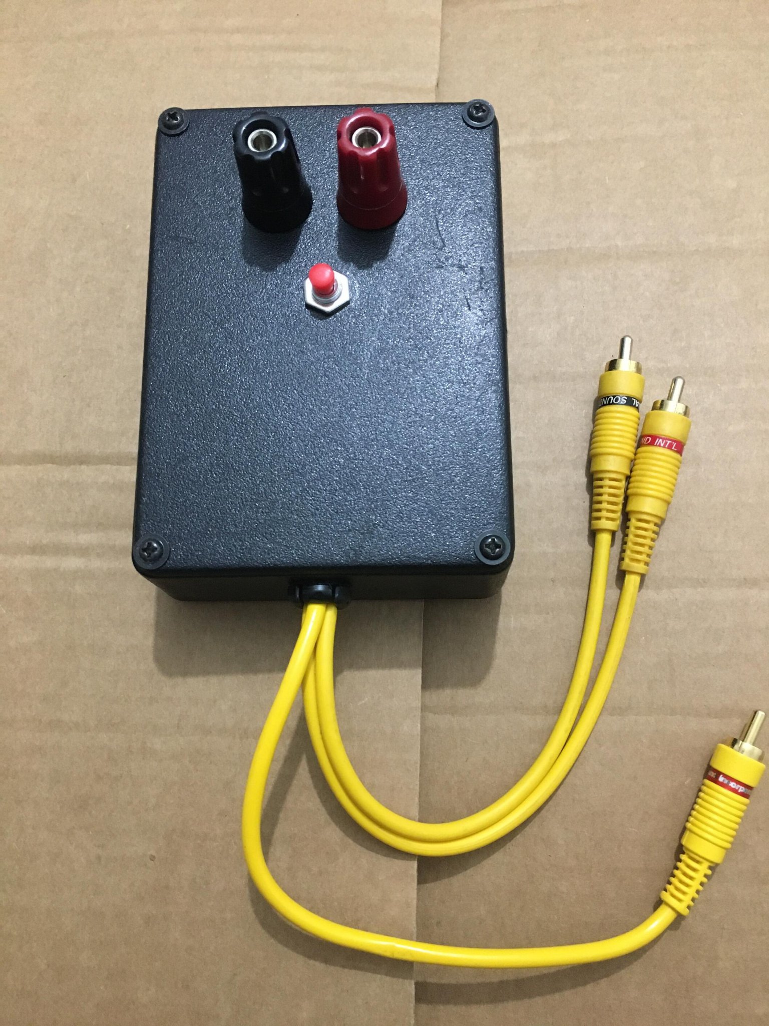

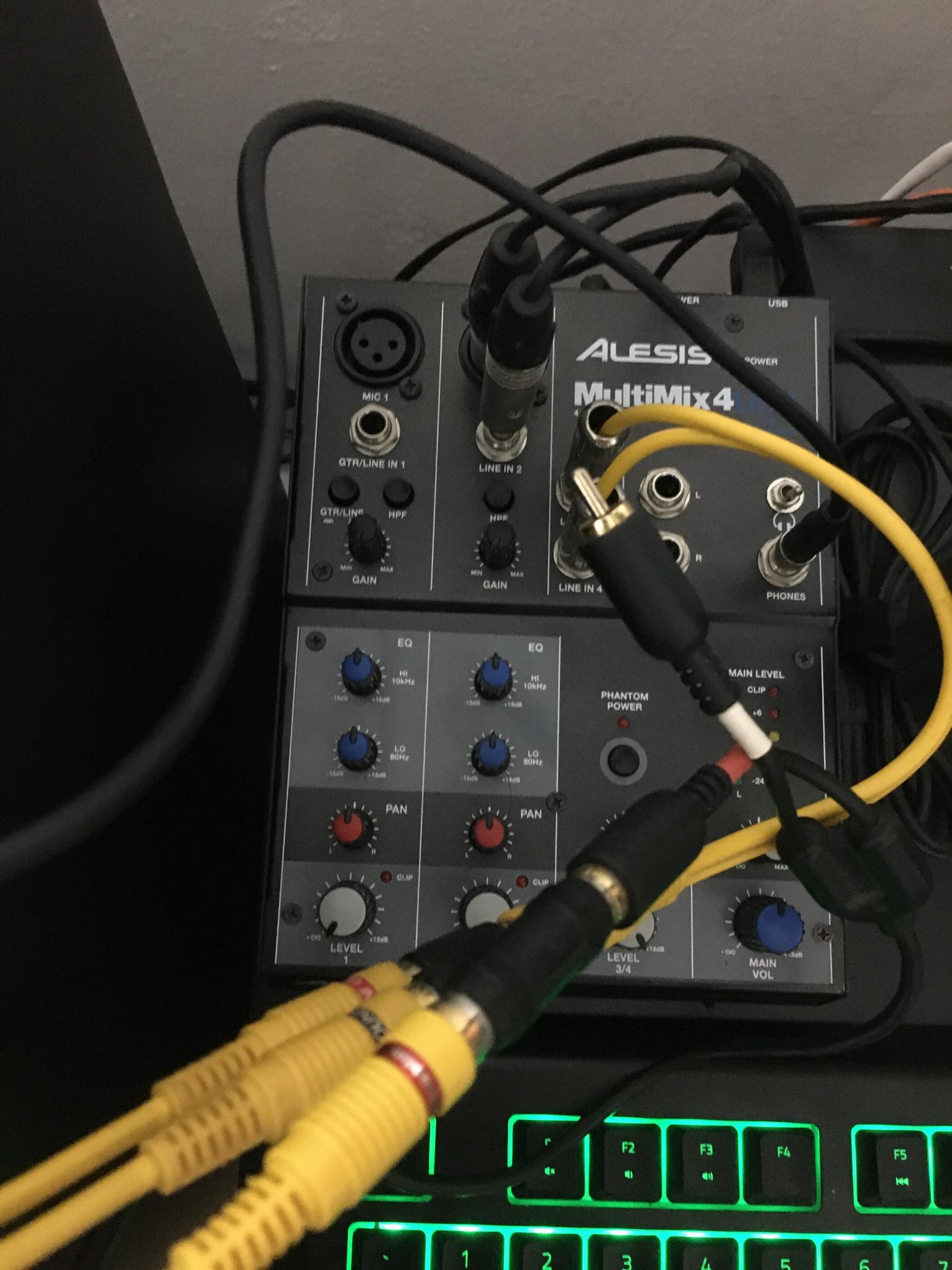

Hi Ben, sorry a bit late on t his JIG build/setup, I got some time and built the impedance measurement Jig and connected it to my old USB audio interface, an Alesis MultiMix4 USB(with monitor on/off modification) and ran a quick test.Should work OK and headphone amp likes playing into that kind of impedance. Might have to crank up the headphone output. No risks, I can think of. But if others have cautions, time to speak up.
Since this is my first experience with REW + Impedance/Jig, I will post the build images for reference and the first dummy test results so I can have some advice if they does not look appealing for subwoofer measurements.

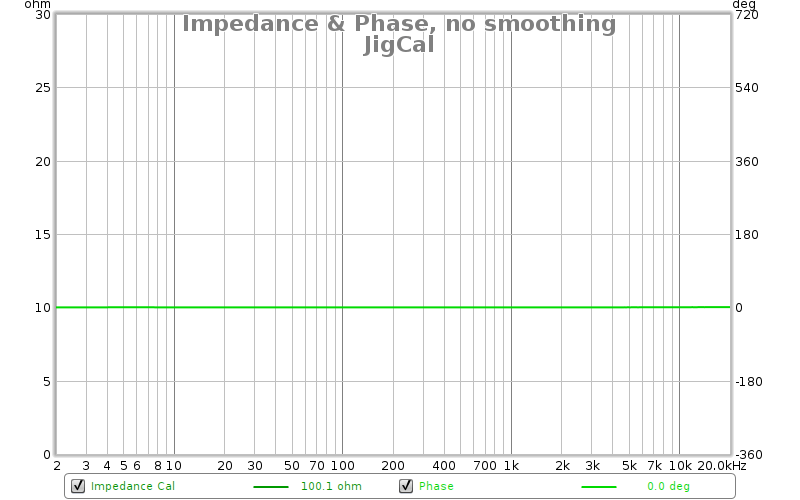

Interface calibration, red button press momentary shorts sense resistor:
Measurement with a 10-ohm resistor(measured about 9.9-ohm on my DMM):
I've noticed that the impedance start dropping between 5~6Hz, and getting abit noisy over 4Khz, however since this is for home measuring subwoofers to get an approximation of the box tuning mainly, it seems that the recommended 100-omh sense resistor is ok with this audio interface, though I can easily swap the sense resistor if needed.

The good ol' "built like a brick outhouse". Fancy. Nice. Gosh, I wonder how flat the system is below 2 Hz? Actually, suspiciously flat and extended... but just changing the benchmark resistance should confirm it is measuring the resistor and not something false.
When you get to check the speaker, use the REW "Overlay" button to plot the benchmark and the speaker on the same picture.
But for others reading this thread, with these low impedances, just loose alligator clips with no shielding would be fine.

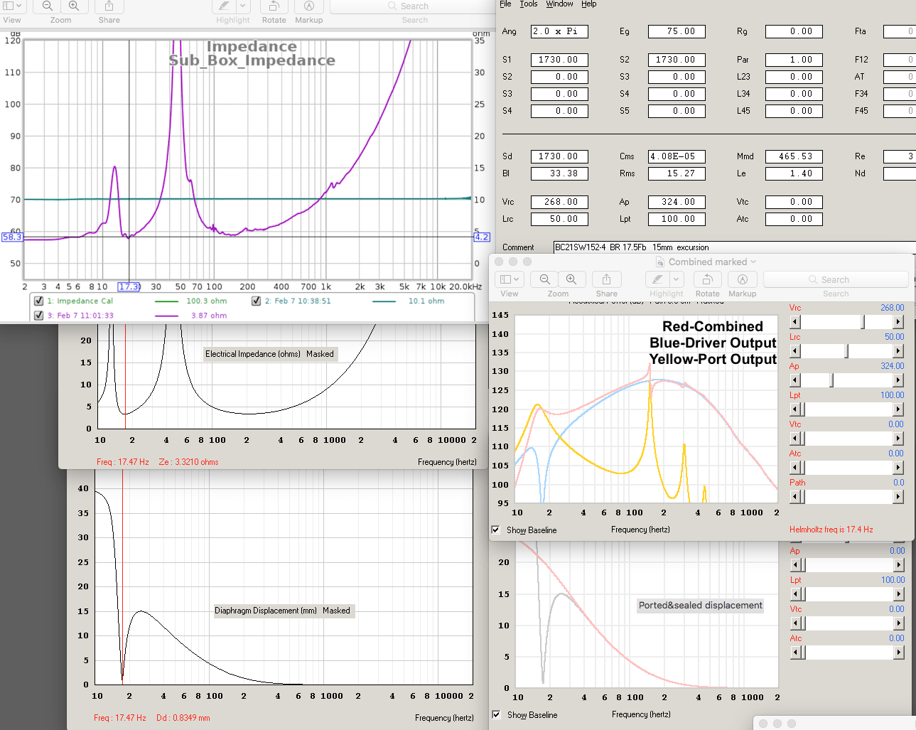

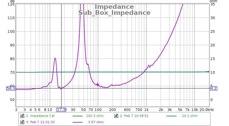

I've took few measurements and they look similar, so looks like there is no variations in the audio interface and jig counterparts, however as I've though the tune looks a little lower that the WinISD prediction, so I will post both graphs for comparison.

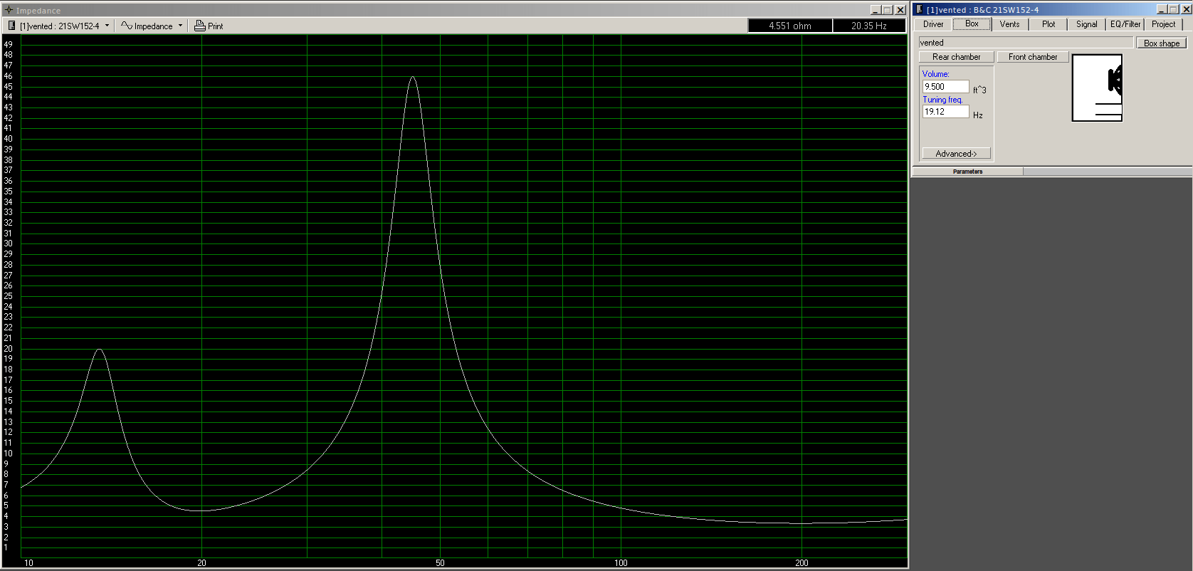

WinISD impedance prediction:
REW/Jig box measurement in pleace:
Between I've read somewhere that WinISD over calculates the port length by between 10~15%, plus the subwoofer box is placed in the corner very tight close to walls effectively extending the port length thus dropping the tune slightly, also there are 2x big pillows per box too, so seems the tune is between 17~18Hz regarding REW+Jig. 🤔
Nice stuff. BR. Clear X-ray of cone motion.
You can also see the value of bracketing the speaker plot with plots of a highish and lowish resistor on the same picture.
Seems you have a lot of cone motion just south of 50 Hz and that is also where the box/port adds to the output (but at the lower motion bump, the port subtracts from the speaker's output being contrary phase). Prolly sounds great because (if truth be known) hardly anything below 40 Hz worth fussing about on normal recordings and that low-end boost is helpful.
Although impedance is complex, looks like you don't need to sweat about Zobel circuits and lose sleep about XOs until above maybe 400 Hz. (or ever sweat anything about impedance if using active XO, like ought to be).

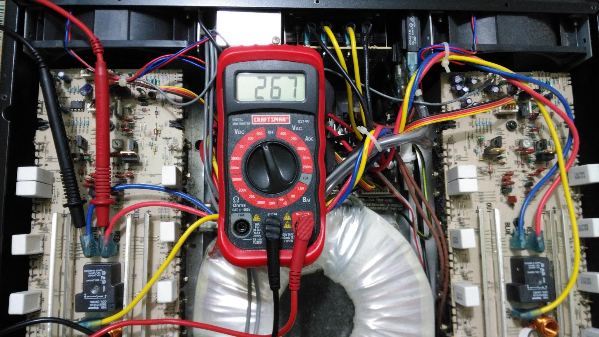

As for the S2000 amplifier delivering the ~63v, I still haven't clipped them yet even at the non-rated 4-ohm bridged in my room, also some time ago I've opened them for cleanup and take a rail voltage measurement of one channel and I think they have enough voltage after load sag(133v/133v):
