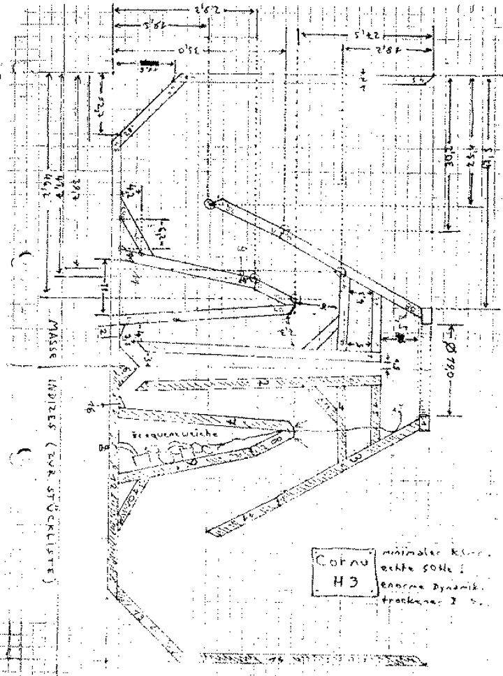

Limit
Acoustic Bend Limit
Once the transverse passage width [W] of a horn bend becomes greater than ½ the wavelength of the highest frequency to be passed [fh], wave propagation around the bend becomes chaotic and cancellation at certain frequencies above [fh] occurs. This is accompanied by a marked increase in bend reflectance that generates strong back-waves that return to and impinge on the driver diaphragm.
For long horns that require several bends to fold them up into a compact footprint, passage bifurcation may be employed to reduce (halve) bend width and thus avoid the ‘acoustic wide bend problem’.
As early as 1877 (and probably earlier), Lord Rayleigh (Theory of Sound) recognized that these departures form a straight single passage duct have a negligible effect on the propagation of long acoustic waves through them, so long as the ducts involved remained acoustically slender [W]<[c]/(2*[fh]), or in other words, the waves remained acoustically long [fh]< [c]/(2*[W]).
WHG

my scientific english is not so goodAcoustic Bend Limit
WHG
see if i understand this correct.
lets say the fh is 100 hz 34.3/2 is 17 cm.
an enclosure of 53 high,if the inside pannels of the horn are, lets say 50 cm ,you best divide it around the bends in 3?
regards erik

This is good practice as well, particularly when extended beyond the bend.
Here are some examples of the passage bifurcation to which I refer:
Klipsch:
PA Tub
WHG
MicroScoop ?
