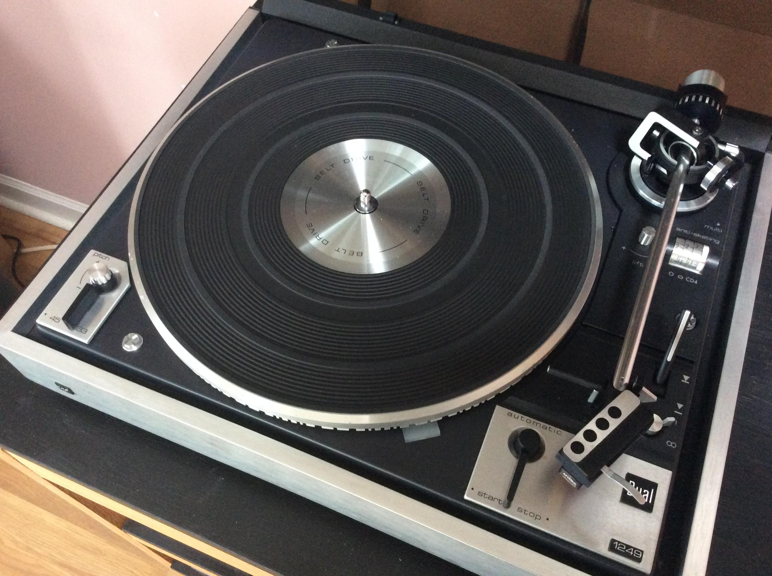

After having rescued a few turntables, mostly direct drive models including Dual 721 and 1229 idler and passing them on to fund the hobby, I ran across a pristine looking Dual 1249. It didn’t power up, and after replacing the burst start capacitor and cleaning the contact points, I found out about the SM840 motor problem.
The base has a brushed aluminum veneer that is in great condition.
I mounted an AT140LC cartridge and, boy, does this turntable sound good!
Definitely the sweetest sounding turntable I have had since selling my early Linn LP12. Maybe even including the Linn.
The start up speed problem has been reduced dramatically by selecting 45rpm, manually placing the tonearm in position, and prior to lowering the arm, select 33-1/3 rpm. Works over 90% of the time.

I have not installed a new belt. Besides changing the motor to an SM860-1 version, or the stator, I read somewhere that a shorter (tighter) belt may help the startup problem.
However, since I never use the auto start feature, I am quite happy to continue with the startup procedure mentioned above.

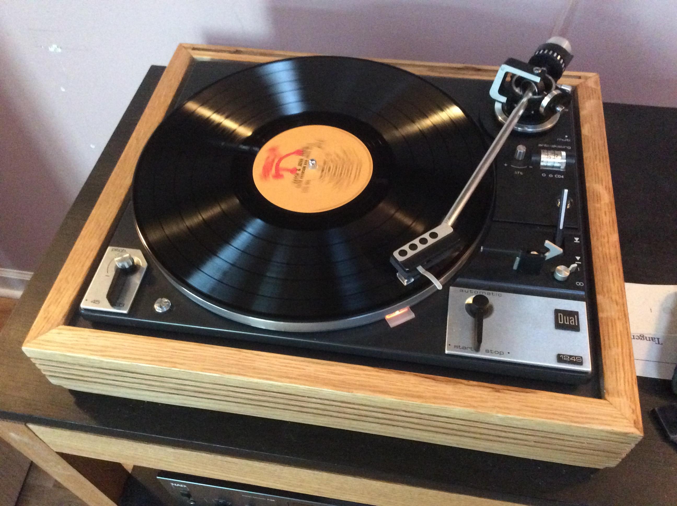

I am in the final throes of refurbishing another 1249 and I’m stumped by, when starting in auto mode, the tonearm moves smoothly(after the usual pause) to the correct position over the lead in section of a 12” record, but just has the tonearm begins to lower, it moves abruptly about 1/2” towards the spindle.
All other functions in auto and manual work perfectly. A new steuerpimpel has been fitted.
Anyone had a similar problem or knows where to look?

Hello Kay...thanks for the response.
Yes, the textured surface of the main lever is clean. The steuerpimpel I used is quite a soft rubber. Maybe I will fabricate one from a little stiffer material such as the white core of coax cable.
When the tonearm makes the final 1/2” movement toward the spindle, it is very abrupt. Certainly not a slow sliding motion.
Peter
Hi peter,
that's exactly how I do my steuerpimpels 😀! I cut 4 millimeters of the core isolation, so I have a cylinder of 4 mm diameter and 4 mm length. Then I drill 2 mm deep into the center, using a 2 mm bit. That's all, and these pimpels work perfectly!
